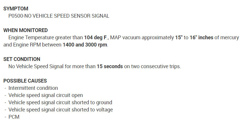

Speedometer not working, code PO500
2002 JEEP LIBERTY
150,000 MILES • 3.7L • 6 CYL • 4WD • AUTOMATIC
DAVID JOHNSON2
Have replaced the rear differential speed sensor and tested the wires. Both are good, but the problems remain. Any suggestions?
Sep 13, 2020 at 1:34 AM
DANNY L
  • 5,648 POSTS
Hello, I'm Danny.

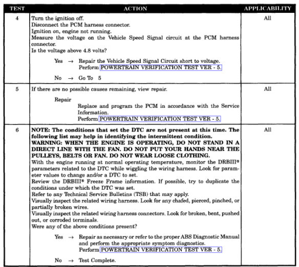

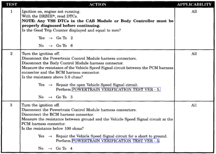

I've attached diagnostic picture steps below for the code P0500 you provided from your vehicle.Hope this helps and keep us updated to your progress.Hope this helps and thanks for using 2CarPros.
