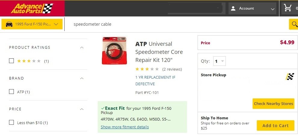

Everything on the dash works but my speedometer and my odometer. checked fuses, good. replaced ABS sensor, checked for unplugged wires, good. What am I missing?

Sounds like your speedometer cable core is broken or has come loose at one end or the other?
Hopefully the speedometer gearing at the transmission is not stripped.
Take it loose and see if the inner cable/core is broken.
If it is, check out the inexpensive fix in my picture below.
Return with news!
