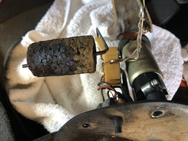

Okay, so checked the sender and cleaned it funny thing though there is a cork for the float like a wine cork. Is that even normal? Okay, so here’s the stupid question, how do I ground that wire?

Cork? Can you send a video/picture you can upload it here. This could be the problem.

I’ll try and take it back out but this is what it looked like attachéd to the float lever.

lol, that's a good one. I would replace the sender but while it is out connect the wiring and turn the key on and move the float up and down to see if the gauge moves. please let me know.

Below is the photo of the cork float. Okay, so tested the sender while out of the tank. Gas gauge slowly climbed. We replaced the cork float with another float and reinstalled pump back into tank. The gas gauge continued to climb to full which is where the gas tank is currently. Then the gas gauge dropped to empty.

It sounds like the sender is bad, can you ground the sensor wire and have it go to full, then unplug the sender and it should go to empty. Let me know.
