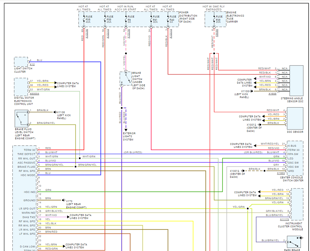

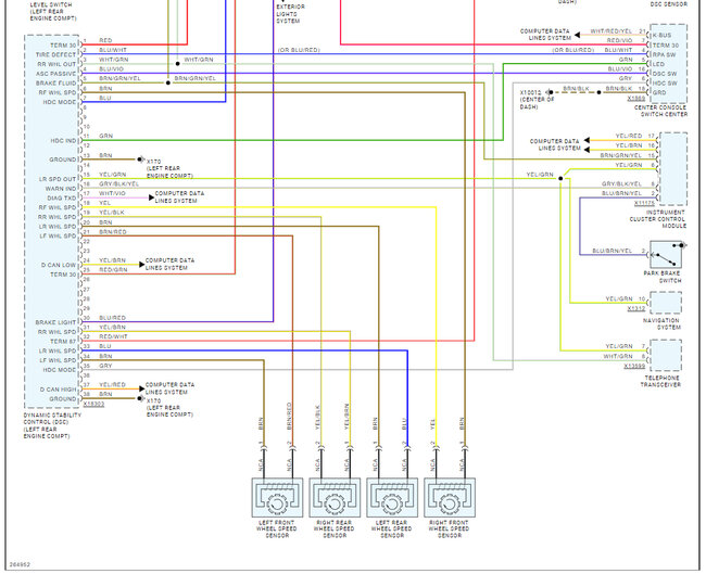

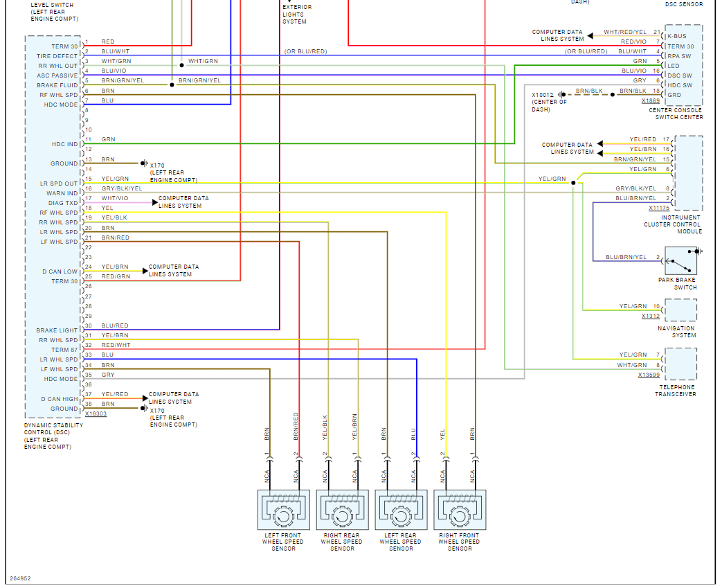

There is no VSS sensor on this car, the speedometer gets its data from the ABS system which processes each of the ABS wheel speed sensors so if one of them is not working (left rear) it will affect the speedometer operation. Please see the ABS system wiring diagrams so you can see what I am talking about. You also can rerun the odes to confirm which sensor is having the issue.
You can get a CAN scanner (Controller Area Network) which will work on most cars from Amazon.
