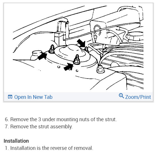

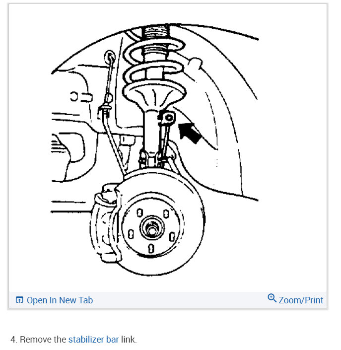

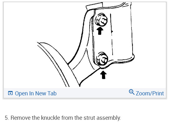

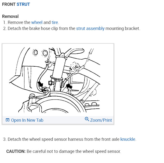

I am posting images with the numbers 1-4 at the end of the file name for order reference for you on how to remove your front struts. I certainly prefer a visual reference! But here is just the steps for removing and reinstalling the front struts on your Santa Fe.

1. Remove the wheel and tire.
2. Detach the brake hose clip from the strut assembly mounting bracket.
3. Detach the wheel speed sensor harness from the front axle knuckle.
CAUTION: Be careful not to damage the wheel speed sensor.
4. Remove the stabilizer bar link.
5. Remove the knuckle from the strut assembly.
6. Remove the 3 under mounting nuts of the strut.
7. Remove the strut assembly.

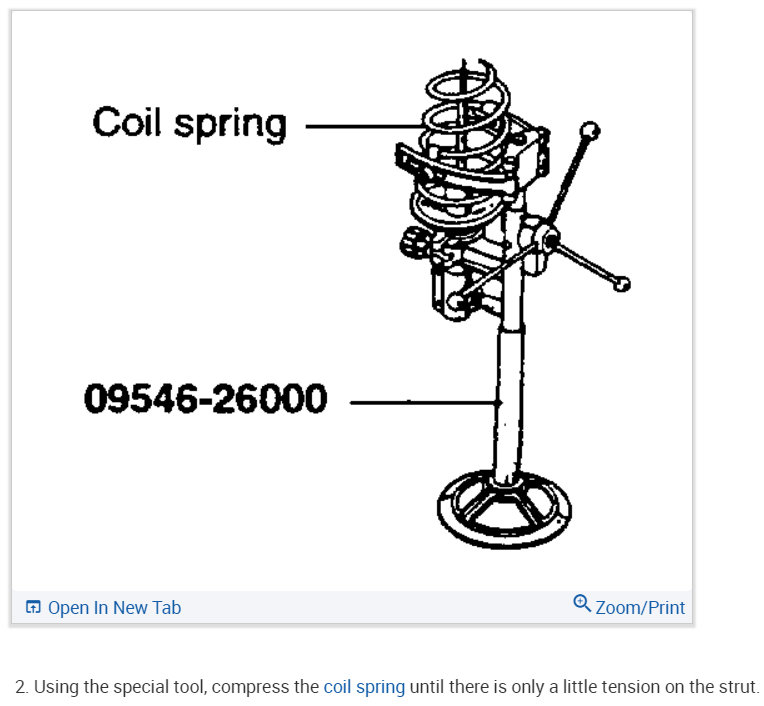

Now, the most dangerous part of replacing struts, if you aren't getting quick struts that come ready to be installed in your vehicle, is compressing the spring. Please take this part very seriously! I have included a picture of a strut spring compressor that Hyundai recommends using. Some people choose to use a spring compression tool that consists of two independent bolts and you tighten down to compress each side a little at a time to get even compression. You must watch for the rods slipping around the spring as it will cause uneven compression and likely injury. These are very dangerous and are commonly referred to as widow makers, so please use the utmost caution if you choose to use them.
