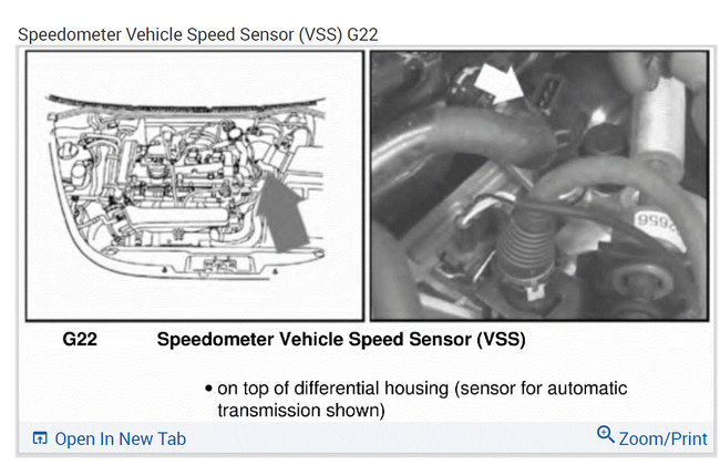

I have the car listed above GLS model with a 6 speed automatic with 09G tiptronic transmission. The speedometer is bouncing all over the place. Cruise control, fuel and odometer all work. No DTC codes. All I have read online states VSS (G22) sensor issue. I can’t find the sensor and was told by the dealership, who looked my vehicle up by the VIN stated I don’t have a G22 sensor. I’m now stumped as to what may be the issue. Please help.

I'm showing one in the manual. Take a look at the attached picture and let me know if this is where you checked. Check out the diagrams (Below). Please let us know if you need anything else to get the problem fixed.
