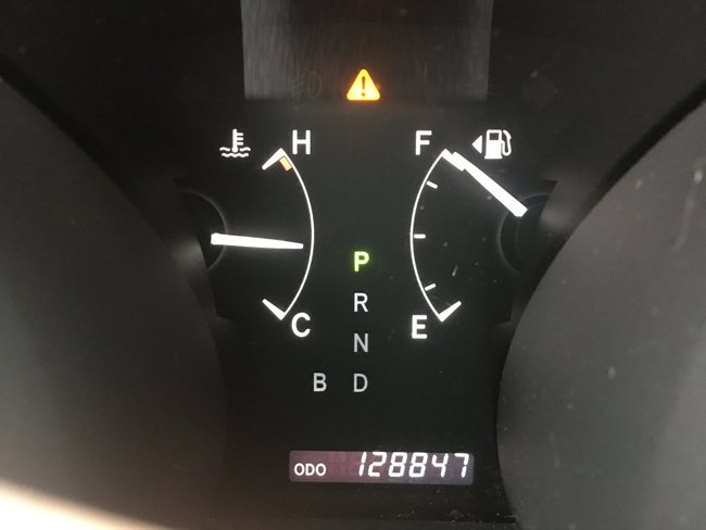

Vehicle listed above is the limited model. Sometimes when driving the speedometer drops to zero for a few seconds and all warning lights come on dash (check hybrid system, check brake system and check 4wd system). If you turn engine off and back on, only check hybrid system will stay on. If you check with an OBDII code reader, there are no error codes. If you clear codes with OBDII code reader, the check hybrid system message will go away. This has happened multiple times. Sometimes after driving 500 miles, sometimes after only 1 mile. Took to Toyota dealer and they cannot find anything wrong. Replaced; battery, checked battery cables, checked all fuses and checked electrical plugs that i could find. Nothing wrong, but i have to keep erasing error messages that are not real. About to lose my mind…

Okay. Sorry but this doesn't make sense so I understand your frustration. If the lights are on but there are no codes, why does clearing codes (that are not there) make the lights go out, only to come back on?

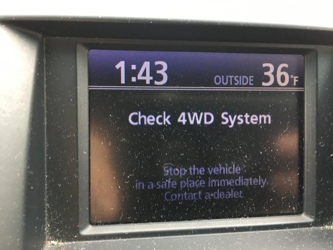

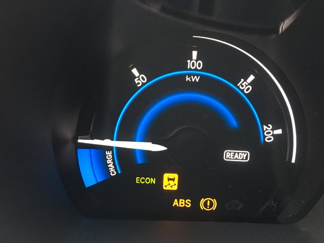

Next time the lights are on, can you get a picture of the cluster so that we can see what messages and lights are on? Thanks

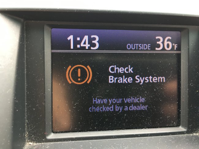

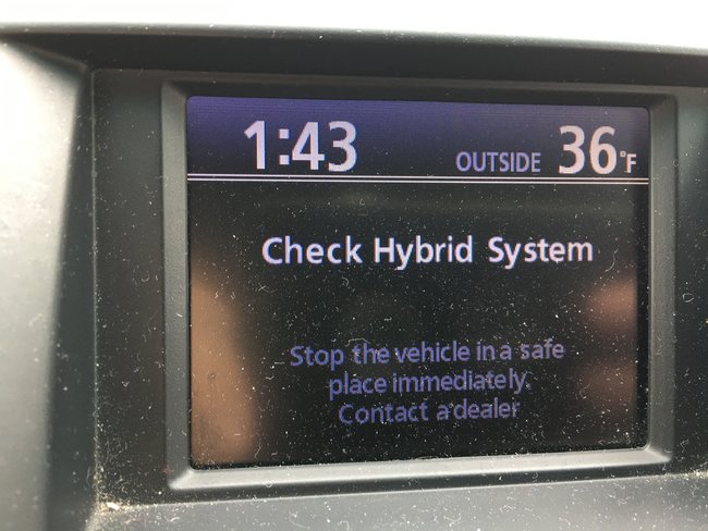

These are pictures of the warning lights and control panel messages, before they are cleared with a code reader, even though the Toyota dealers code reader says that there are no error codes, with the below messages still on the panels.
Jan 23, 2021 at 11:06 AM
Okay. The only thing that makes sense with this is if the 12 volt battery is weak causing these lights to come on. Each of these warning lights is associated with codes so if there are truly no codes then a weak battery would make sense.

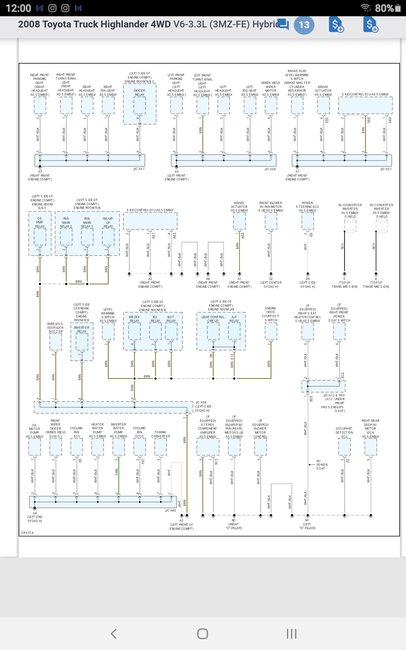

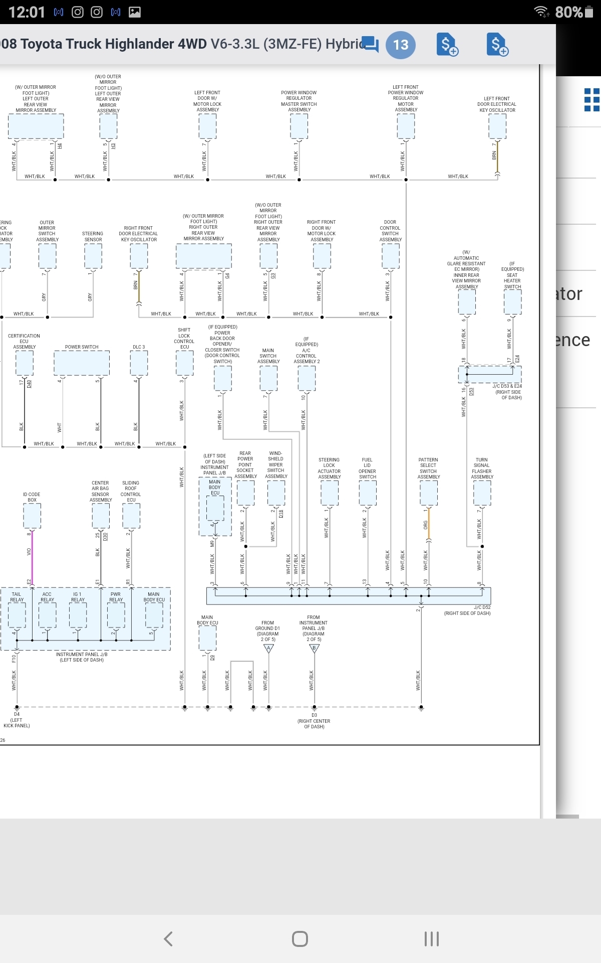

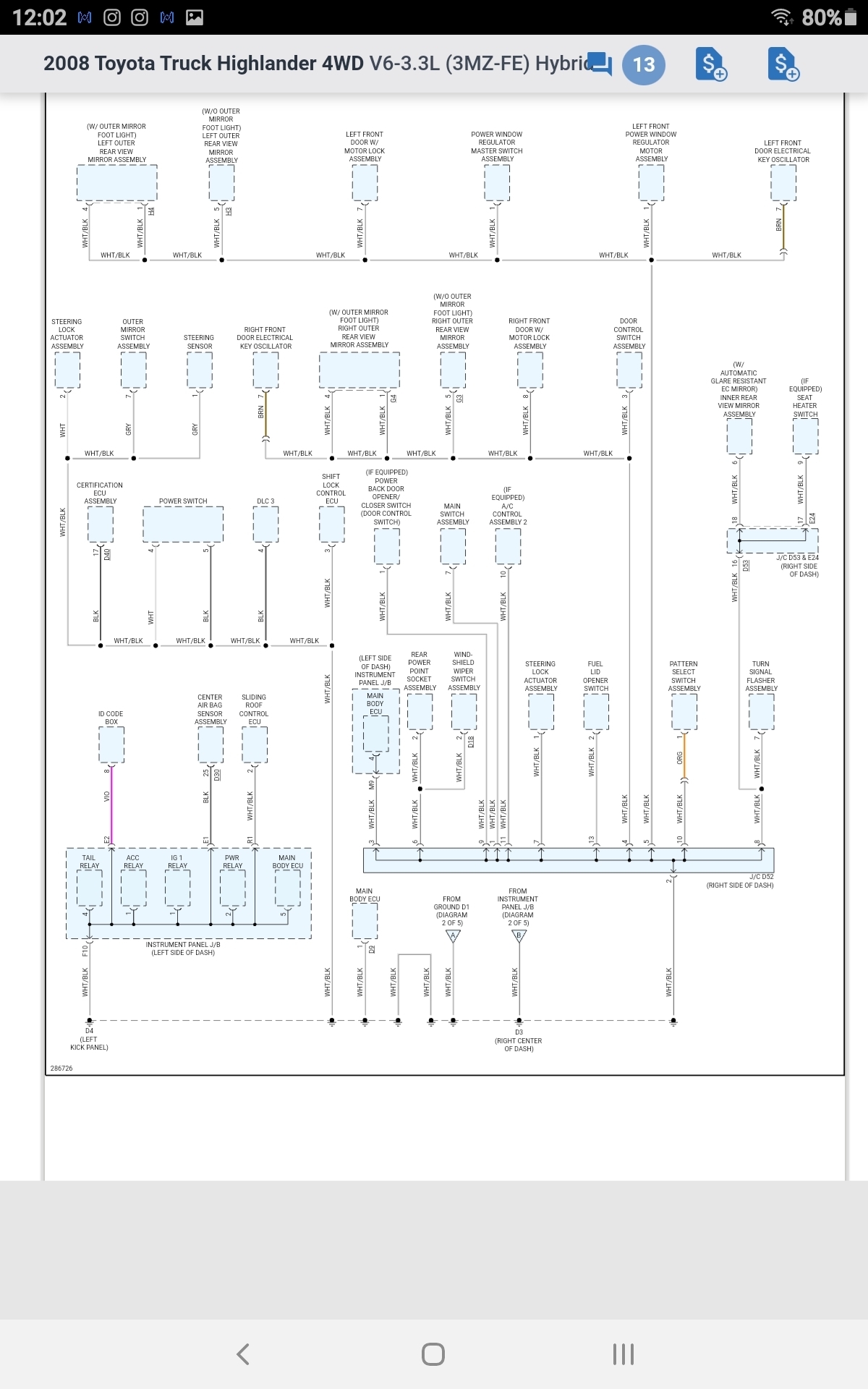

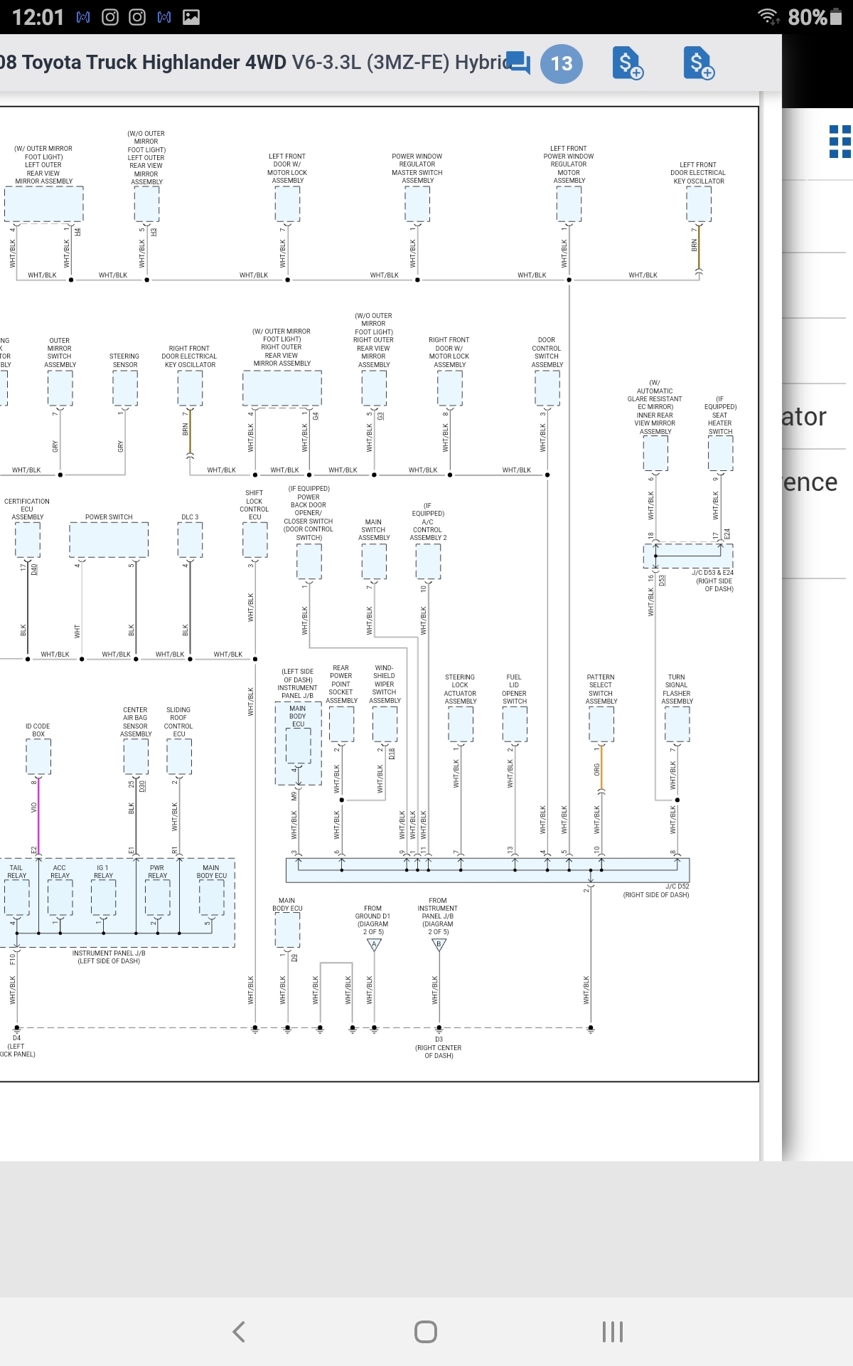

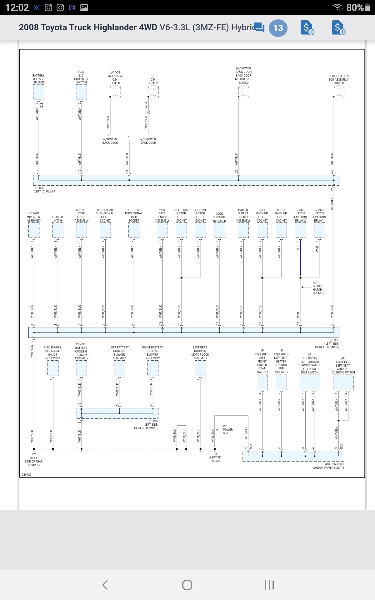

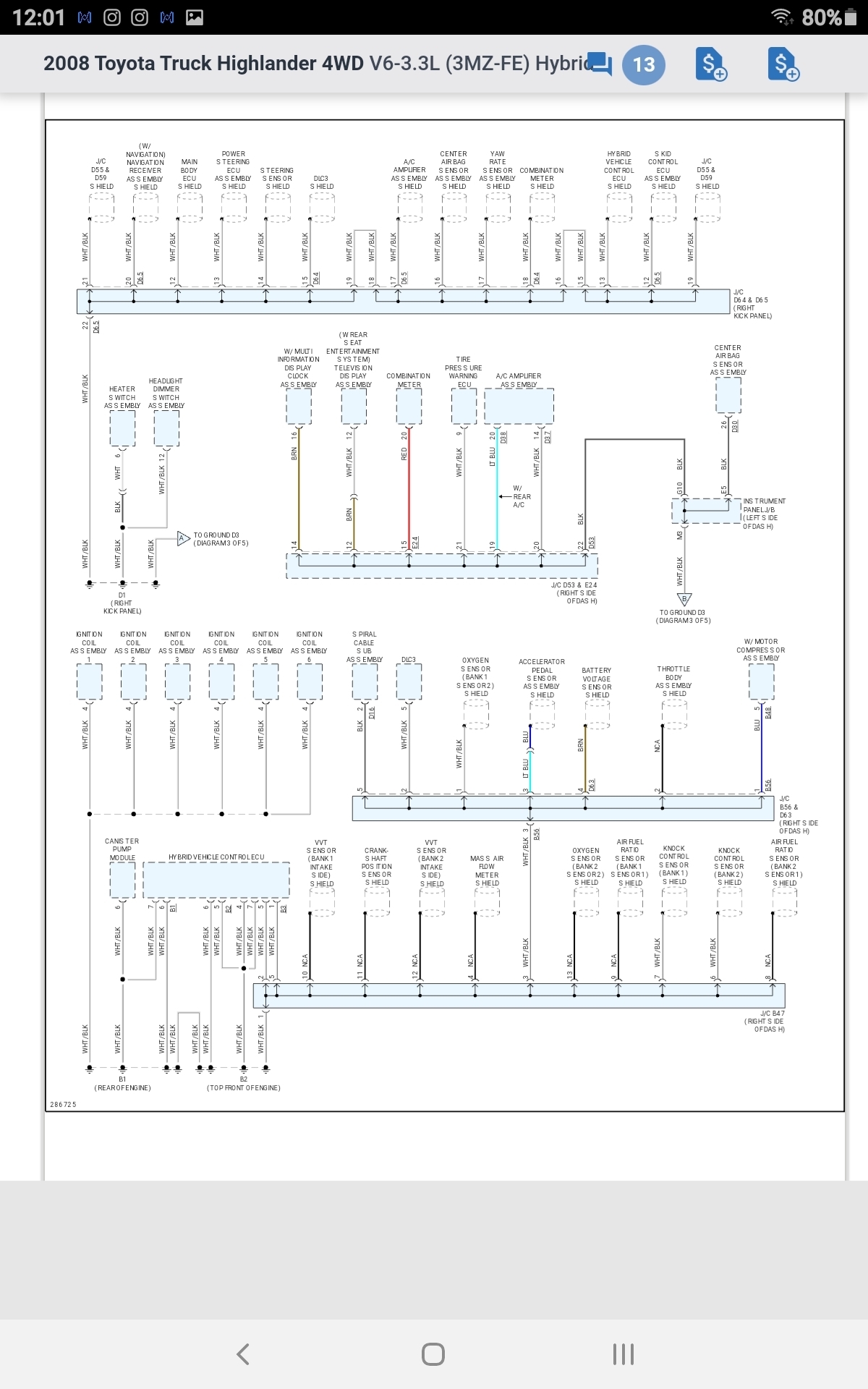

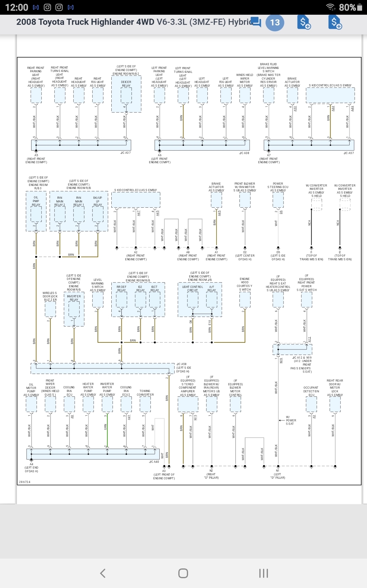

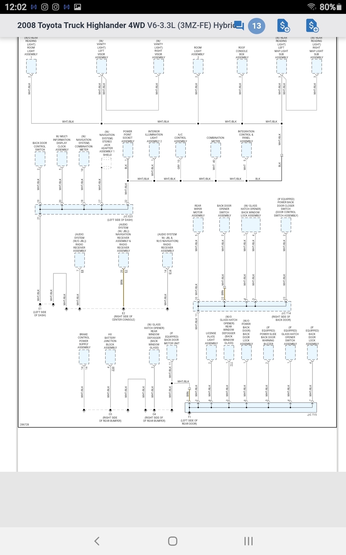

Toyota of Knoxville, said they looked at everything and could not find anything (with lights and messages on dash). I have contacted every hybrid repair shop within 250 miles for any suggestions. Most think that it is an electrical issue after I checked everything (battery, battery cables, plugs, fuses). Best suggestion from a few is that there is a loose ground wire, but they also added "Good Luck Finding It", because there are so many ground wires and I can not find one diagram to even show where to begin looking for them.
Jan 25, 2021 at 11:39 AM
4DRTOM
  • 467 POSTS

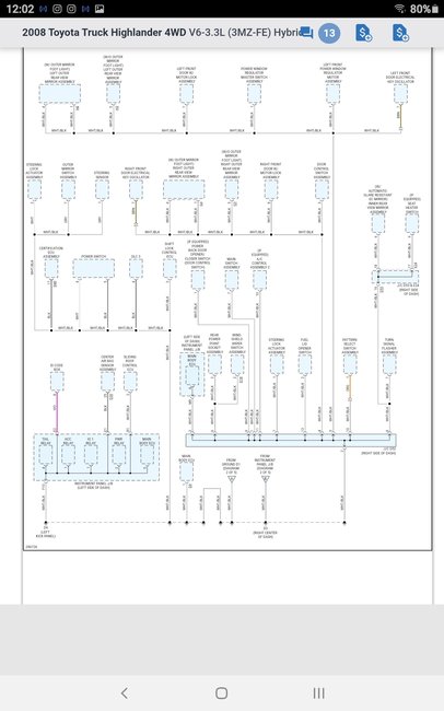

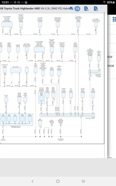

I'm Tom and went through this a little. I've attached all the diagrams for your grounds. Maybe you will find a bad one, a wet area or something just not right when you look. Can you recall the very first time this happened? Was there anything out of the ordinary, spilled coffee, driving down a bumpy road, Snow storm, lent the car to someone, a jump start? Anything at all. Think back to that very first day and the few days before and let me know if you can recall anything.
Tom
Jan 25, 2021 at 4:09 PM
KIRT K. PARKER
  • 10 POSTS
Thanks for the diagrams...This will really help me locating all the ground wires. As far as what happened when this problem first showed up, I was sitting at a red light for about 60 seconds on a beautiful sunny day and it was about 36 degrees F, absolutely nothing was going on inside or outside the vehicle. I had just drove from home about 15 miles before I got to the red light. :(

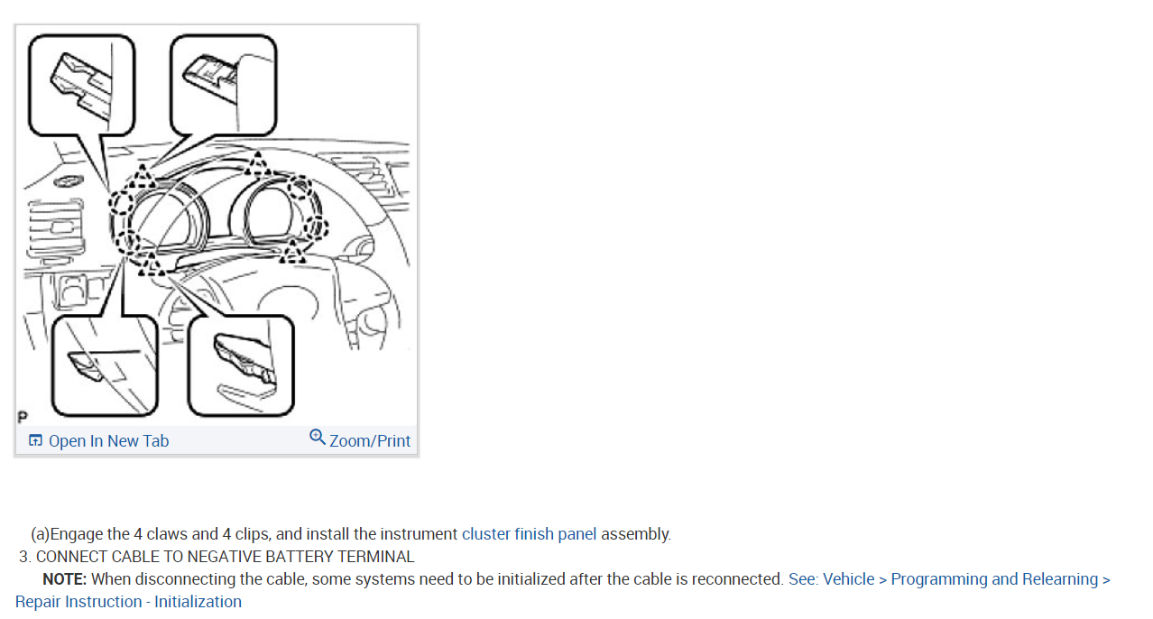

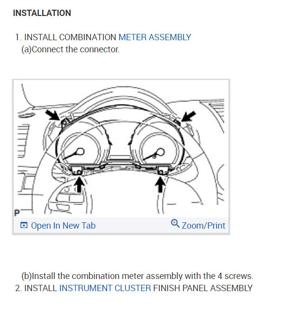

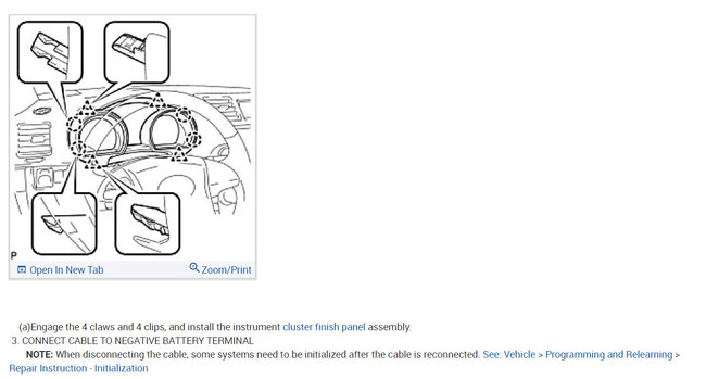

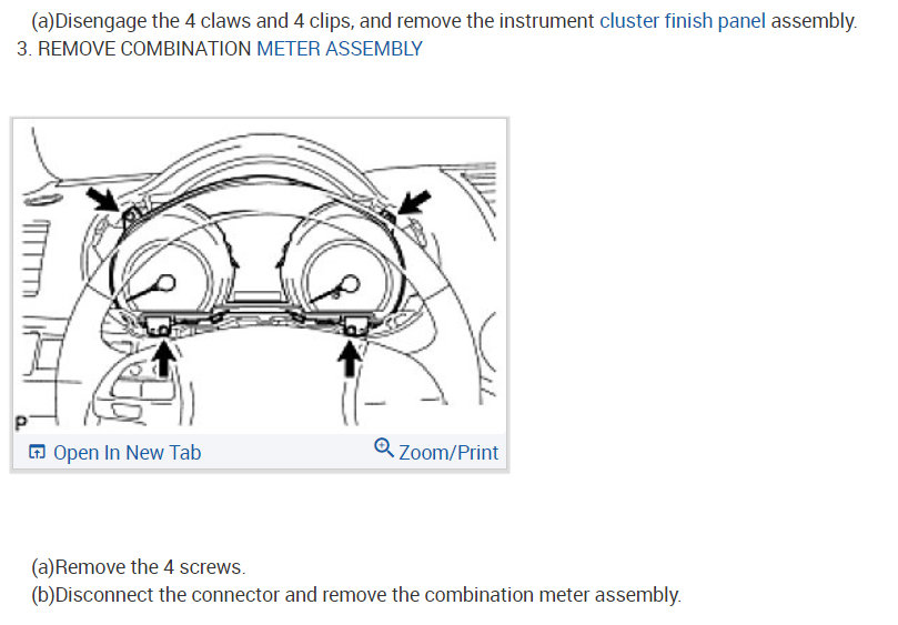

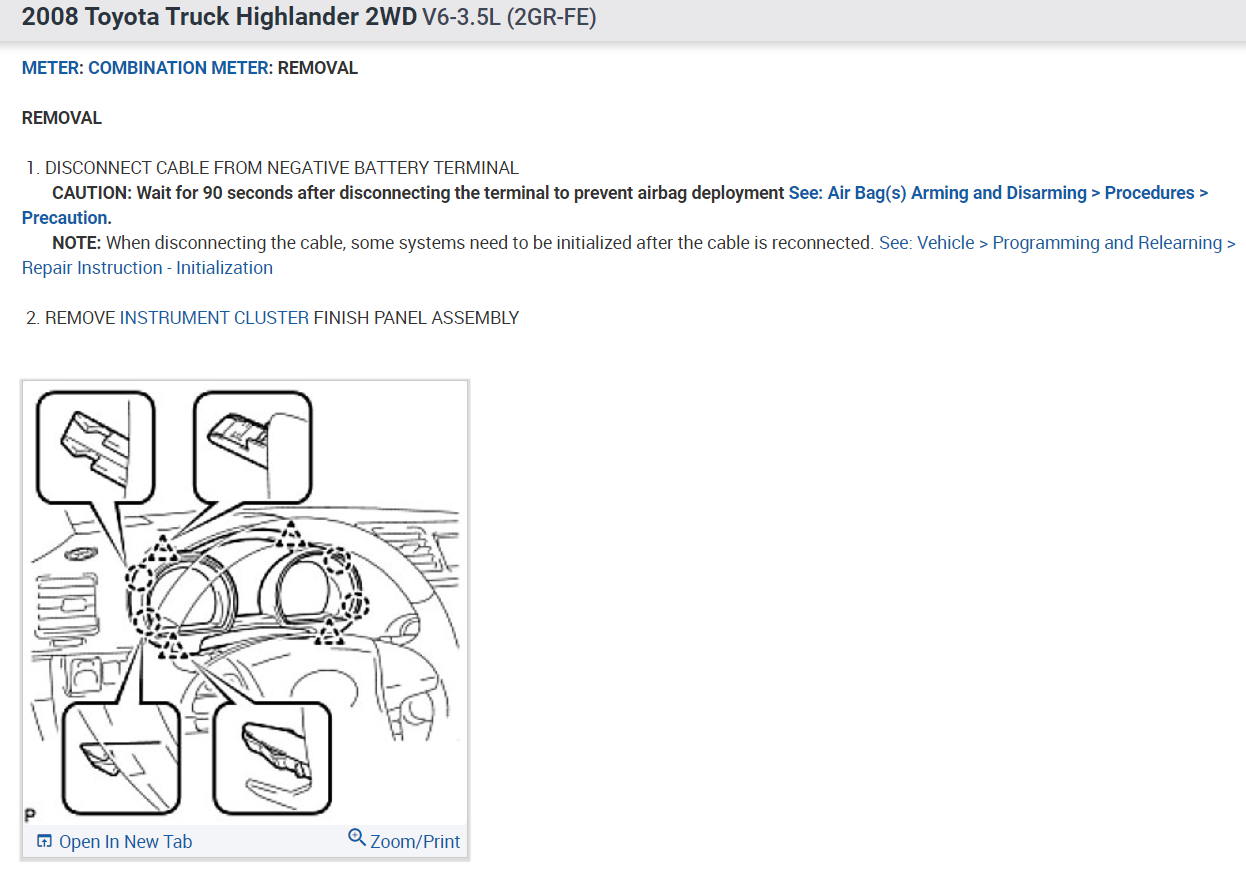

With no codes I would say the cluster needs to be replaced. here are the instructions. You will need to get a used unit or rebuilt from a place like AER in California. Check out the diagrams (below). Please let us know what happens.
