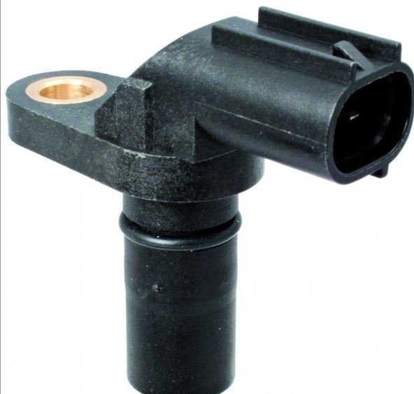

Both of the sensors are on the side of the transmission toward the top of the case about halfway back. The SP2 is the one monitored but they are both the same part number.
Bolt is torqued to 48 inch pounds. They are a simple coil sensor so just measuring them both with an ohmmeter should tell yo if one has failed. I would look close at the connector as it is easy for water to get in and corrode the pins.

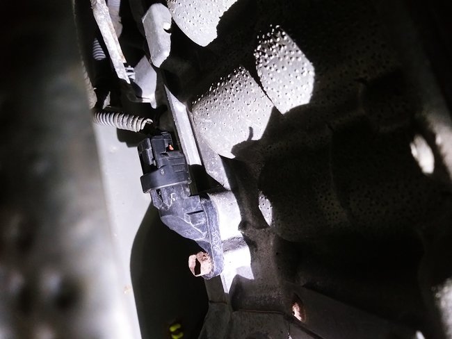

MWILSING
  • 36 POSTS
Drivers side correct ?
Jan 27, 2020 at 3:04 PM

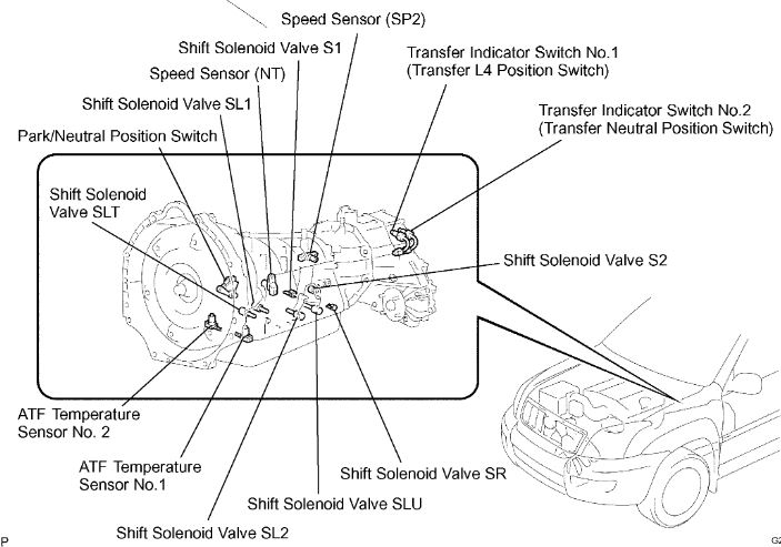

MWILSING
  • 36 POSTS

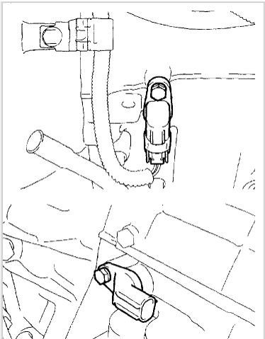

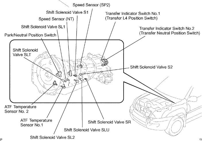

Having a hard time finding the sp2 sensor. Added a photo of similar tranny. Is it more top towards shifter lever ?
Jan 27, 2020 at 3:33 PM
STEVE W.
  • 15,295 POSTS

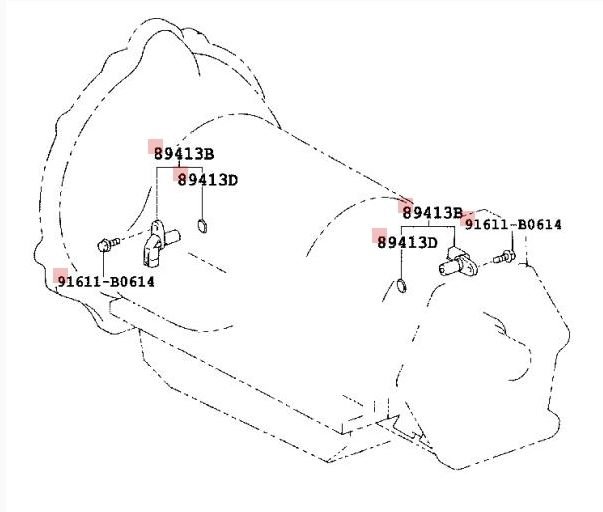

You may have the later version that has one on each side. There will be one to the front drivers side that measures the input shaft speed and one toward the rear passengers side that reads the output shaft speed if it is the later transmission. The second one is the problem on your vehicle.
Jan 27, 2020 at 6:48 PM
MWILSING
  • 36 POSTS
That's what i saw when i was under the vehicle. So in this case it is still same part number for both? Will dig into it again after work. Thank you..
Jan 28, 2020 at 12:57 AM
STEVE W.
  • 15,295 POSTS
That's what they show, Part # 8941332010 supersedes to #8941332011

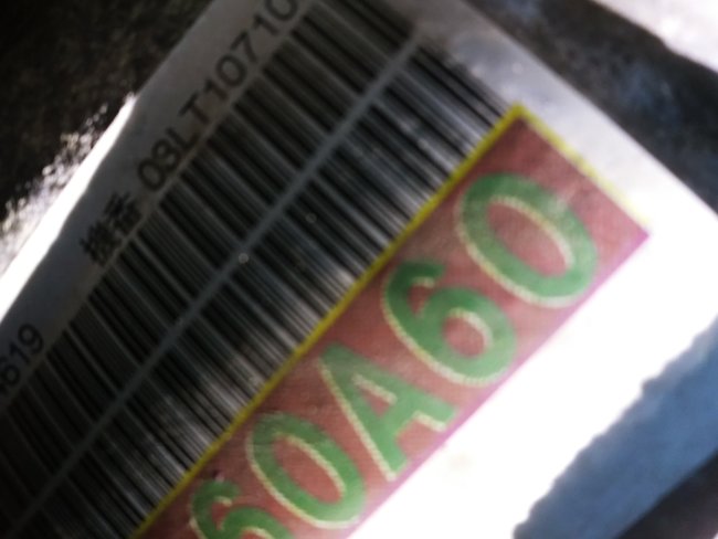

35000-60A60 is number on sticker on transmission from what i can read. Also i would assume this is the culprit on passenger side ?
Jan 28, 2020 at 2:09 AM
STEVE W.
  • 15,295 POSTS
Yeah, that is one of the reasons I don't tell people to try to clear codes that way. You are lucky, some of the newer Toyota and Lexus cars will lock you out if the battery is disconnected, the immobilizer trips and you need a dealer code and tool to reset it.
That is the part. The passenger side is the one that is your issue. I would check the wiring from the sensor up as the way it is acting is a bad harness. There are a few numbers depending on which of the brands you search under.

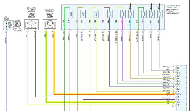

should i get any readings at the connector at the sensor? key on/ key off ?
Jan 28, 2020 at 2:25 AM
STEVE W.
  • 15,295 POSTS
The green wire is the sensor ground, The red wire is sensor bias voltage. So either 12 or 5 volts on the red wire when referenced to ground with the key on.
Jan 28, 2020 at 2:42 AM
MWILSING
  • 36 POSTS
red was 1 volt. Green i got nothing grounded to frame ..
Jan 28, 2020 at 3:10 AM
MWILSING
  • 36 POSTS
i used a better tester and i checked both leads coming into both sensors. I have 1.2 volts at both and no ground to either. My friend is a Toyota tech so i guess its time to drop it off. May be beyond what i can do unless you have more ideas. Too hard to follow leads from under the truck with very limited space.
