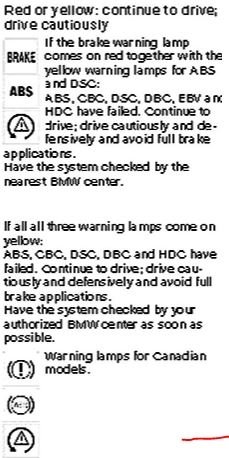

Here is another thing that will help us along. The color the lights are lighting up. I just attached the chart for that.In this system the instrument cluster has a module for the systems that handles all of what you are having trouble with. It's probably the issue, Please get me the codes you got from scanning it to.
But I'm thinking it the integrated instrument cluster module that is your problem. It's the only place all those circuits or systems are run together. I will look for a test for bench testing it or maybe the scanner will pick that up.

The color of the lights is amber. I have to borrow the tablet again to get the codes but I do remember that it stated that neither of the rear sensors actually read (all four wheel sensors have been replaced with new).

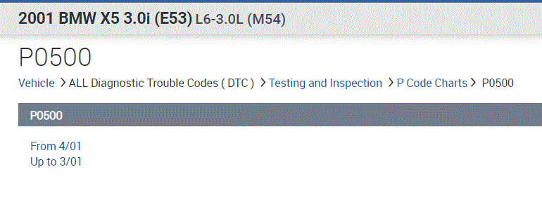

Okay, the codes you provided are mostly engine related, but the one that stands out to me is the 214 which is related to speed sensor A. However, I need to know the build date of your vehicle. See pic 1. Also, note that the code translates to a P0500.

The build date is 09/01.
