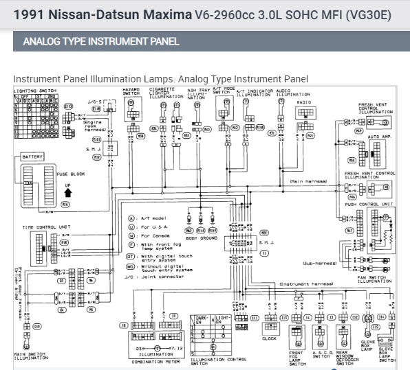

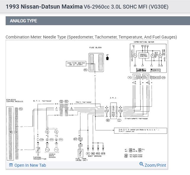

Can a speedometer cluster be used from a 1993 Nissan Maxima on a 1991?
Aug 5, 2022 at 7:01 AM
  • 110,240 POSTS
I tried to find the OEM part numbers to verify if it would work, but because of the model year, they aren't provided. So, I opened the wiring schematics for both.
They are very different as far as wiring. With the information I found, it doesn't appear as though it would work.
I attached the two pics I compared below for your reference.
