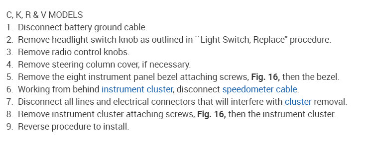

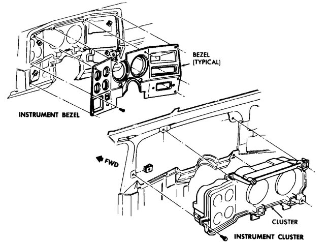

I would use ATF to lube the cable, if this doesn't work, I would take apart the cluster to service the speedo head itself. The following material covers only that service on speedometers which is feasible to perform. Repairs on the units themselves are not included as they require special tools and extreme care when making repairs and adjustments that only an experienced speedometer technician should attempt.

Ken, I pulled both cables our relube with ATF and the bouncing has gone away. thank you for the help. On to my next Item...
