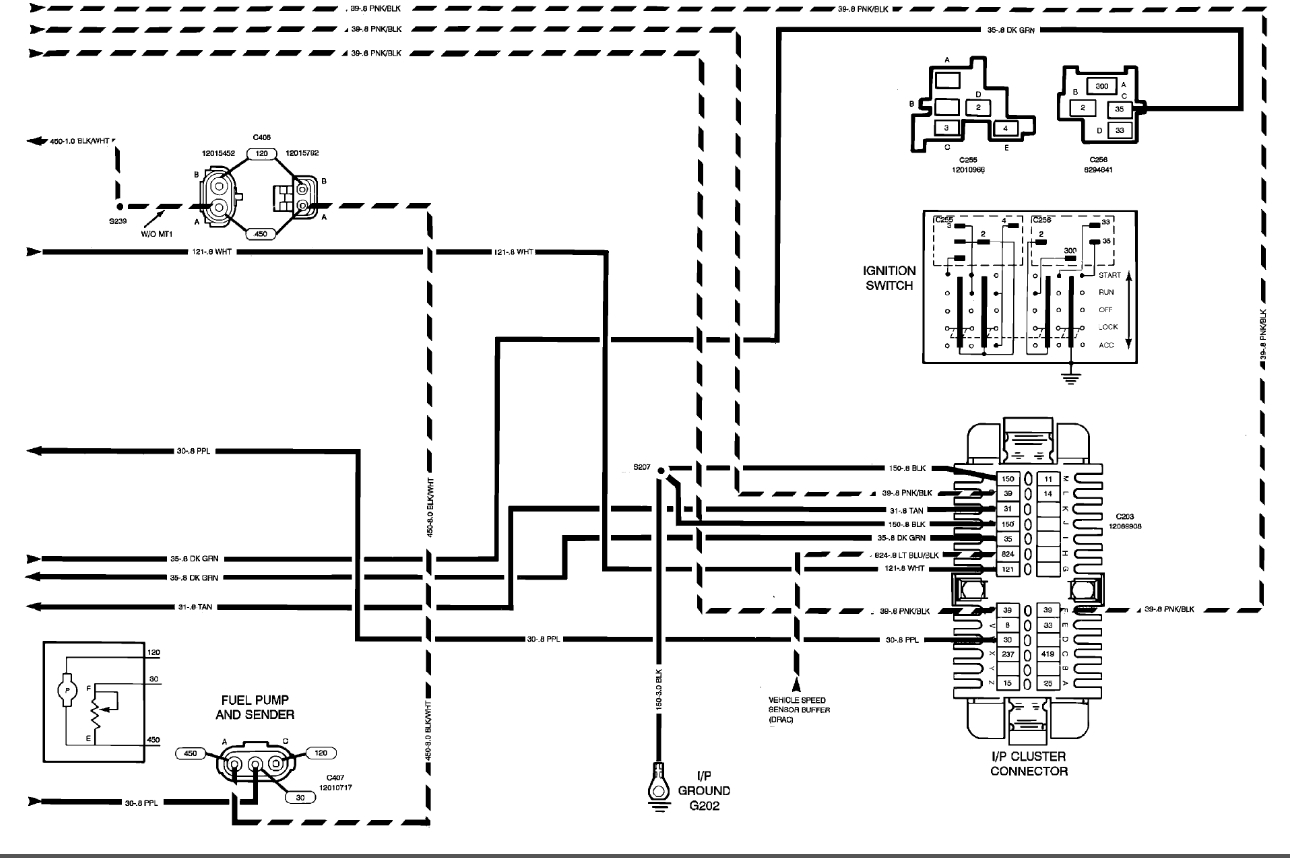

My speedometer gauge bounces up and down periodically and most of the time reads max speed. I’m not sure if this is normal but my rpm gauge seems to be reading a lot higher than it should. How can I fix or diagnose this?

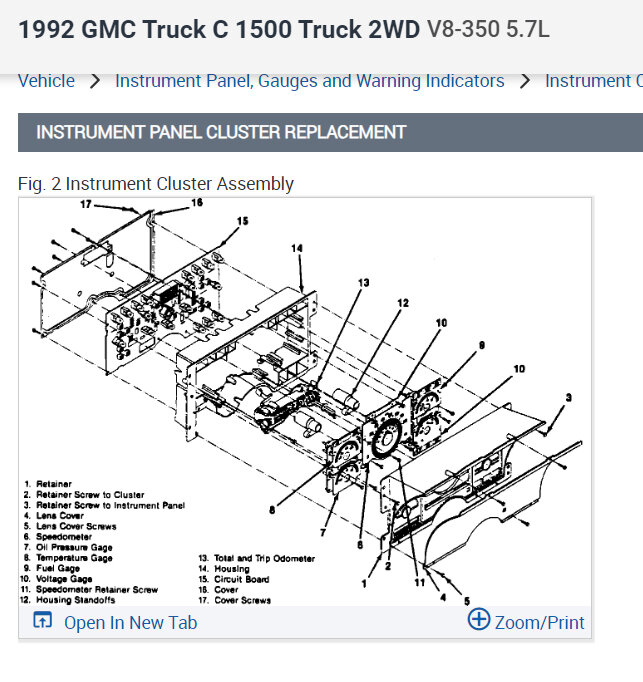

Yep, this goes wrong when the cluster is going out or the system has a bad ground. I would remove the cluster and check the wiring connectors for corrosion. The ground is the black wire which a would test with the cluster disconnected.
This guide can help:
If the ground is good, I would try a rebuilt/used cluster. Check out the images (below). Please let us know what happens.
