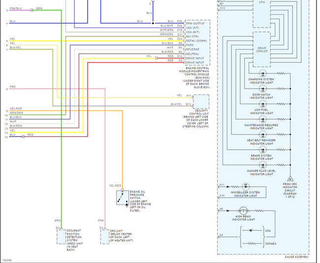

It sounds like you have the incorrect cluster, or the replacement cluster is bad. Can I ask if the wiring has been messed with? Also, I would check the fuses to start, this guide can help:
Also, do you have any codes? This guide can help find out:

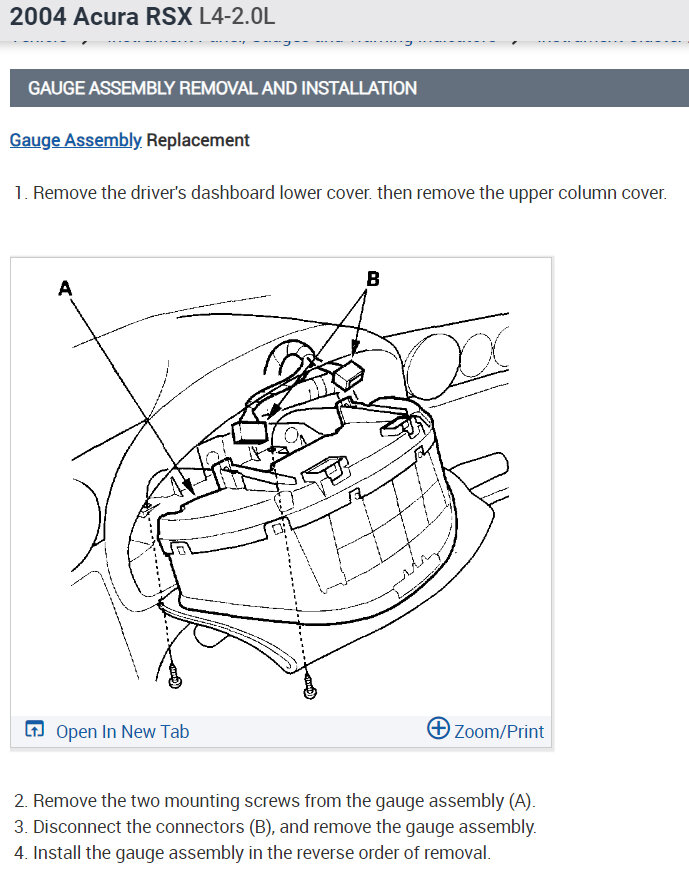

Here are the instructions on how to change the cluster out in case you need them. Check out the images (below). Please upload pictures or videos of the problem so we can see what's going on.
Dec 22, 2023 at 2:57 AM
ITZZJOSEPH
Yes, I think there were 6 codes total 5 being emission codes and one being a p0600. And I believe the wiring has been messed with because there's wires back there that are crimped together. But I checked to make sure all the wires matched, and they do.
Dec 23, 2023 at 8:02 AM
  • 55,688 POSTS

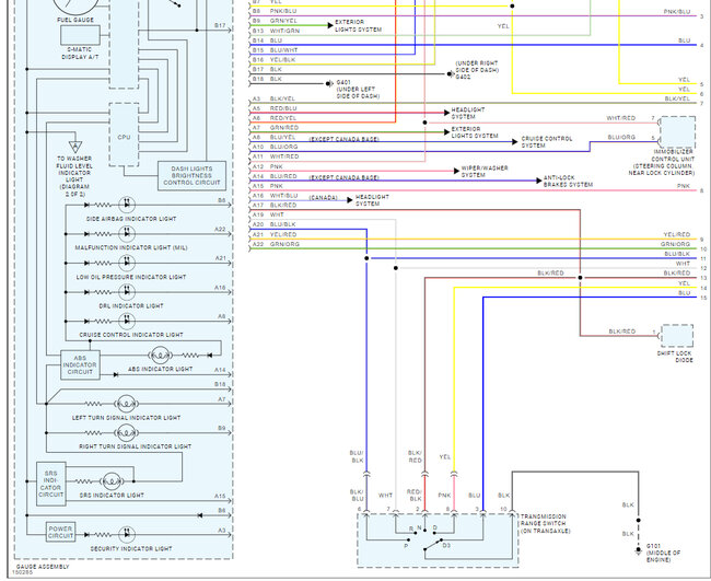

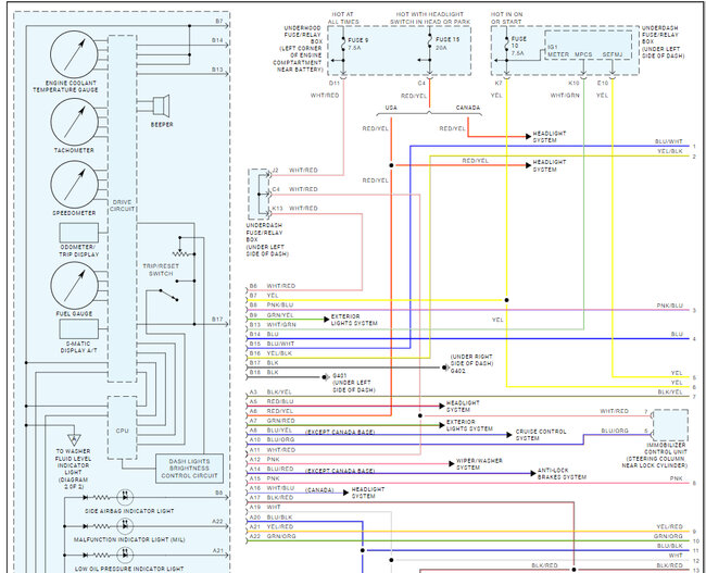

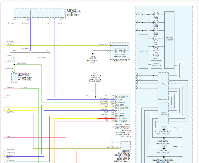

Yep, that will do it, here are the cluster wiring diagrams so you can make sure anything is where it is supposed to be. Check out the images (below). Please upload pictures or videos of the problem so we can see what's going on.
