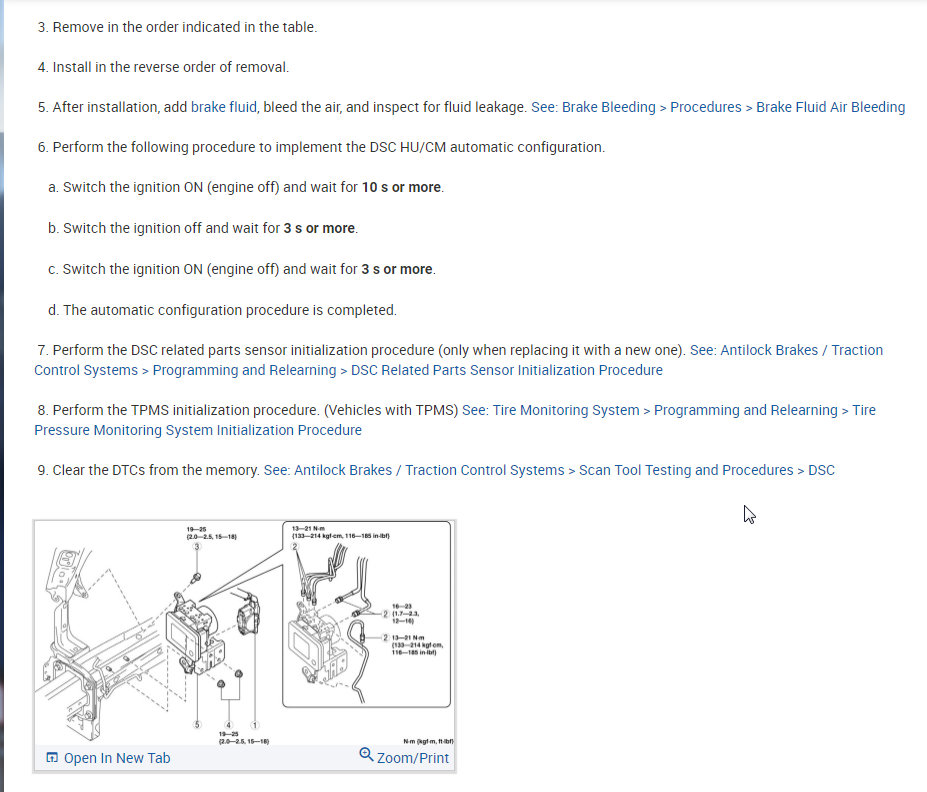

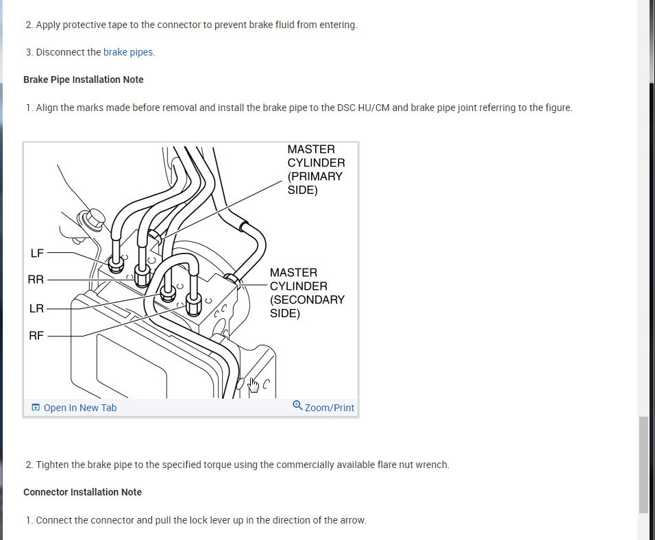

Thanks in advance........do yall know how many speed sensors a 2014 mazda 3 has? I think maybe one has gone bad or the wiring to one of them has gone bad. If there is two or more, would just 1 bad one cause no power steering, no speedo, abs brake engine power steering warning lights? I replaced the battery, didn't help. If it aint wiring or sensor, i guess it has to be abs module right?

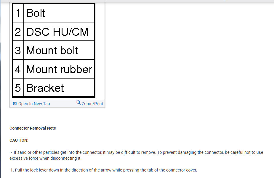

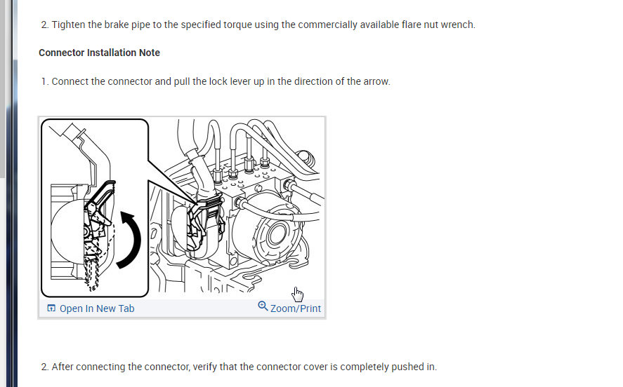

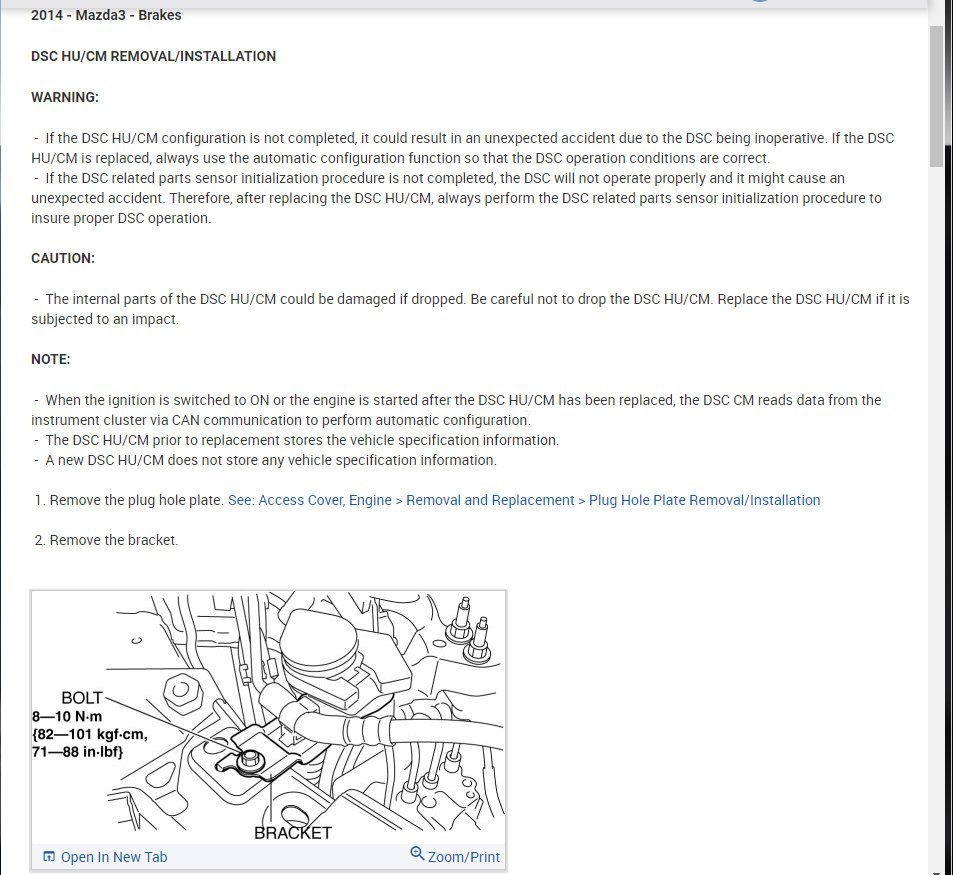

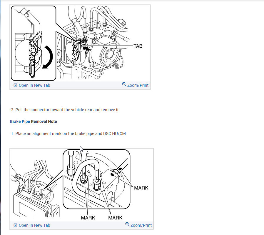

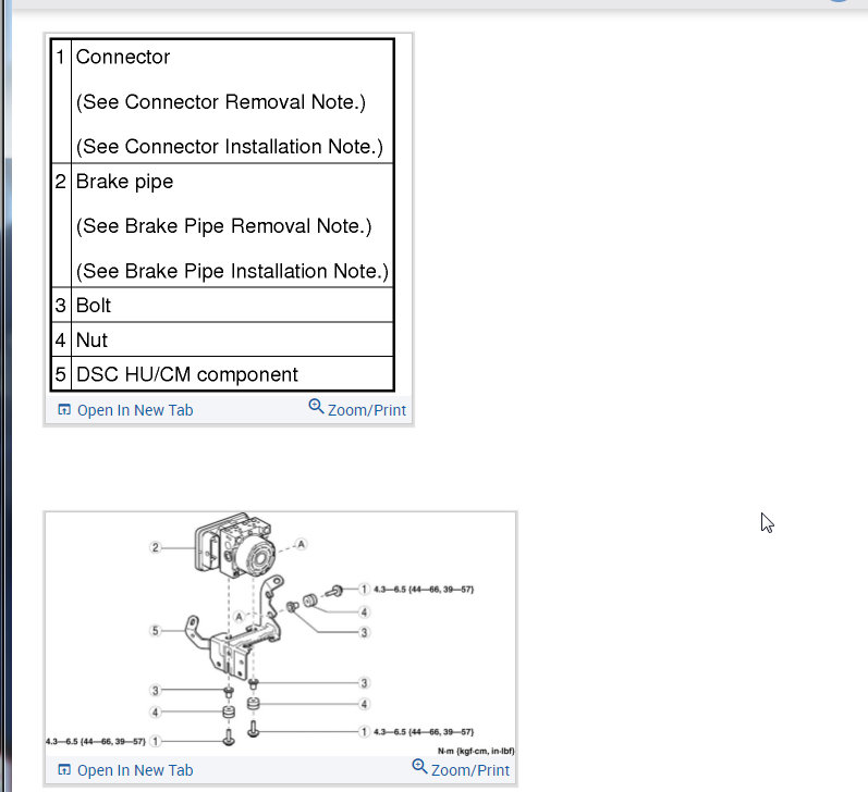

This would most likely be the module as a sensor is wheel speed sensor will not cause all these issues.
I would suggest however, starting with checking for codes. Here is a guide that will help with doing that:
https://www.youtube.com/watch?v=jr_Iv8T_Phk
https://www.youtube.com/watch?v=rTtAnsOlZU4
Once we know the codes we will have a better idea however, I attached below the process on how to replace the module. Let us know what you find and we can go from there. Thanks

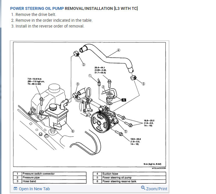

have an 06 mazda3 and last night my power steering malfunction light came on and the it became difficult to steer. i shut the car off and back on and it was back to normal for a few minutes then it restarted.it was raining very hard and the splash guard underneath the engine is off

This is most likely a fluid or pump issue with the power steering system.
Here are a number of guides that will help with this issue:
https://www.2carpros.com/articles/how-to-replace-a-power-steering-pump
https://www.2carpros.com/articles/power-steering-problems
I would suggest starting with flushing the fluid and seeing if this makes a difference. If the fluid is causing this issue then it would make sense that it happens when the fluid gets hot.
https://www.2carpros.com/articles/power-steering-fluid-flush
If not, I would think we need to replace the pump. Below is the info from the manual on how to replace the pump. Let us know what happens. Thanks
