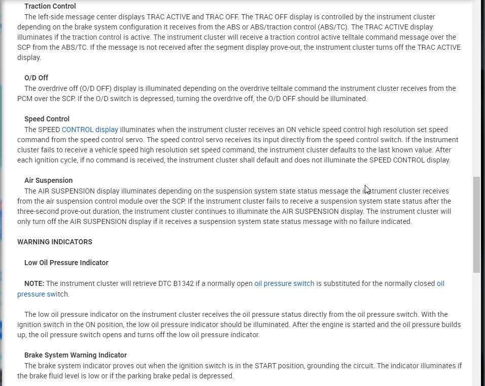

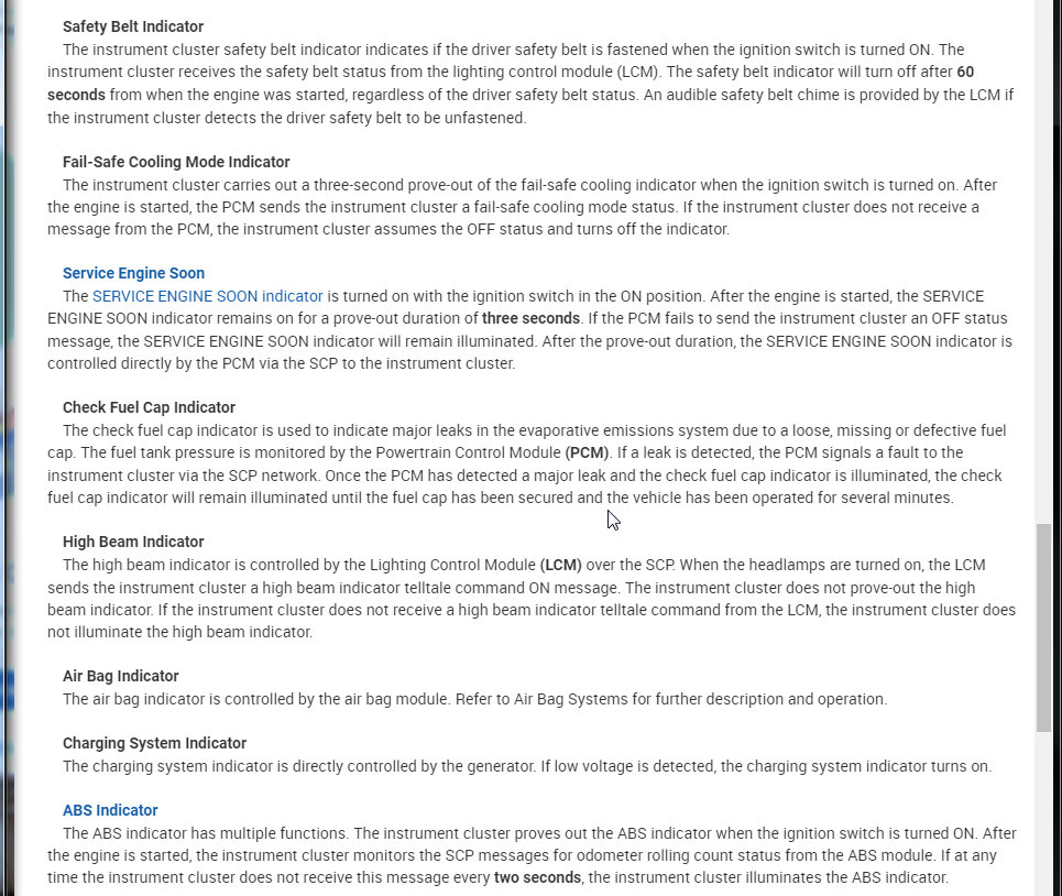

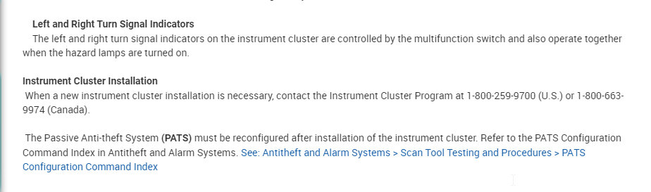

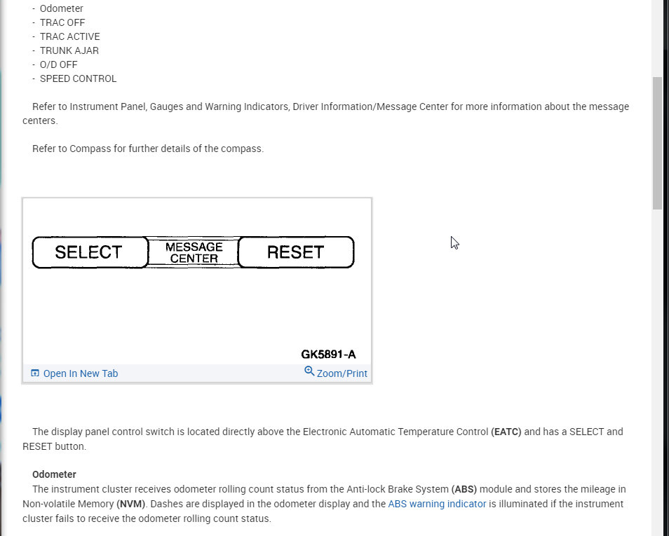

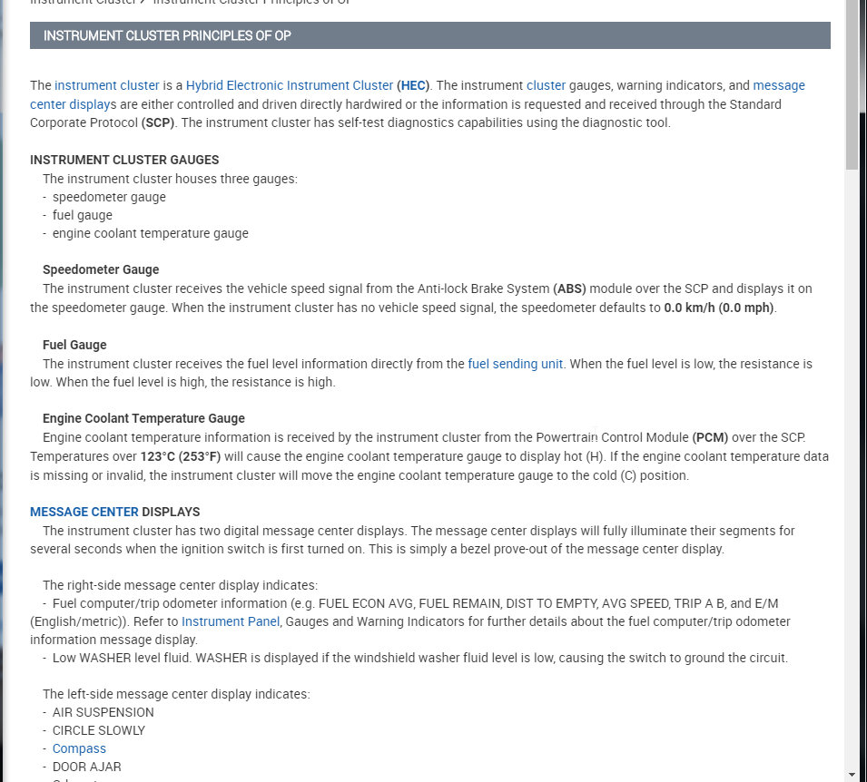

Unfortunately, there is not a reset procedure as this cluster is a module that receives inputs from all the different systems to display the information needed.

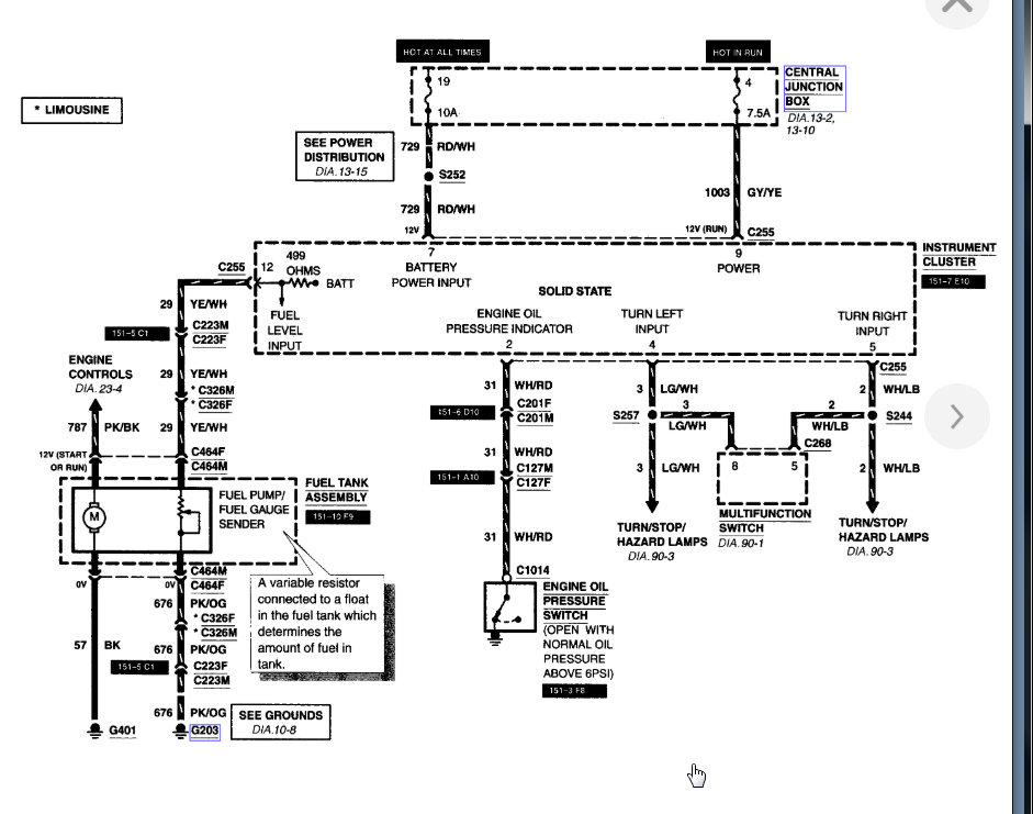

I attached the info about the cluster as it shows that the most common thing that could cause this is the cluster itself has failed. There is a chance that you have a fuse issue so we need to check fuse 4 and 19 in the central junction box. I included the wiring diagram that shows this. Basically this is what gives the cluster power and it sounds like it has either failed or has no power. Let me know if you have questions. Thanks
