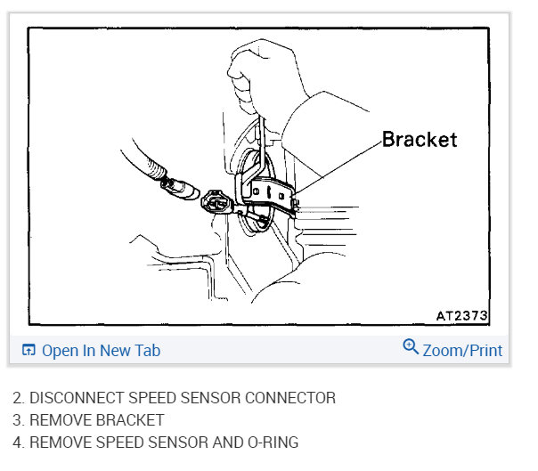

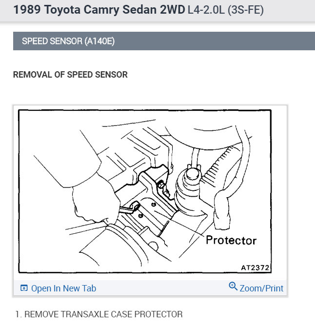

Not working.
Nov 27, 2018 at 2:29 PM
Experienced Mechanic
55,694 POSTS
It sounds like the VSS stopped working. Here are diagrams to help you change the sensor out.
Check out the diagrams (below). Please let us know what you find.
