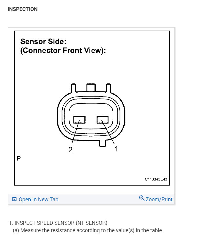

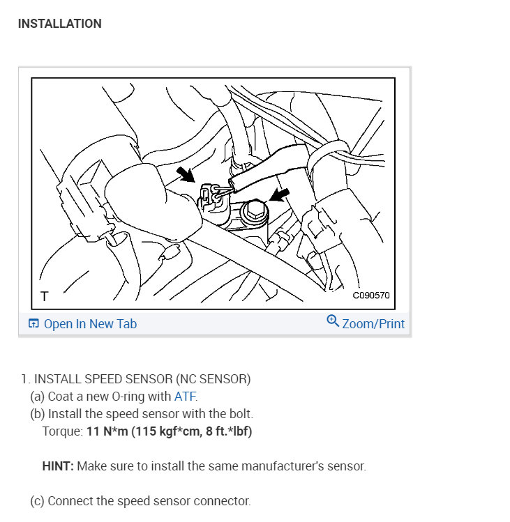

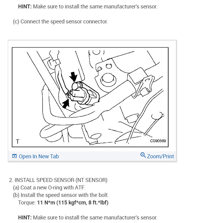

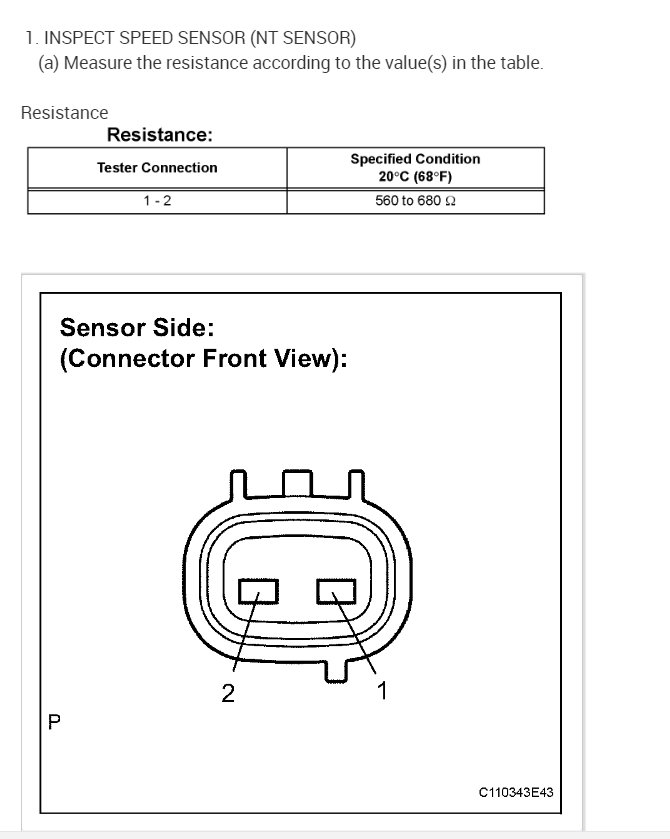

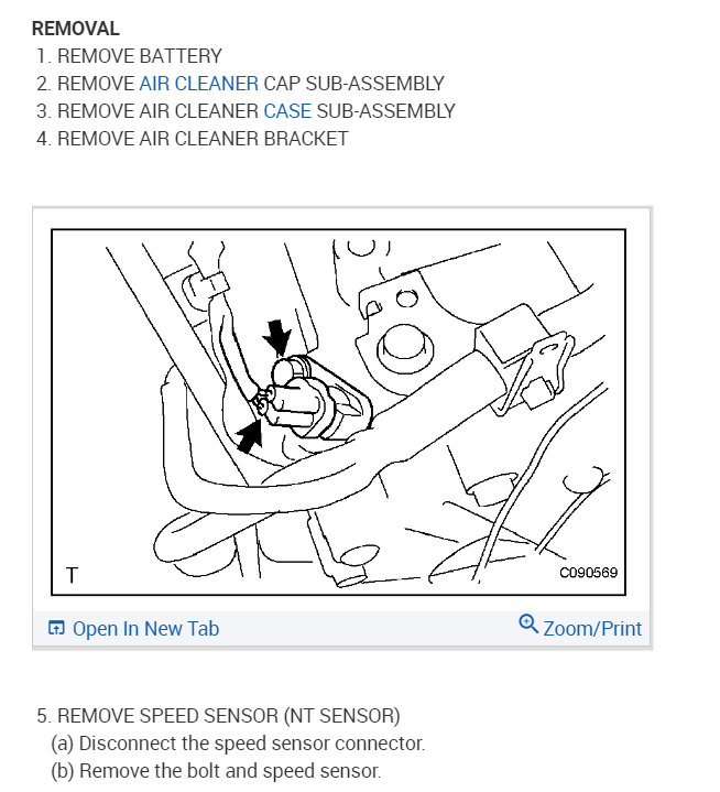

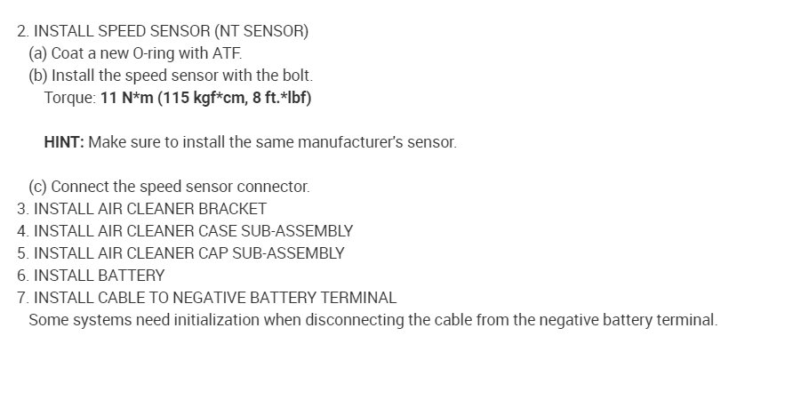

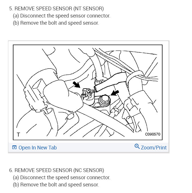

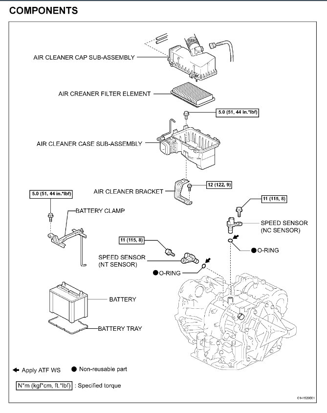

Speedometer not reading?
Sep 9, 2022 at 5:01 AM
  • 55,423 POSTS
This happens when the vehicle speed sensor goes out, here is the location of the sensor in the images below so you can change it out and fix the problem. Check out the images (below). Please let us know what happens.
