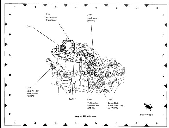

My speedometer does not work. I change VSS, but the needle for the speedometer still on 0. Everything else works fine.
May 20, 2018 at 12:04 AM
  • 110,244 POSTS
Hi and thanks for using 2CarPros.com There are two different speed sensors on this vehicle. There is an output speed sensor and a Turbine shaft speed sensor. The sensor which controls the speedometer is the output speed sensor. I attached a picture for you to confirm the correct one was replaced.
Let me know which one.
