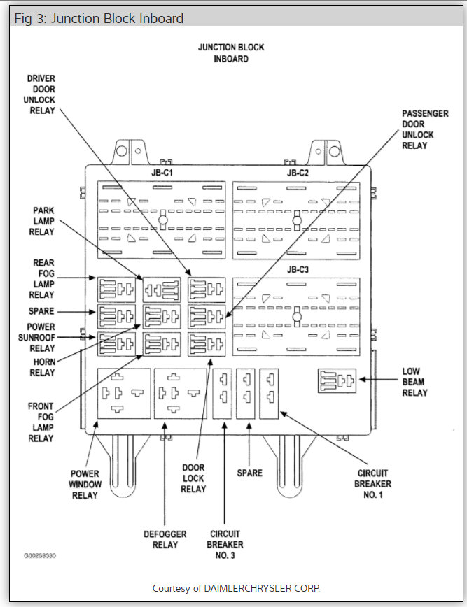

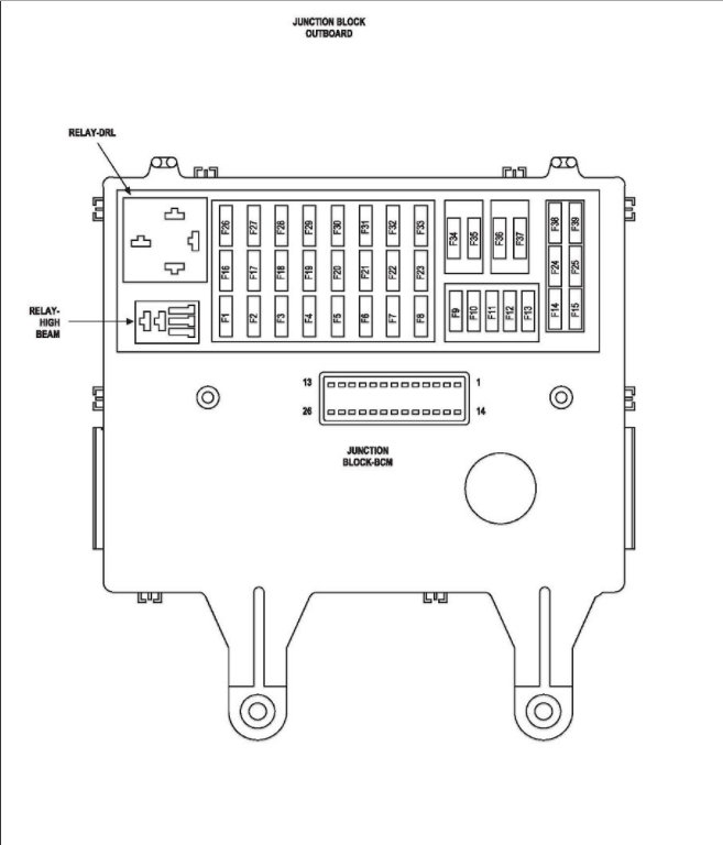

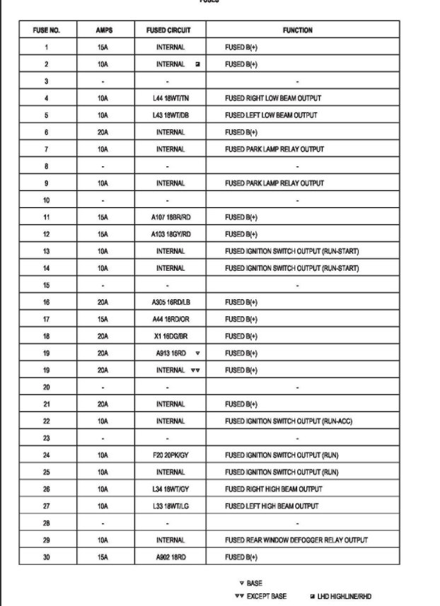

I replaced the sensor in the tail of the transmission but it’s still not working. is there another fuse?
Jan 14, 2020 at 4:02 AM
Experienced Mechanic
55,711 POSTS

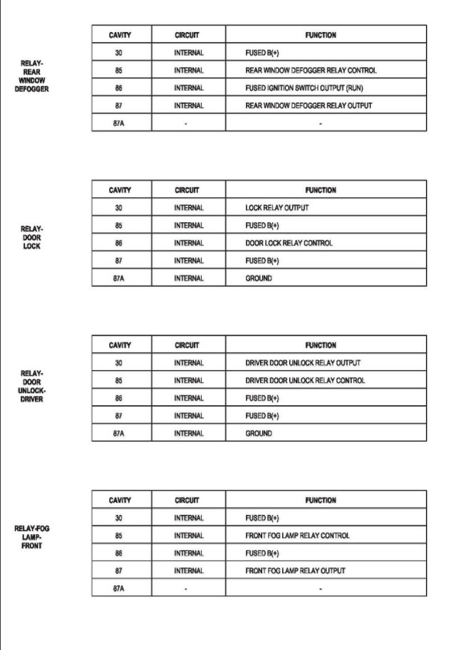

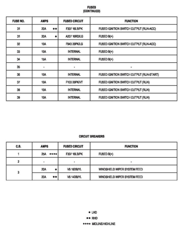

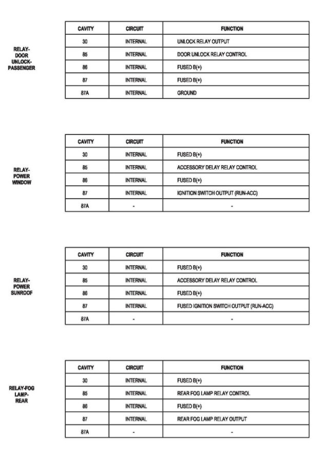

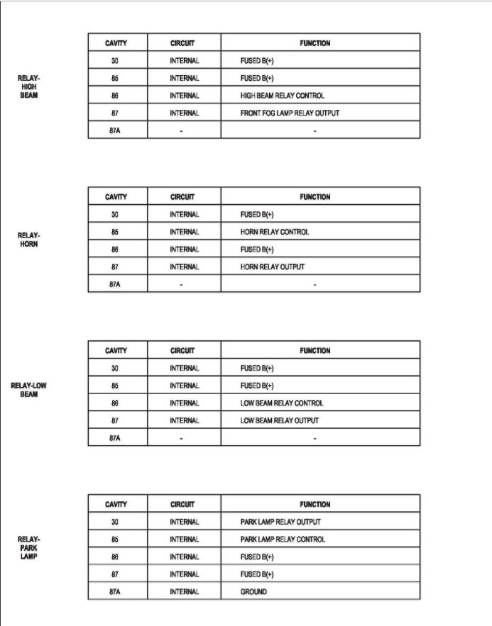

Lets check fuse # 5, 24, and 14 to see if they are okay. here is a guide to help you and the fuse locations as well:
