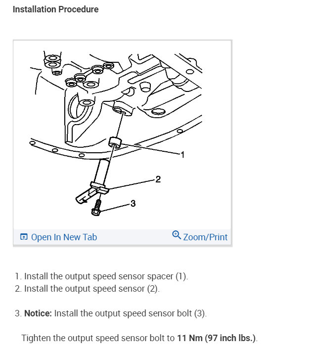

There are no check engine lights on but getting service engine soon and service stability system soon on display screen. all other gauges working. I hope it might be the speed sensor it would be easy to fix. but not getting a check engine light warning. can't afford to take it to a shop. Can you test a speed sensor? i would appreciate your help. thanks
Oct 11, 2022 at 3:45 AM
  • 55,214 POSTS

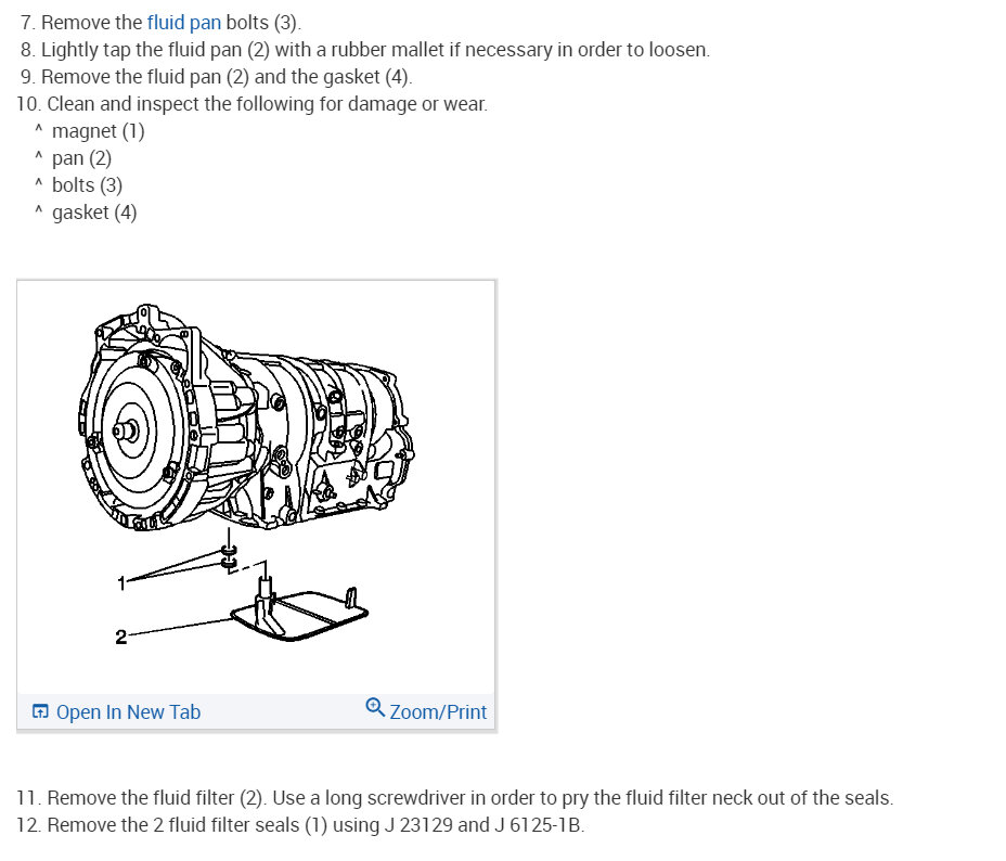

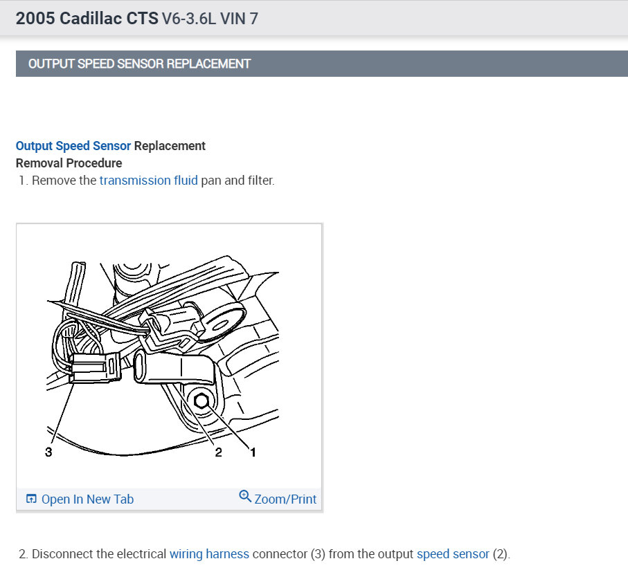

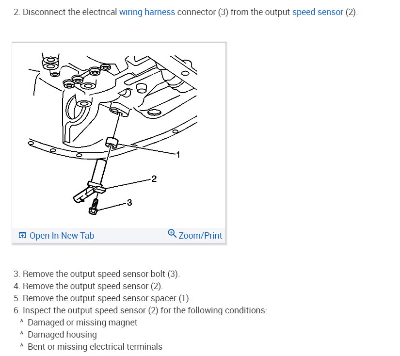

It does sounds like the transmission output sensor is not working here is the location of the sensor so you can check it out. You can test the sensor by tapping into the sensor wiring harness and setting your voltameter to millivolts, then spin both axles the same way and should observe voltage if the sensor is working. here the job is being done on an ABS wheel speeds sensor but the process is the same.
https://www.2carpros.com/articles/abs-wheel-speed-sensor-test
Check out the images (below). Please let us know what you find. We are interested to see what it is.

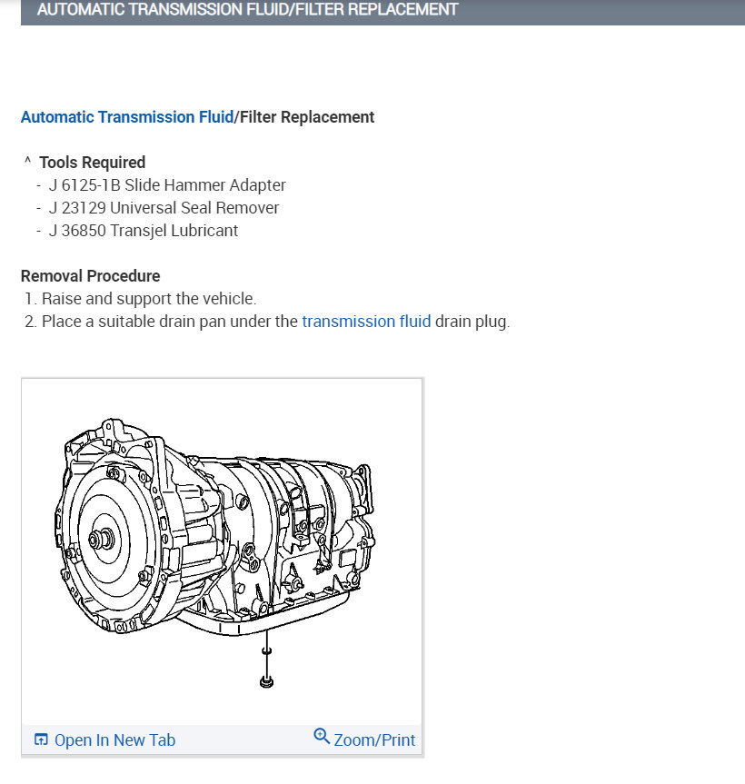

Thanks for the info. isn't there a speed sensor on the right rear of transmission? If so, could that be the problem? really didn't want to pull pan. It said with 7 in vin is that the eighth digit. Also, what about the filter, do i need to replace? haven't had any problems with trans. Thanks for your help. It is appreciated. I'll be waiting for response. have a good day.

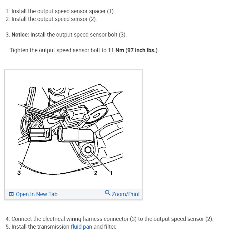

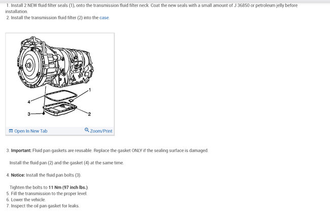

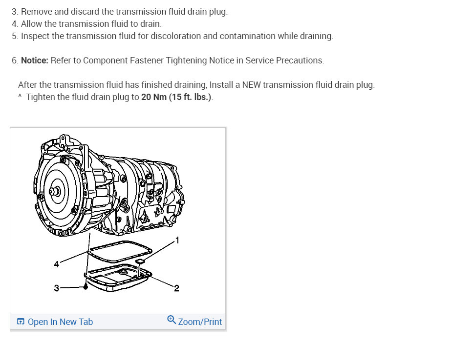

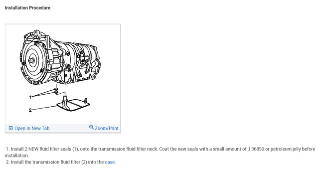

It does look like the sensor is inside the transmission pan. I would do a filter as well and make a transmission service out of it.
Here is a guide that can help:
Oct 13, 2022 at 6:58 AM
