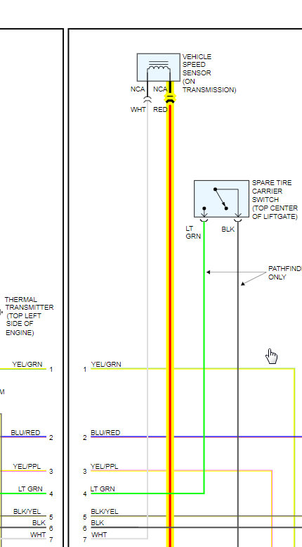

Sometimes my speedometer will respond when I start driving sometimes not. I found out that if I push the odometer zero button in it will either respond immediately or within the next few seconds or minutes this can also sometimes make the engine light go out if it was on.

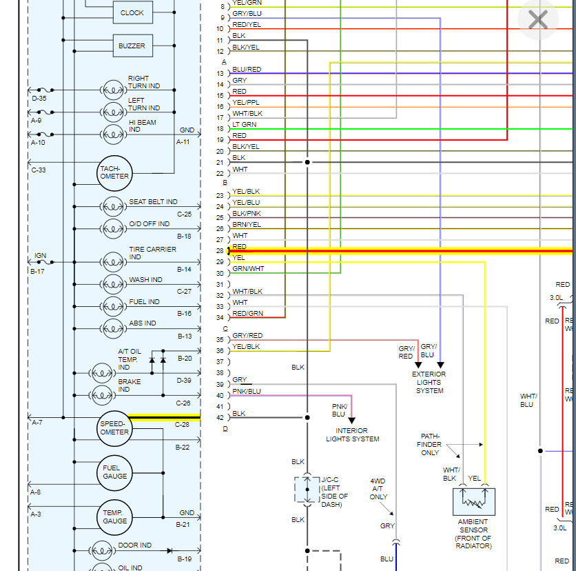

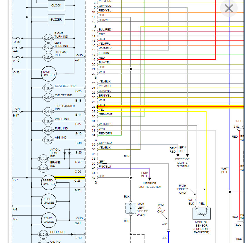

Okay. I guess I misunderstood the idea that you can make the engine light go out by pressing on the cluster. I understood that to mean the light was on. If it is on then there should be codes.
As for the speedometer not working properly, that gets a direct signal from the vehicle speed sensor. Take a look at the wiring diagram. I highlighted the wire from the speed sensor to the speedometer.
If pressing on the cluster gets this to work, I can only imagine there is a circuit board issue with the cluster causing this issue.
