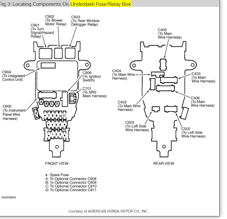

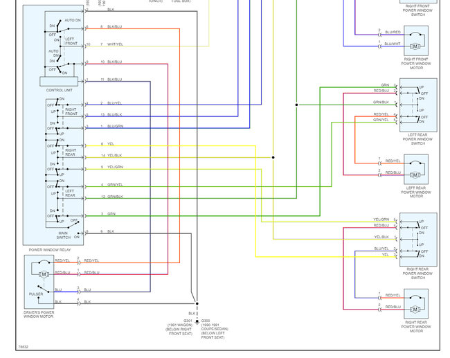

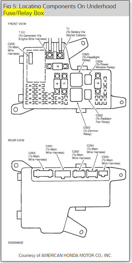

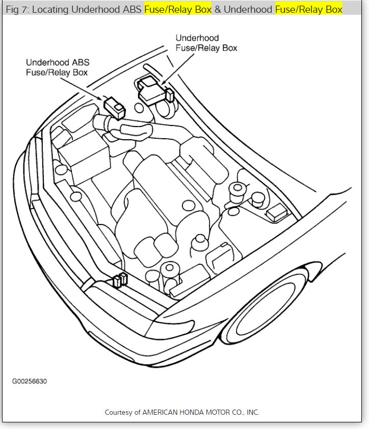

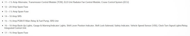

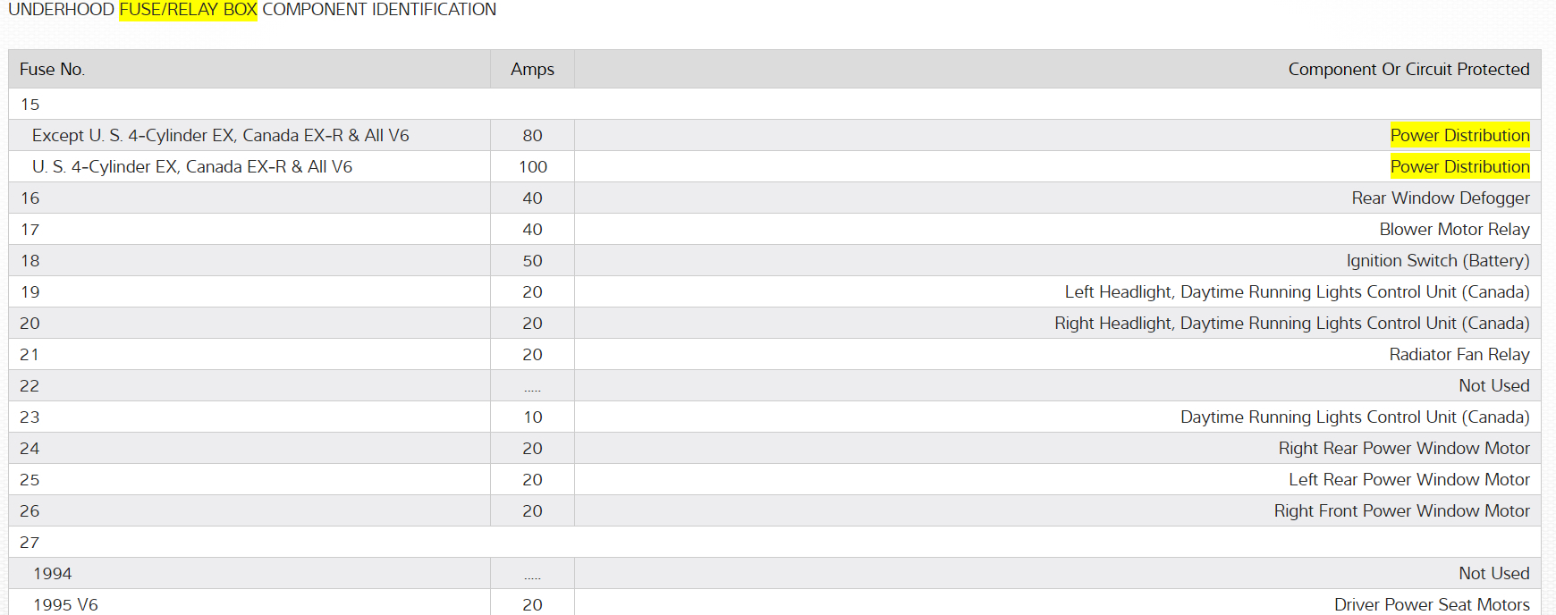

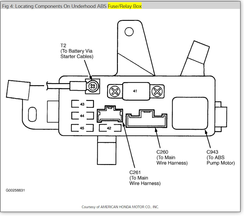

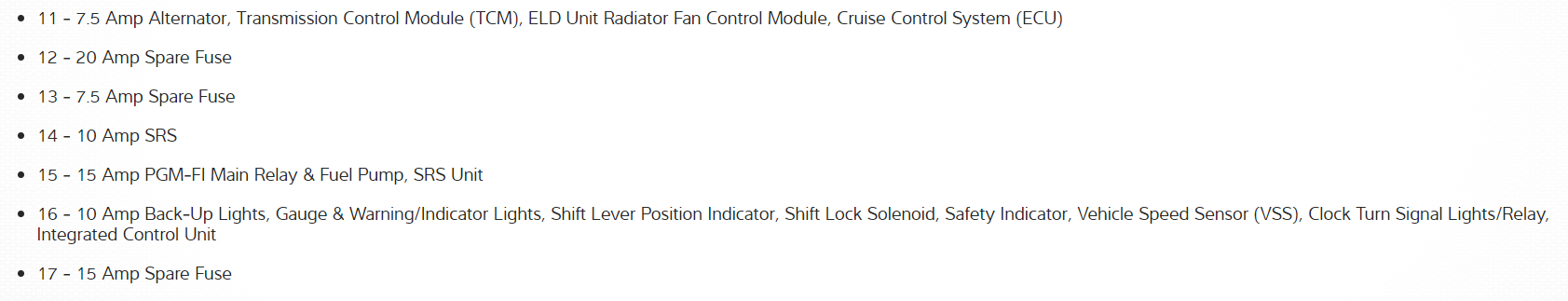

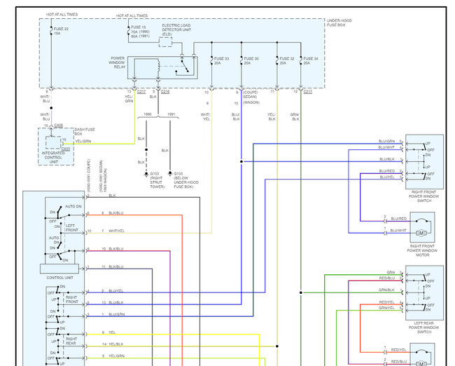

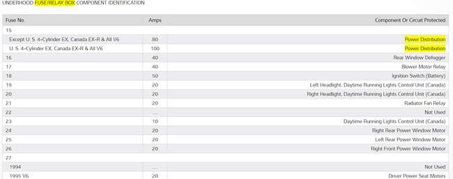

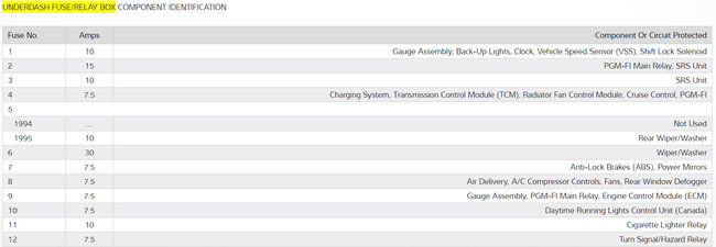

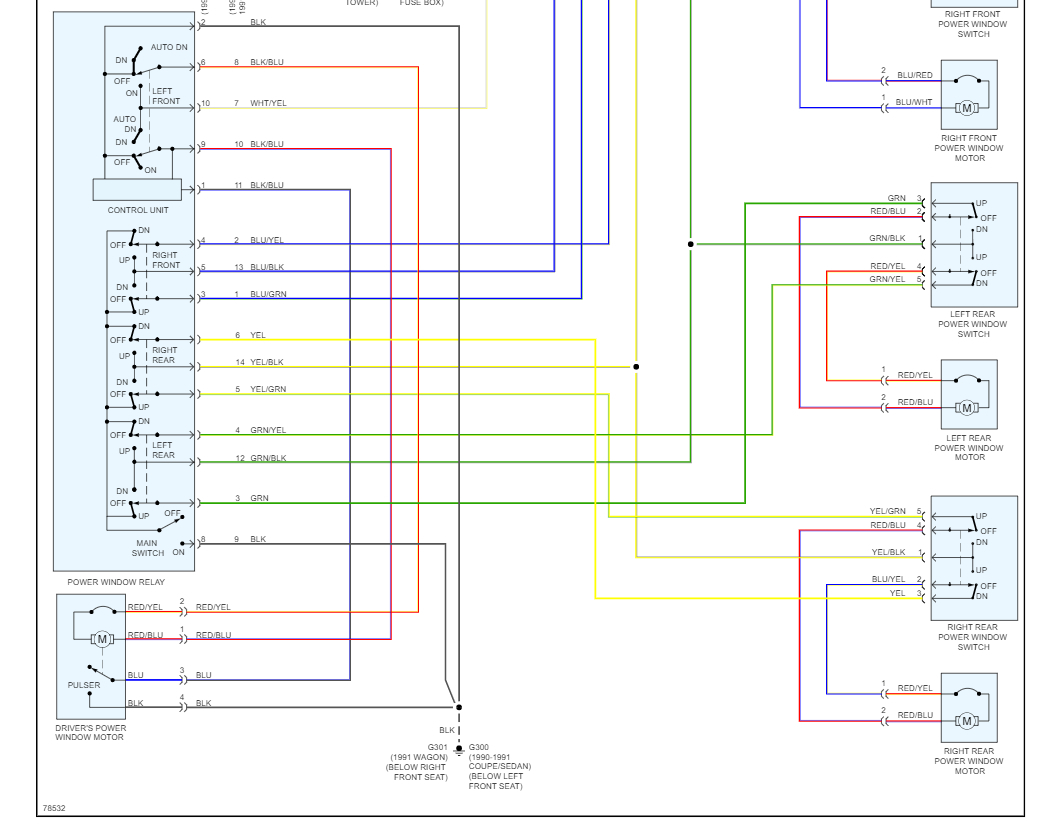

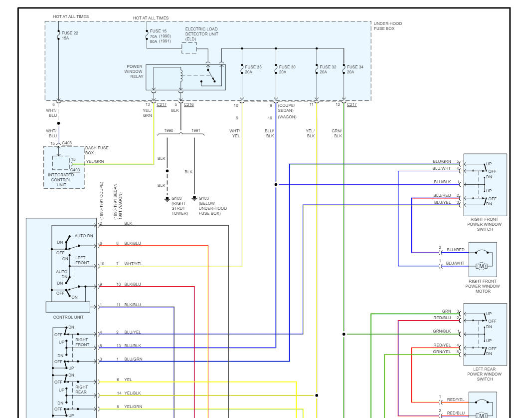

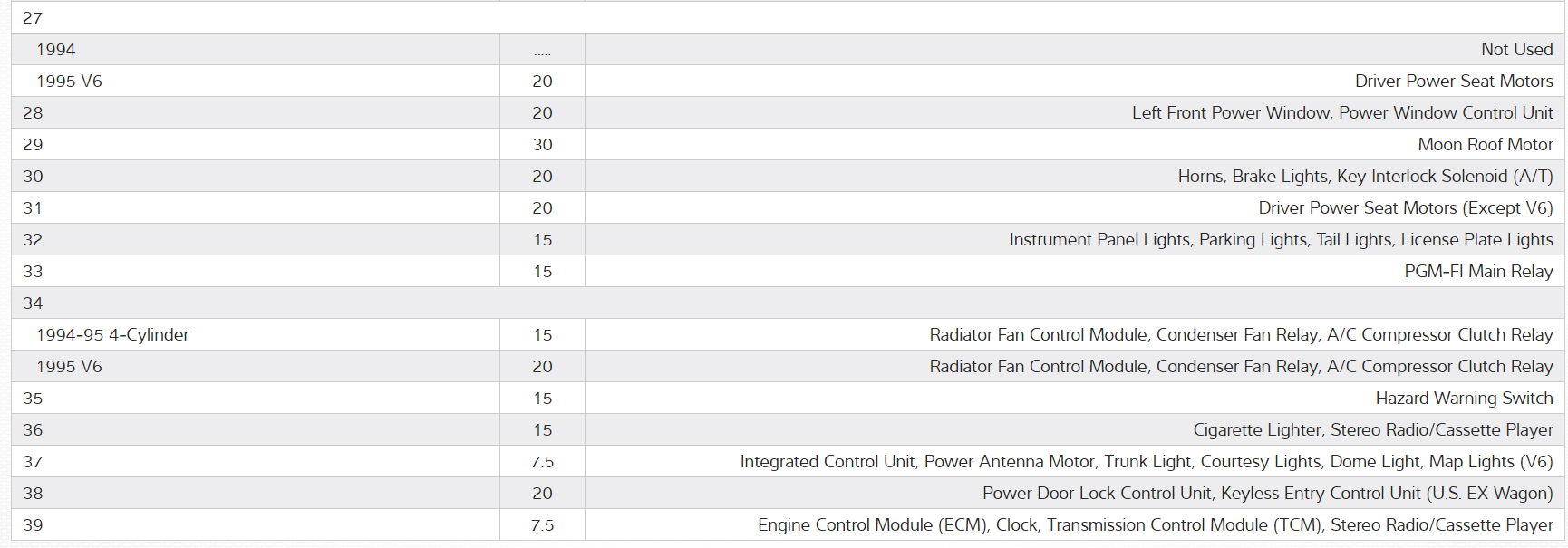

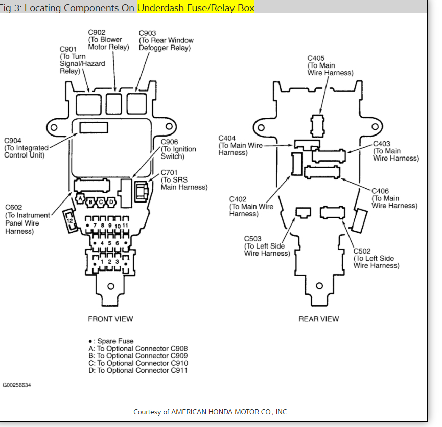

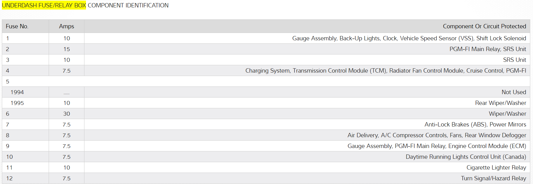

So, I have the car listed above. Well up until my friend put in a stereo the windows rolled and my speedometer worked just fine. Now neither of them works properly. I figured he messed with the wiring under the steering wheel. I need some help, maybe I am wrong. Maybe I'm just dumb and can't see the problem that is Infront of my face. A wiring diagram for under my steering wheel would be great!
Jun 14, 2022 at 3:24 AM
  • 55,273 POSTS

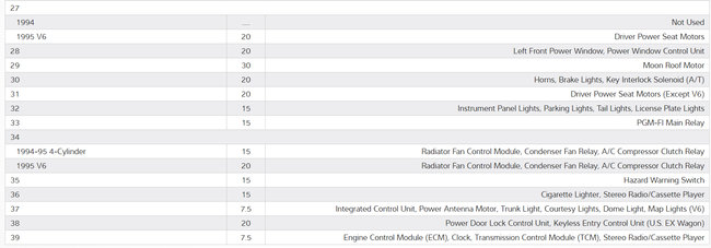

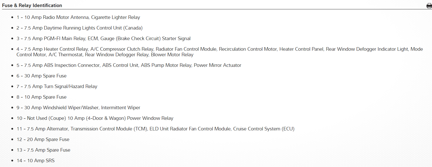

I would start by checking fuses here is a guide and the fuse locations so you can check it out. Here are the window wiring diagrams to help you check the right fuses:
