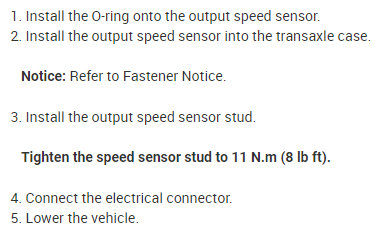

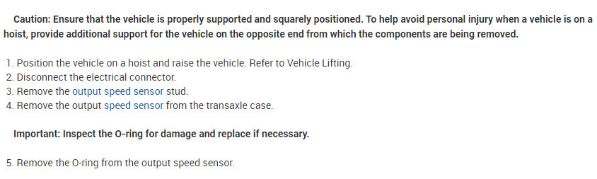

Hello again.

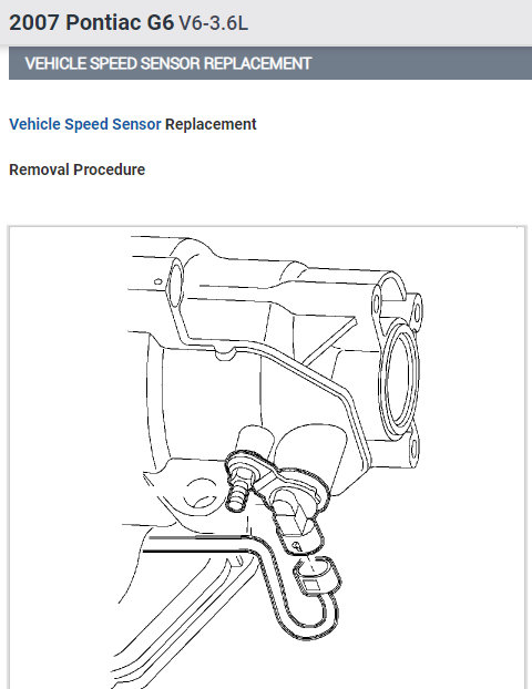

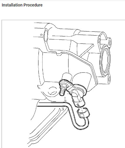

I've attached picture steps below for VSS-vehicle speed sensor replacement and location for your Pontiac including location on your automatic transmission. I will look to see what will be needed to convert to a Monte Carlo transmission and will update you with what I find regarding your speedometer issue. Hope this helps and thanks again for using 2CarPros.

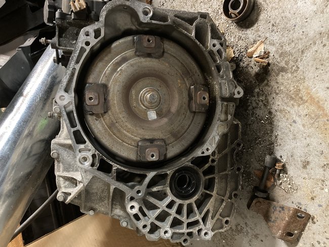

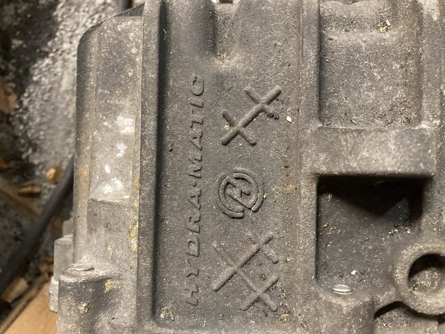

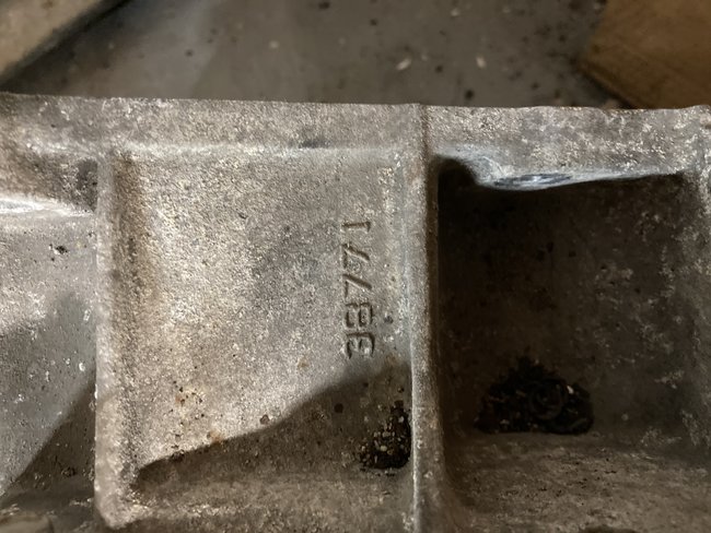

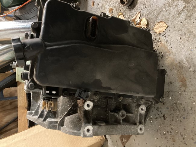

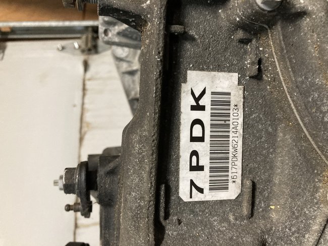

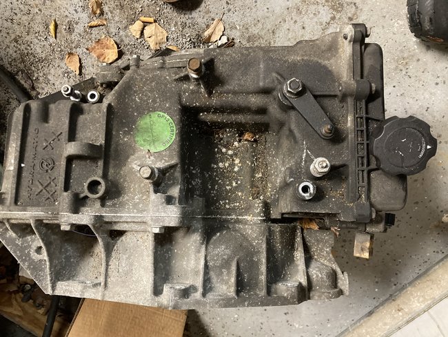

Sorry I didn't see this email. I thought I got a new alert but, found it. That is not what I have. I have attached pics of the one I took out and tried to get numbers as well. There are no plugs on this one other than the main harness. Maybe these will help. I appreciate it.

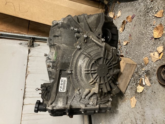

Here are more.

Hello again.
I did a bunch of research and found no real easy answer. Since you replaced the unit with the Monte Carlo transmission there are differences between the two and even though they both have vss- vehicle speed sensors those transmissions have different gear ratios which is what is throwing things off and not making your speedometer not work right. You might want to find a transmission shop or person that can manipulate or modify the vss to make the Monte Carlo vss compatible with your Pontiac transmission controls. Hope this helps and let me know if you have any other questions on this issue. Thanks again for using 2CarPros.

I am sorry it was a 2008 Malibu not a Monte Carlo if that makes a difference. My Pontiac had a 7PDK gen 1 6t70 transmission and the Malibu had a 8PDK and I think is the 6t70 gen 2 transmission.

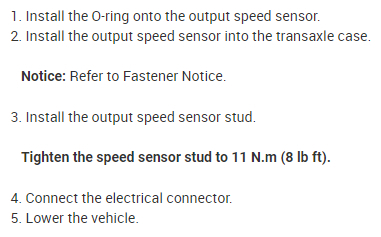

Yes, we are going to be having the same problem with this transmission as well. The gear ratios are still different from your Pontiacs original transmission. Even though the Malibu transmission has an external bolt on VSS- vehicle speed sensor they are different ratios. You might want to look online to see what companies can make an in-line gear ratio correction to make the Malibu transmission compatible with your Pontiacs transmission electronics. Those kind of places are out there but none come to mind off the top of my head. I've attached pictures below showing the VSS-vehicle speed sensor replacement and location on the Malibu transmission. The last two pictures show the part numbers for both your Pontiac and the Malibu VSS-vehicle speed sensors. If you find a transmission shop that can make an adapter or somehow calibrate maybe the part numbers can help with gear ratio information. Hope this helps and thanks again for using 2CarPros.
