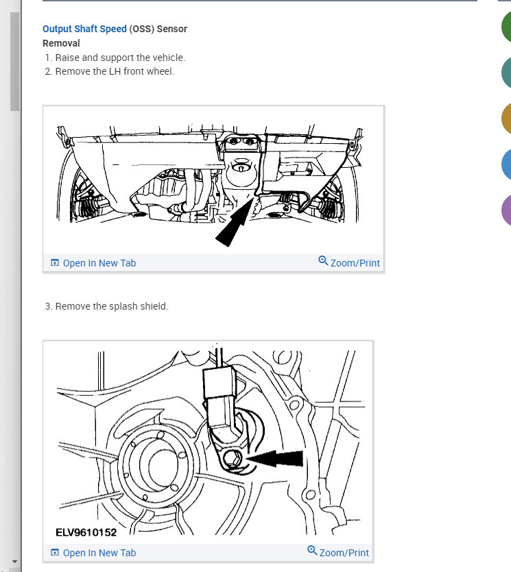

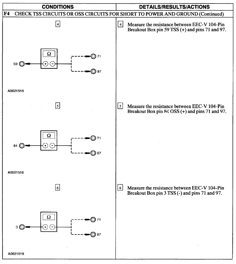

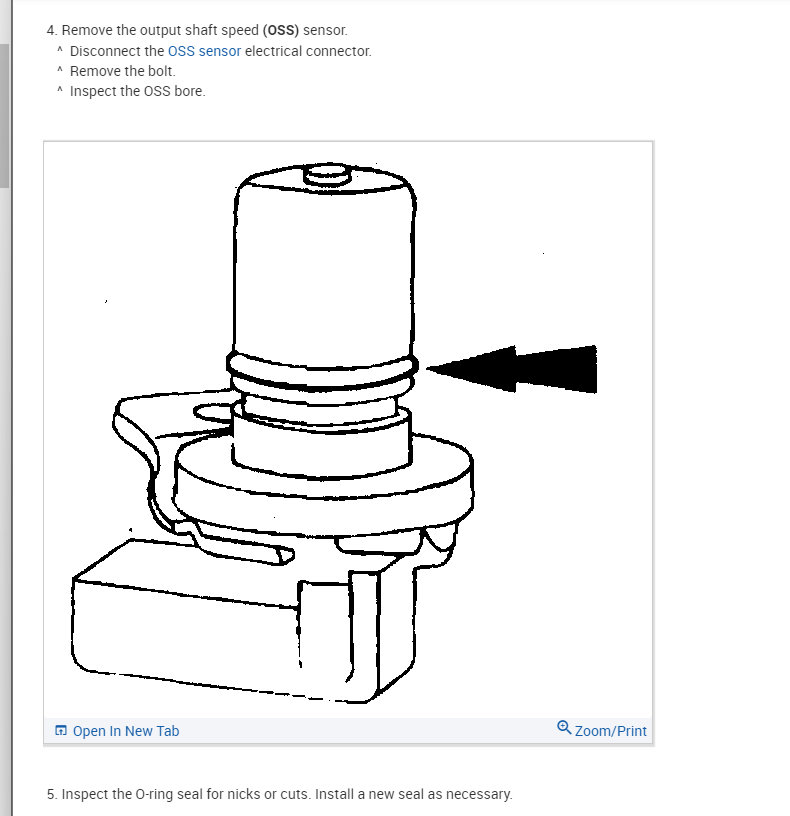

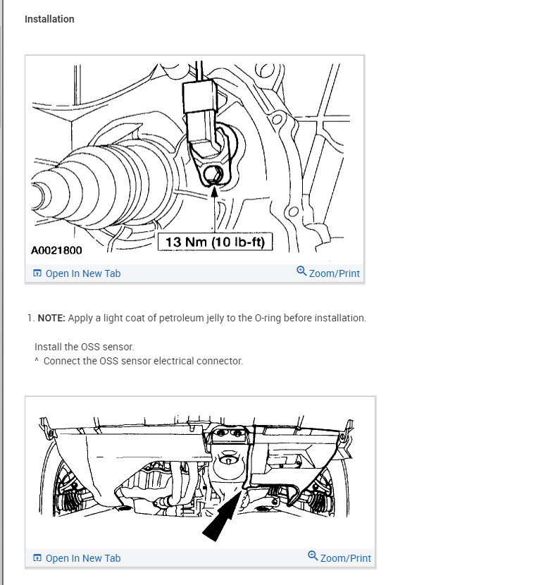

I have replaced the output speed sensor which worked for a few days but then started doing it again. Now when driving it the speedometer will not move which as you know the shifting is not working unless I manually do it, and even then, the overdrive light starts flashing. I just replaced the plug also that comes off the wiring harness because it looked worn, but again that didn't work. Can you please help me to get my tuck back on the road? I just need to know what to do.
Jun 4, 2022 at 1:11 PM
We could have a couple of issues so let's start with the basics and see what codes are there and then we can take the next steps.
Here is a guide that will help with this:
However, this does sound like an output speed sensor issue. Just because you replaced it and it worked and then it stopped working doesn't mean the new sensor hasn't failed.
We should have some codes though so let's start there.

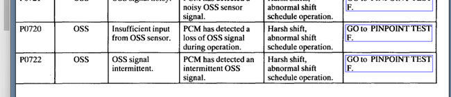

Okay it came up with five codes they are as follows:
P1131
P0720
P0722
P0340
PO100
These are the last readings that I ran, before I am not able to drive it due to the over drive light comes on and you know what happens after that it want shift.

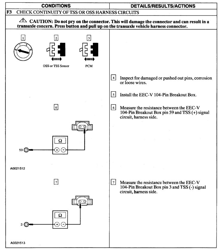

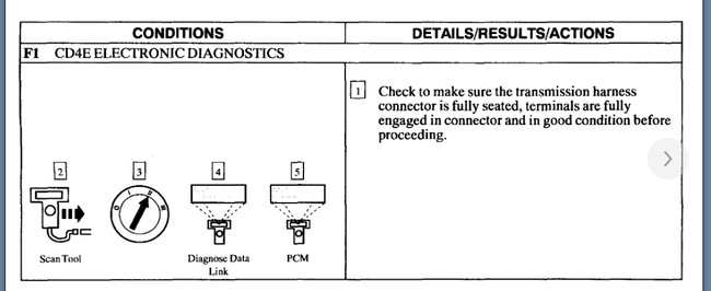

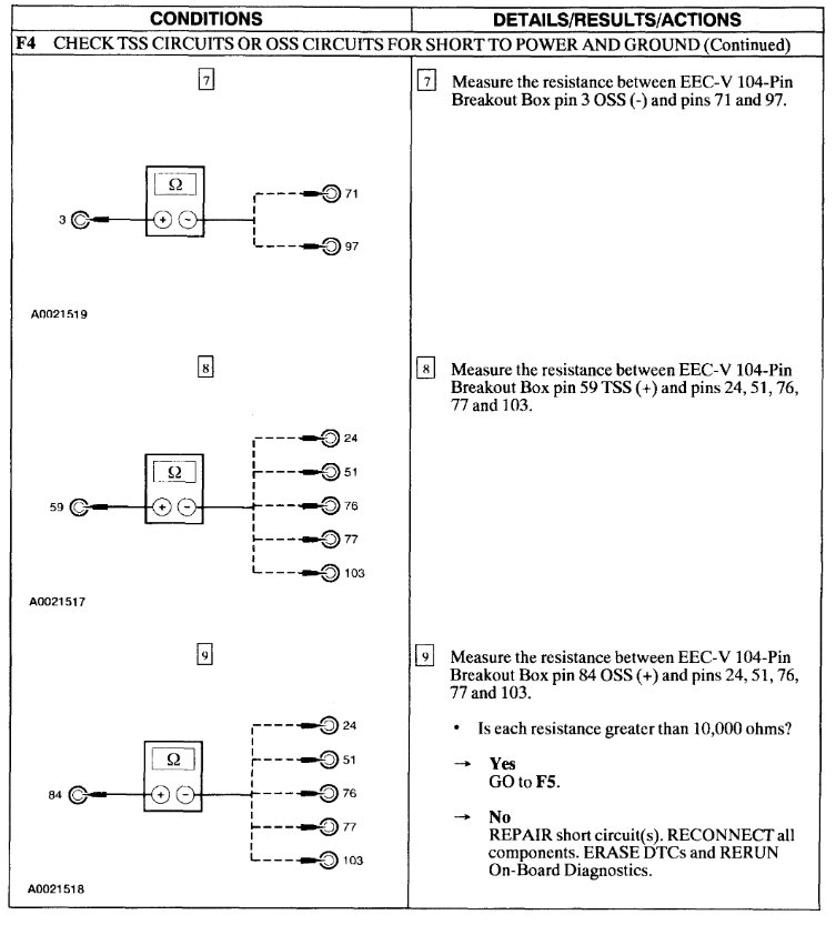

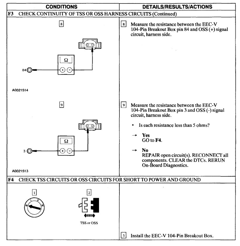

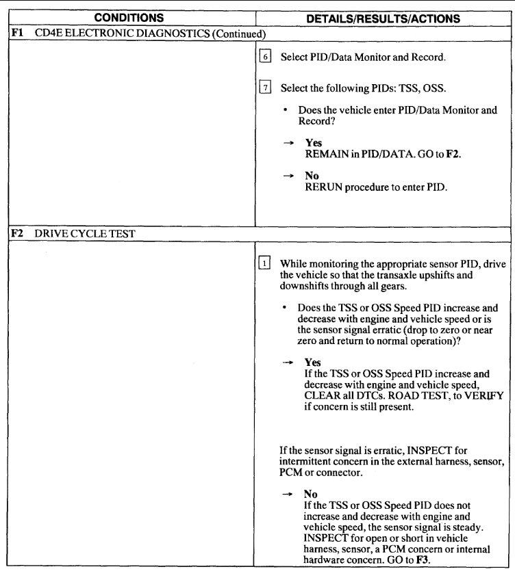

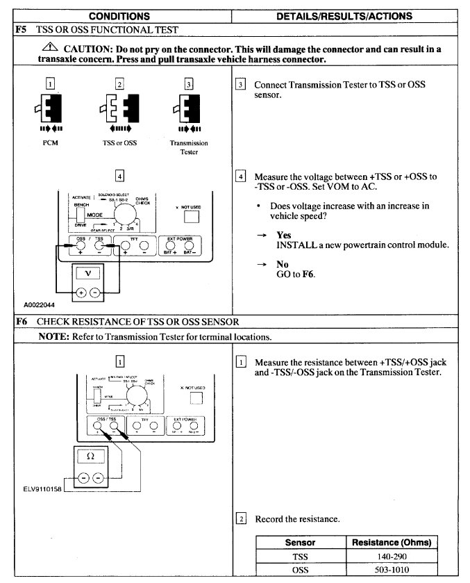

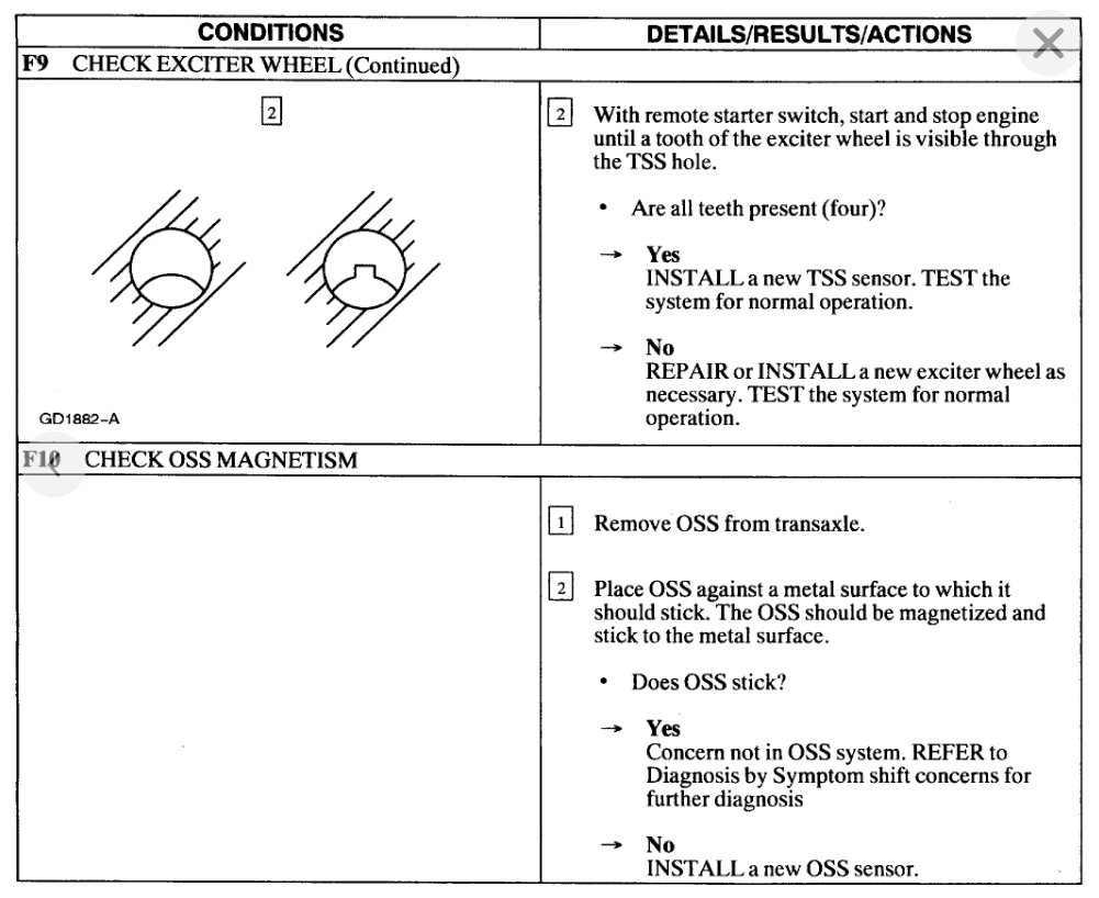

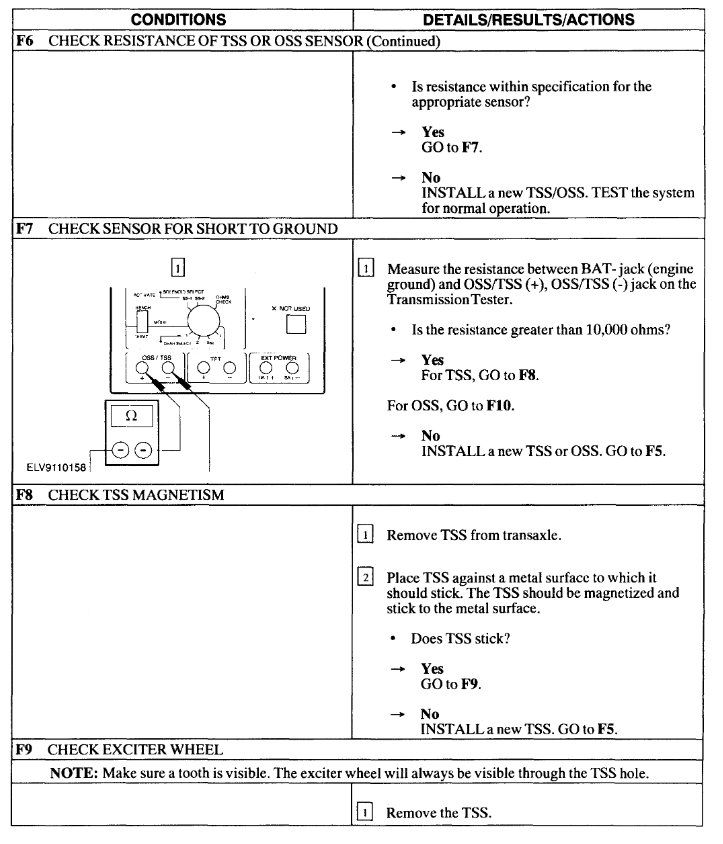

This could be a PCM issue, so we need to start with running through this testing before we try to figure out if the o2 issue is related. Clearly this is a different system but if you need a PCM that may fix the o2 sensor issue as well.
So, let's start with running through this testing and go from there.

I'm sorry but I just can't read what you sent to run some test. Is there anyway, you could maybe call me so that I can understand what I need to do? If so, just let me know and I will shoot you my number and a good time to call. Again, I just can't read it. I'm sorry.
Michelle Favell
Jun 7, 2022 at 10:12 AM
Are you clicking on the image so that it enlarges it? If you are viewing it on your phone, you can click on it and then zoom in using the two finger zoom that smart phones have.
