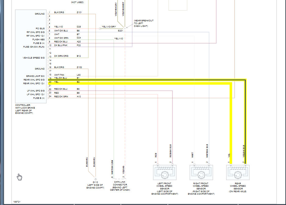

Rear axle assembly failed, replaced it with one from the salvage yard. Now the speedometer does not work, replaced ASB sensor from old differential still nothing. I'm thinking maybe i pulled on the wire connector to hard.but i checked it with my multi-meter there is 12 volts on the yellow wire, but should i have any power on the green?

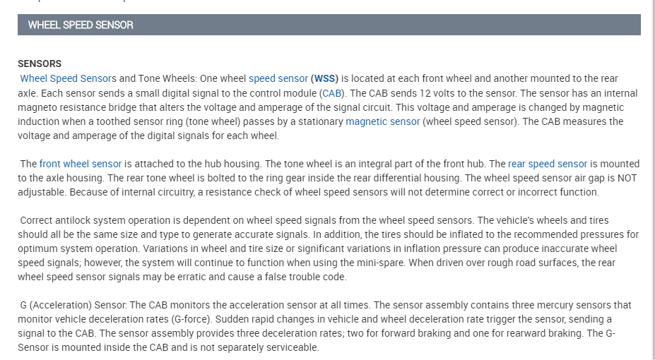

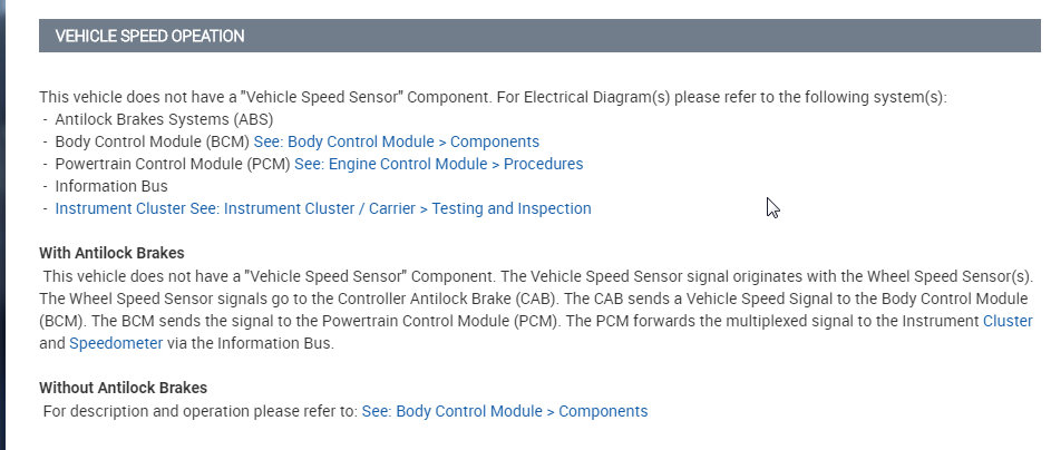

You are correct that this is the most likely issue because the ABS needs to calculate the wheel speed and then it sends it to the PCM which then sends it to the cluster.
If you have 12volts on the yellow wire, that is correct but you should have the signal back from the sensor. So if you have 0 volts on the other wire then that is the issue.
Due to this being a used axle, we need to ensure it is equipped the same as your vehicle. Do you know the part number off the axle or at least what year and model vehicle it came out of?
If you swapped the sensor from the other unit and it was working prior and it is still not working then we can assume the sensor is not the issue. That means, it may be mounted to far away from the tone wheel. Speaking of the tone wheel, we need to make sure there is a tone wheel in the rear end. You should be able to use a borescope to look down the sensor hole and see the tone wheel.

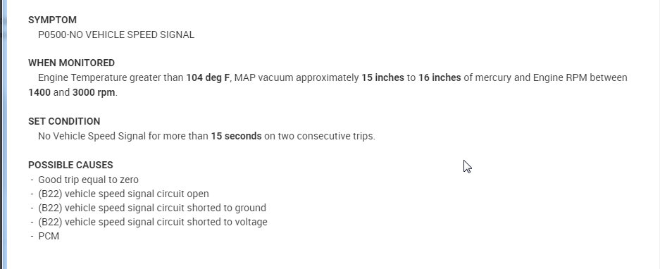

i haven't found a number on the housing yet,but it did look identical to the old one and both had the sensor in the same location . and i get the p0500 code an the engine light is on but not the ABS light if this means anything. thanks again i'm still looking for number.
Jul 2, 2020 at 7:19 AM

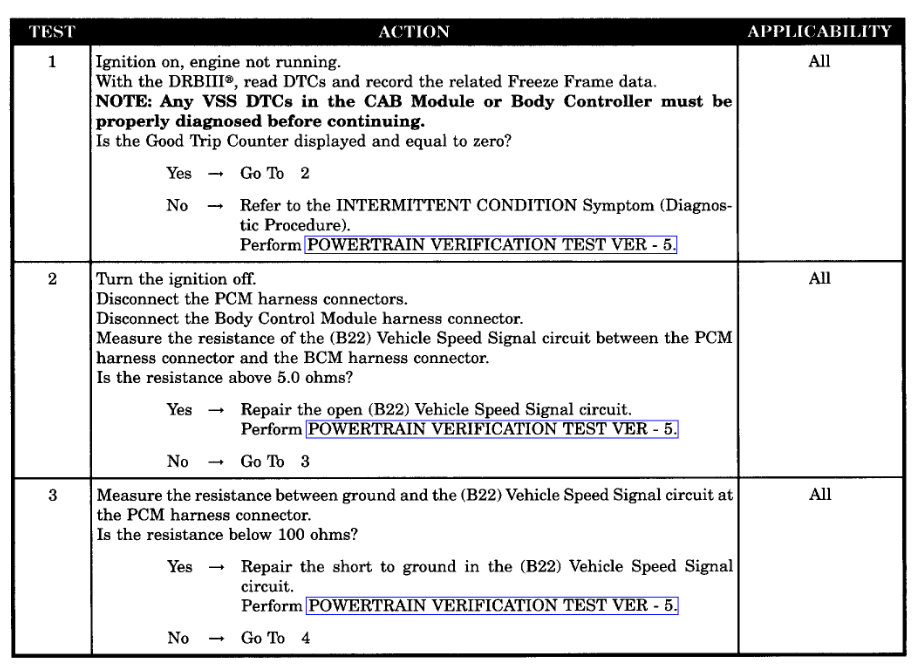

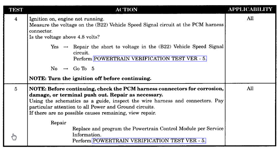

Okay. I attached the testing but that is just confirming that you are not getting a vehicle speed signal. Take a look at the testing.
Jul 2, 2020 at 1:41 PM

The green wire is called the signal wire. This means the yellow wire supplies the 12 volts and then the sensor picks up the high spots of the tone wheel and when it does, it sends a voltage pulse back to the PCM. The speed/rate of this pulse tells the PCM how fast the vehicle is traveling. So it will not have any voltage when the connector is unplugged. When it is plugged in and the rear end is spinning it should have a high and low voltage signal that if you spin the rear slow enough you should be able to see on a meter if you back probe it.
