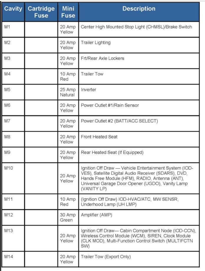

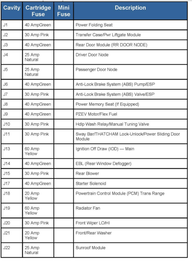

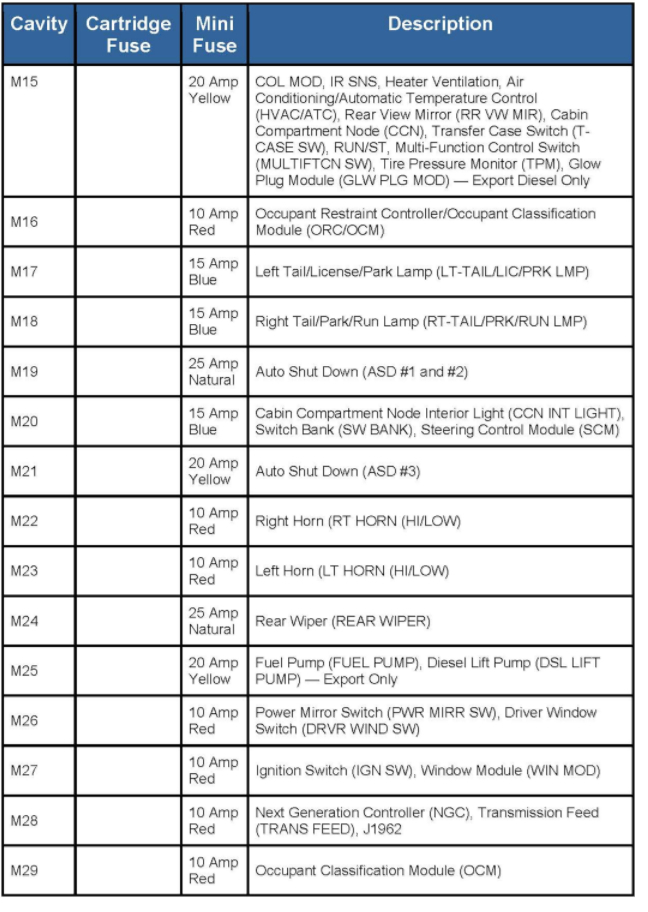

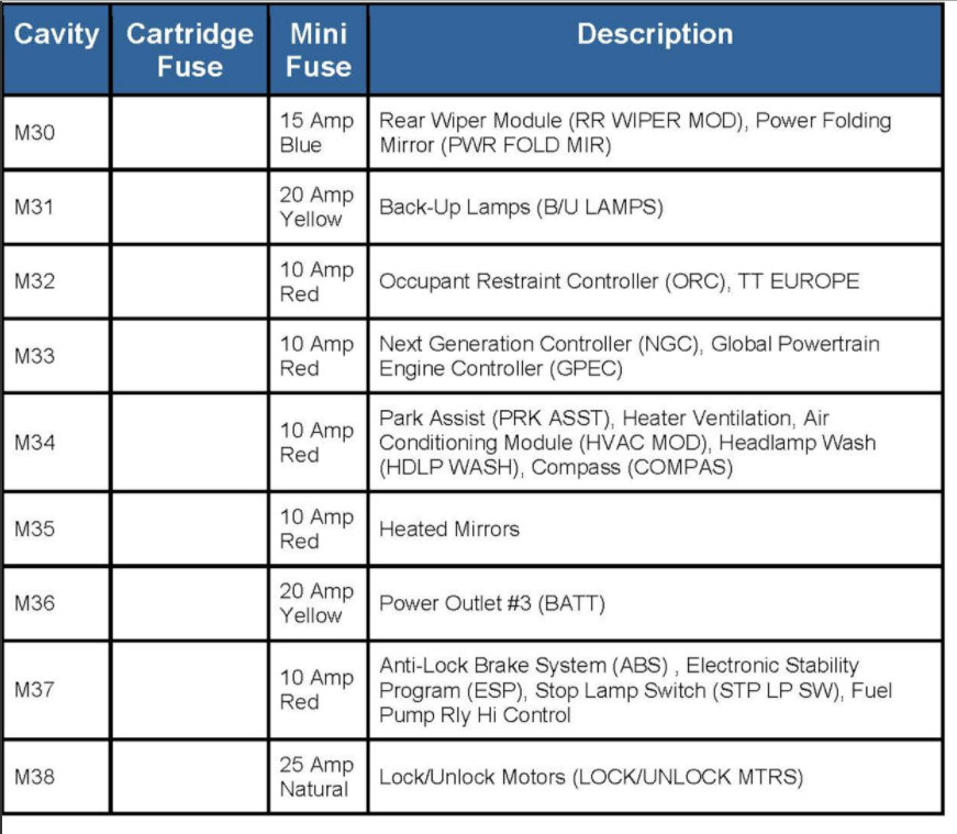

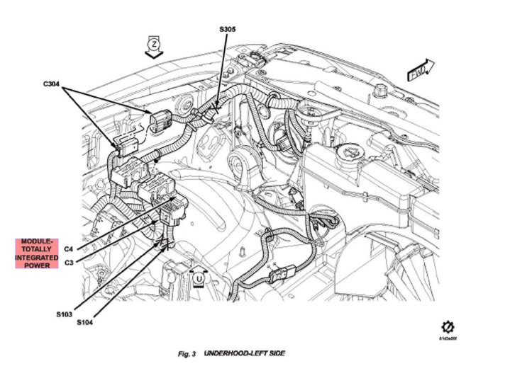

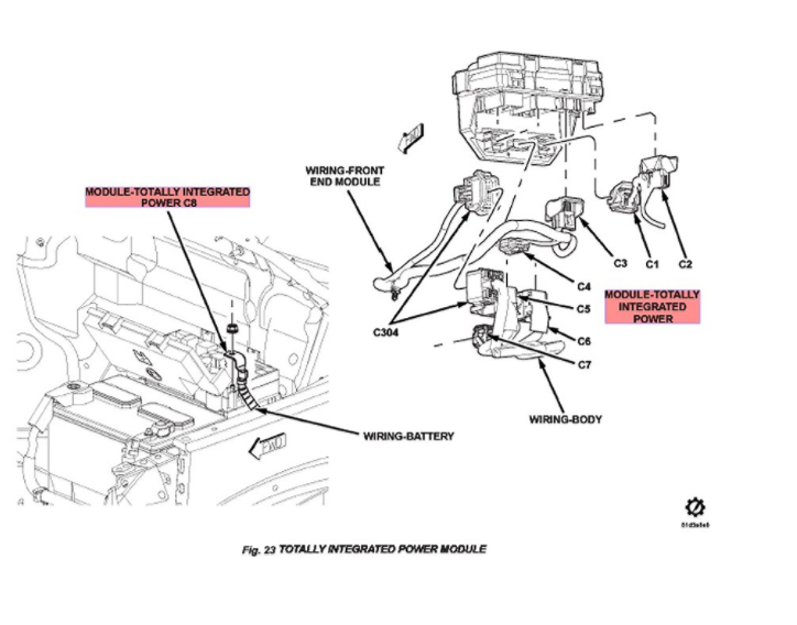

When the error message reads in the odometer is means the CAN is down and the three inputs from various computers is not seen so the computer does not know how many miles you have driven hence the error message.

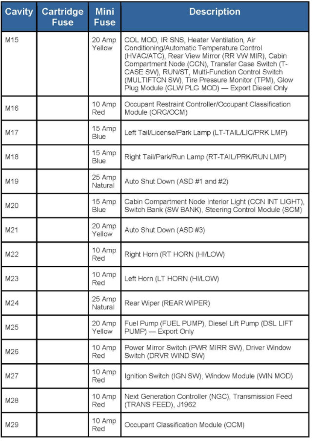

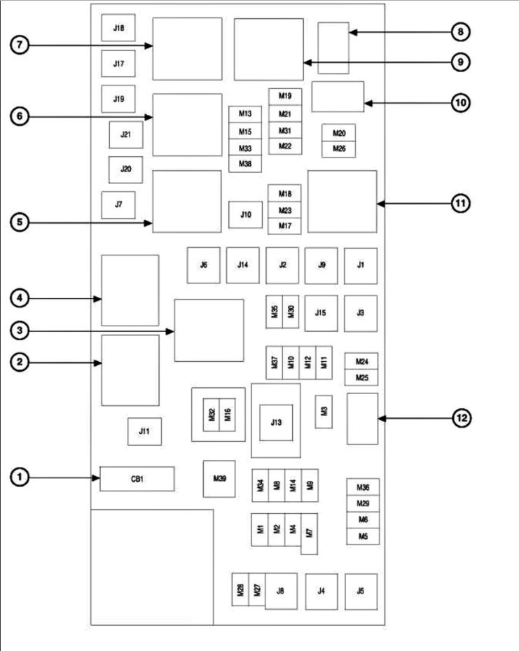

I would start by checking fuses becasue it sounds like one is blown

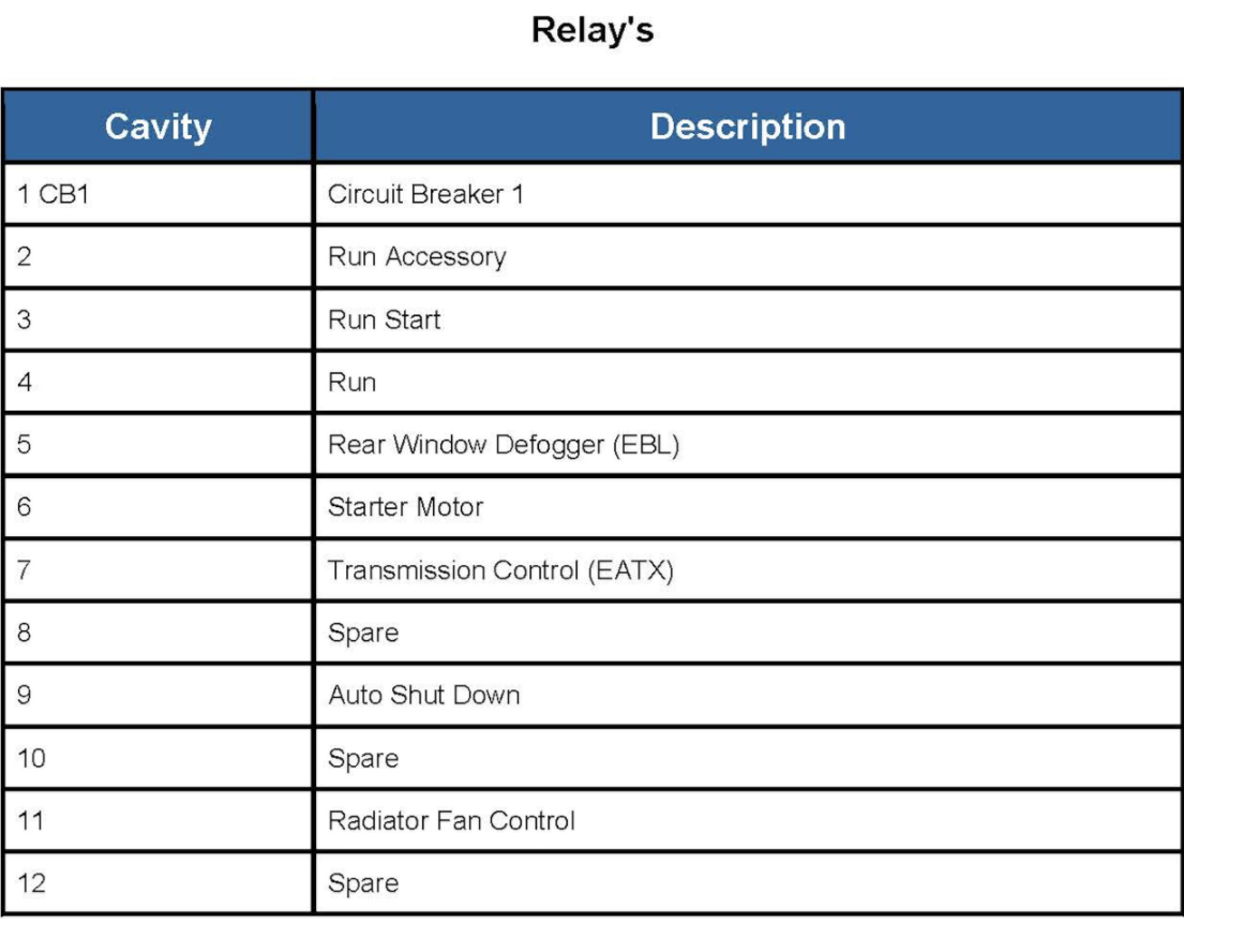

Here is a guide and the fuse locations to get us started.
They had problems with the transmission control relay as well
