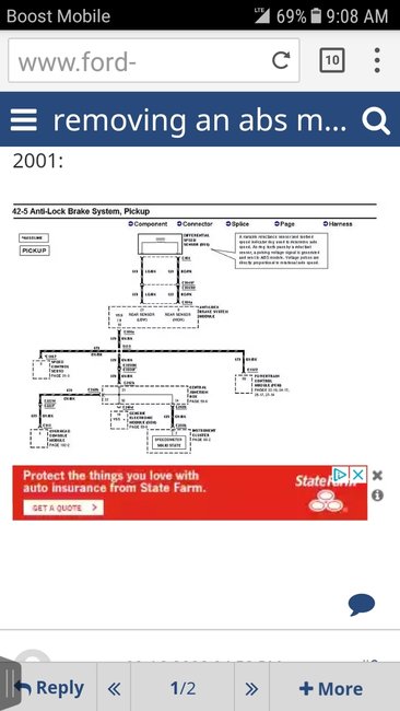

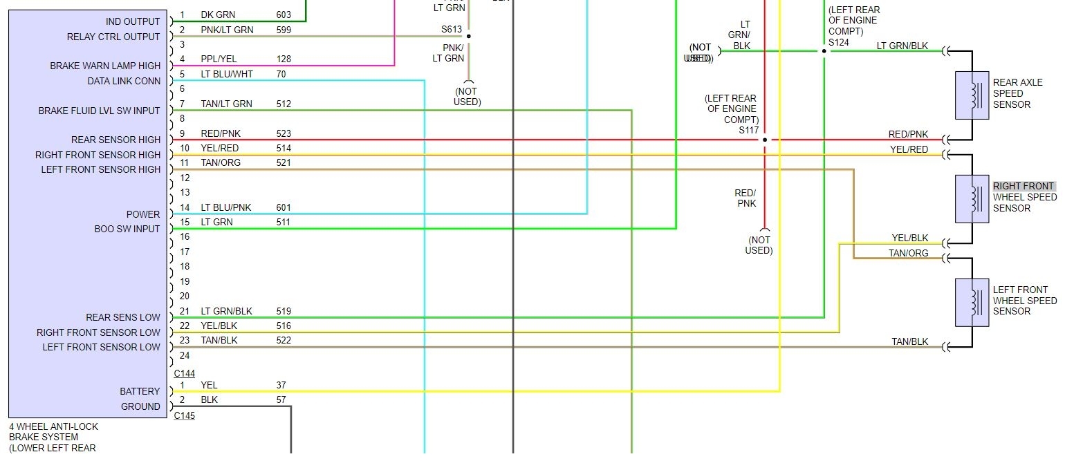

Speedometer inoperable getting signal from differential speed sensor to ABS module. supposed to be black/gray wire leading to PCM .i have no such color. wondering if anyone may know what color wires i need?

I see it actually as a gray/black wire.

that is what throwing me off that is what my diagram shows also.

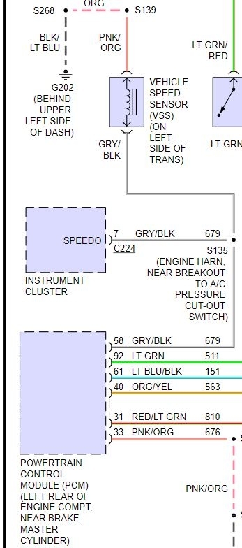

Pin 58 of the PCM is where the gray/black wire should be.
Mar 17, 2018 at 8:39 AM
KEVIN1954
  • 15 POSTS

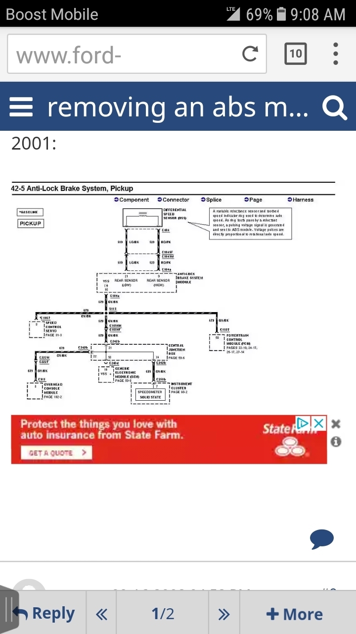

I think we are looking at the same diagram. There is no pin 58. This truck receives it speedometer from the differential sensor. The particular diagram is for the transmission sensor.
Mar 17, 2018 at 8:55 AM
PATENTED_REPAIR_PRO
  • 1,853 POSTS
It is there in that diagram, too. Lower right hand corner is pin 58 of the PCM, same gray/black wire.
Mar 17, 2018 at 9:23 AM
KEVIN1954
  • 15 POSTS
that is what i am saying there is no gray/black wire on the ABS module or the PCM. all i have is the lg/bk and rd/pk sensor wires leading into the ABS module.

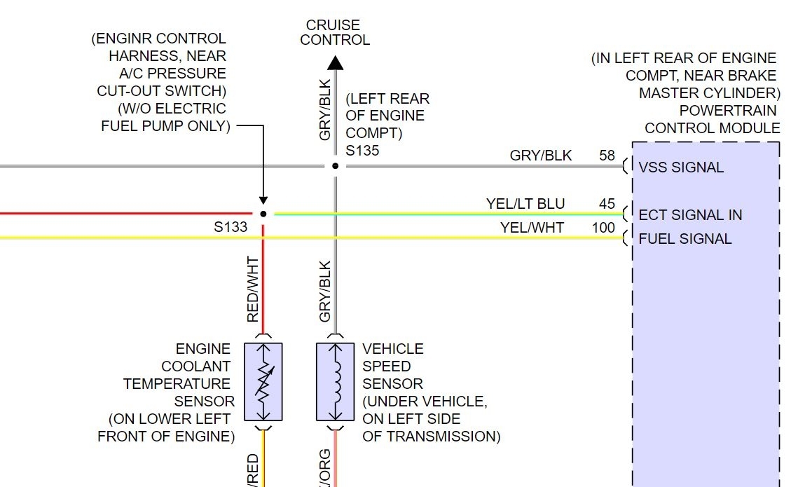

So what color wire is at pin 58 of the PCM?

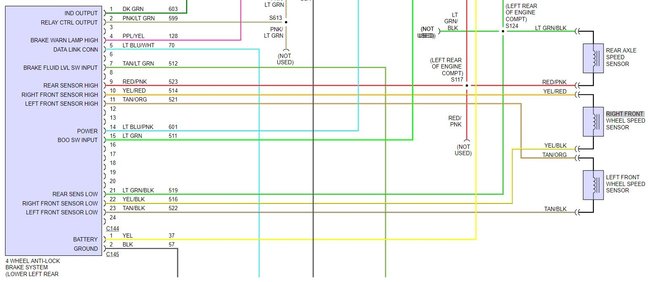

Why are you looking under the rear axle speed sensor anyhow?
Those are the correct wires at that rear axle speed sensor, but it os the other sensor that I see is for the speedometer.

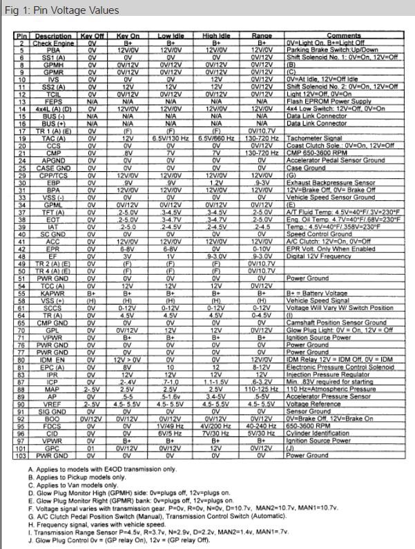

Only 40 pins? I see over 100. 104 actually.
Where exactly is this PCM located?
Near the brake master cylinder?
See the pins here.

That is not what I see from them wiring diagrams. Look at the gray/black wire to the instrument cluster, it comes from the transmission speed sensor.
Did you actually check that pin 58 of the PCM? or did you just assume there was no pin 58?

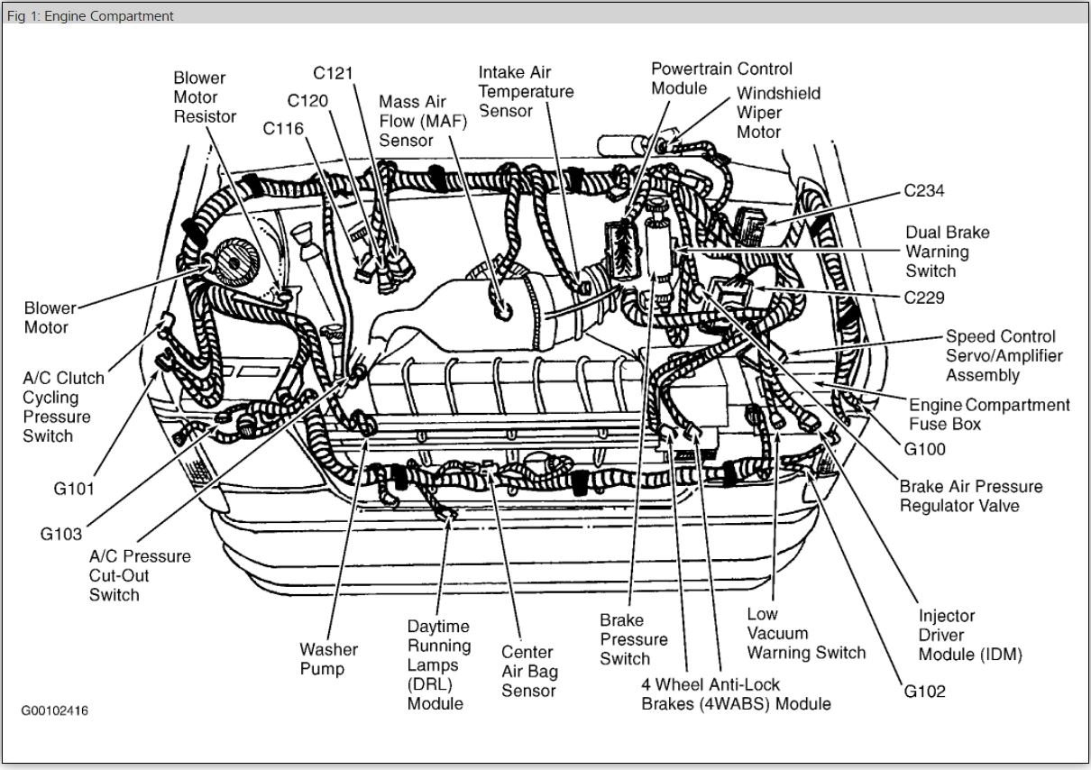

I do not see the PCM on the fender. here is a diagram under the hood.

I do see a mention of Check Rear Anti-Lock Brake System (RABS) Sensor
Turn ignition off. Disconnect RABS sensor connector. Sensor is located on rear differential assembly.

Turn ignition off. Disconnect PCM 104-pin connector and inspect for damaged pins, corrosion and loose wires. Repair as necessary. Install Breakout Box (014-00950), leaving PCM disconnected. Measure resistance between test pins No. 33 and 58 at breakout box. If resistance is 21, 000-55, 000 ohms, go to step 4). If resistance is not 21, 000-55, 000 ohms, go to next step.

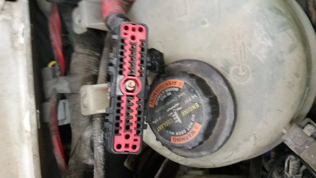

I do not know why your PCM has no pins higher than 40.

It is a diesel. Plus it has not got a psom. For some reason i think being a conversion is the problem.

What is that you are showing me a photo of?
I am heading out, will be back later.
Are you sure you are looking at the PCM? Perhaps get the numbers off the PCM to see it is in fact the PCM.

Picture of the so called PCM connector. Check back later thanks for your input. Have a nice weekend.

I am back, can you back the camera up and take a photo of the PCM and another photo showing where that PCM is located under the hood, because I do not see it on the fender and I do not know why they would move it when doing a conversion.
How about the part number off that PCM too?
These are the PCM part numbers I see, for federal F8UZ12A650AFH and for California F8UZ12A650AGH.
