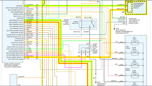

always had a hard shift into second gear. now odometer and speedometer don't work. replace speed sensor on rear and speed gauge.
Mar 10, 2021 at 10:02 AM
Good morning,

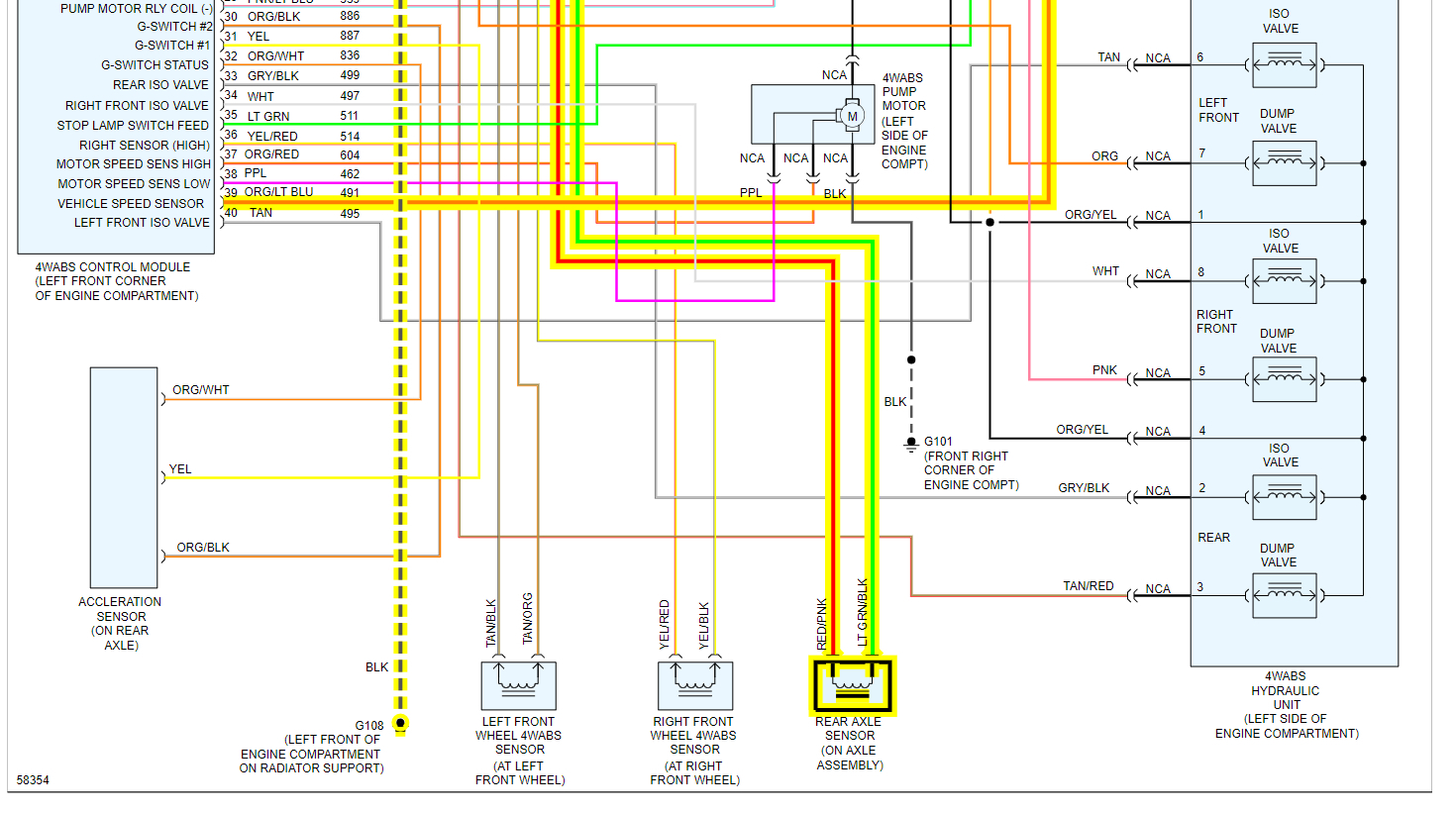

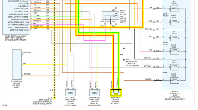

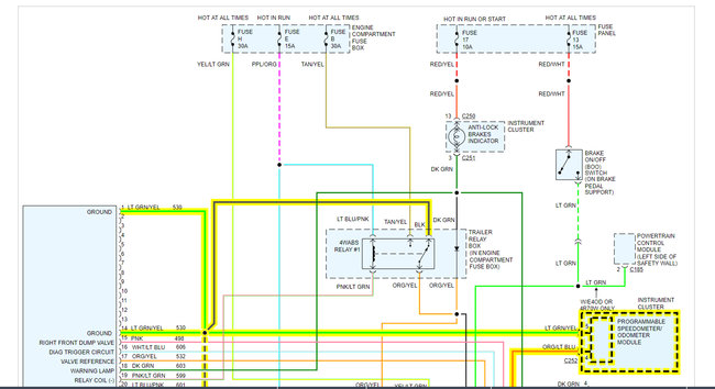

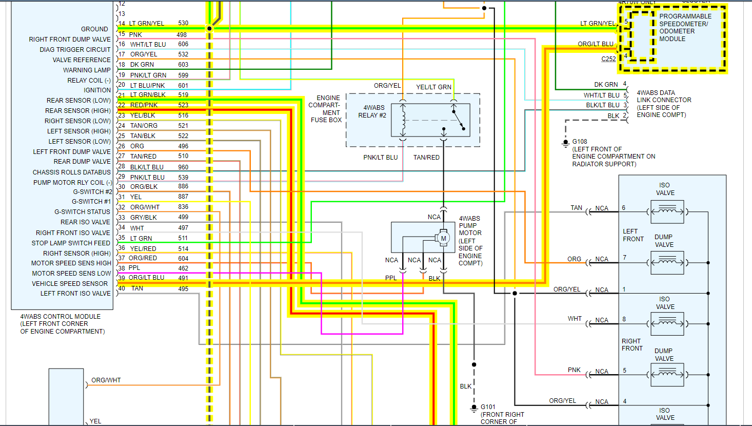

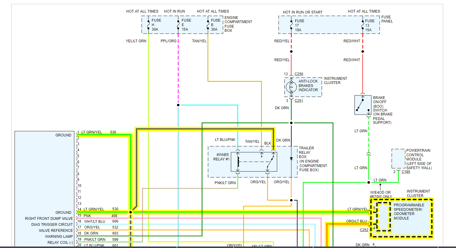

The rear ABS sensor is the speedometer control as well. It sends a signal to the ABS module which sends a signal to the dash for speedometer. It also sends a signal to the transmission.
https://www.2carpros.com/articles/how-to-replace-a-abs-controller
This is most likely the reason the shifting is hard. Without a speedometer signal, it will not shift smoothly.
