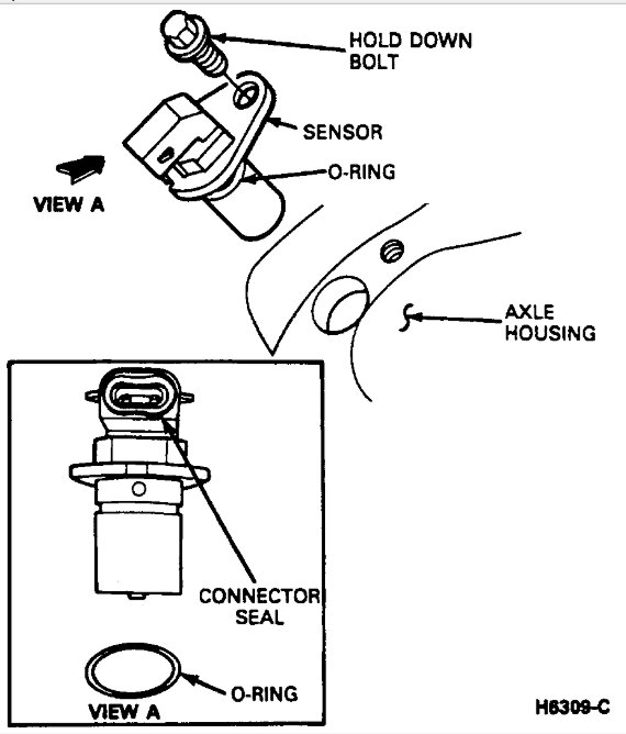

I need to know where my speed sensors are located specifically the one or ones on transmission

The vehicle speed sensor or VSS is located in the rear differential housing. Check out the images (below). Let us know how it goes
Image (Click to enlarge)

thank you so much for that clarification.
