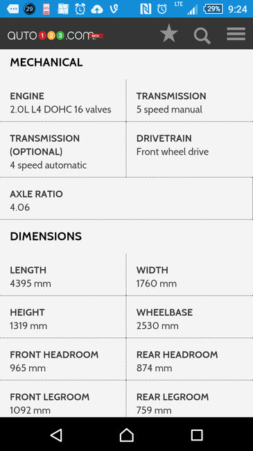

We need an engine size first.
Jan 23, 2016 at 2:51 PM
FATHOMBANMAN
2.0
