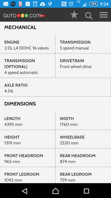

I need to replace a speed sensor and don't know the location of either input or output.
Is there a video or diagram that would give me a good idea of what I'm looking for. I am not a car guy so the more detail the better.
( odometer and speedometer not working)

We need an engine size first.
Jan 23, 2016 at 6:51 AM
FATHOMBANMAN
2.0

It's on the top of the transmission, below the coils. https://www.2carpros.com/images/external/104229140.jpg

That is the vehicle speed sensor which is also called the output speed sensor. The input sensor has nothing to do with the speedometer.
