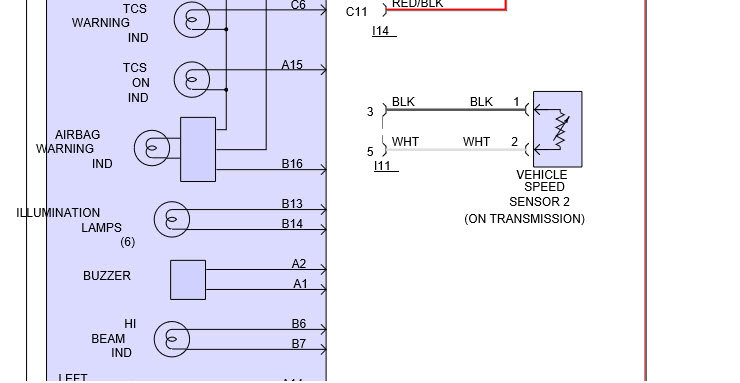

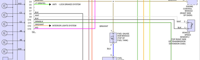

I got a parking sensor that is also a digital speedometer. i need to tap in to the speed sensor wire for the speedometer to work. i need to know the location of the wire. i tried behind the cluster but i do not know what color wire it is. i hope you can help.

we do not have the Liberty model here in US. However, a Forester is a black wire and white wire and runs to c9 and c10 on cluster connector. See picture.

Hi ken i have 2 connectors near the speedo 1 with 3 wires and 1 woth about 7 wores which one would have the speed sensor connected too

ok now that I knew it was a legacy it goes to position 3 &5 on connectors which should be marked on plastic. see pic.

Hi HAMC300 just wondering to get the speed signal do you know if i have to connect my wire to both speed signal wires thanks

yes they both have to be connected to where they go in dash.
