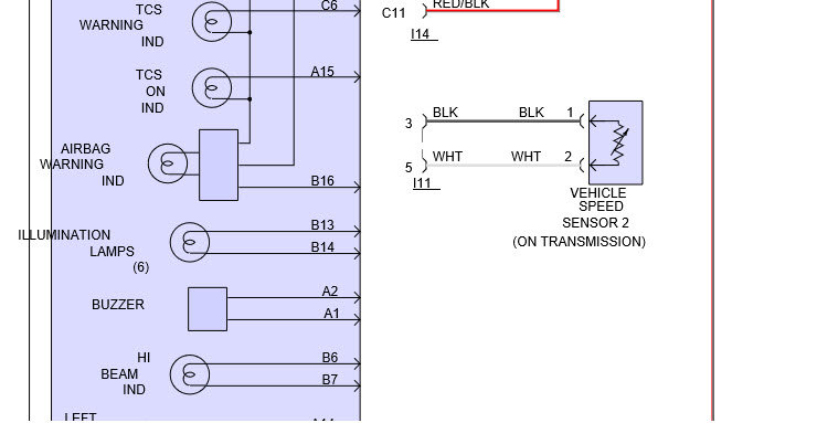

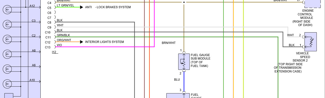

I got a parking sensor that is also a digital speedometer. i need to tap in to the speed sensor wire for the speedometer to work. i need to know the location of the wire. i tried behind the cluster but i do not know what color wire it is. i hope you can help.

we do not have the Liberty model here in US. However, a Forester is a black wire and white wire and runs to c9 and c10 on cluster connector. See picture.

Thanks for your help over in the US the Liberty is called the Legacy over there. i will try the wires. thank you so much for your reply.

Hi ken i have 2 connectors near the speedo 1 with 3 wires and 1 woth about 7 wores which one would have the speed sensor connected too

ok now that I knew it was a legacy it goes to position 3 &5 on connectors which should be marked on plastic. see pic.

Hi HAMC300 just wondering to get the speed signal do you know if i have to connect my wire to both speed signal wires thanks

yes they both have to be connected to where they go in dash.
