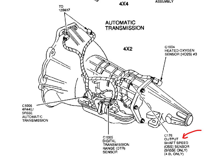

1) My Over Drive O/D does not flash when it goes from 1 gear to 2nd gear.
2) I do not know if connected but my Odometer is not working and Gas gauge all to seem to go out at the same time as the O/D -off (flashing).
Dec 10, 2024 at 9:22 AM
  • 55,433 POSTS

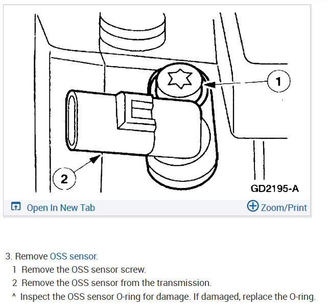

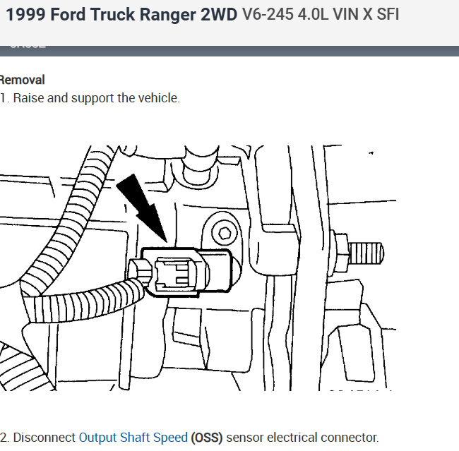

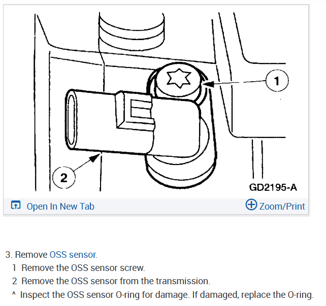

Can I ask if the speedometer is working, if not the VSS (output speed sensor) will need to be replaced here is the location of the part so you can swap it out.
It would help if you ran the codes to see which ones are stored to help confirm the issue.
Clear the codes once the repair is completed. Check out the images (below). Please let us know what happens.
