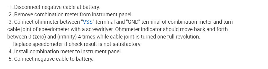

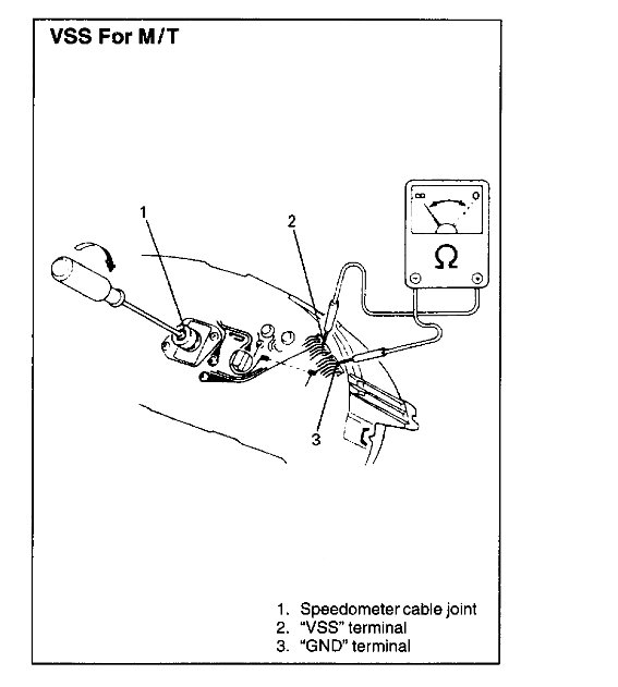

I cannot locate the speed sensor, can you send me a diagram please so that I can replace it?
Nov 6, 2019 at 6:46 PM
SCGRANTURISMO
  • 4,897 POSTS

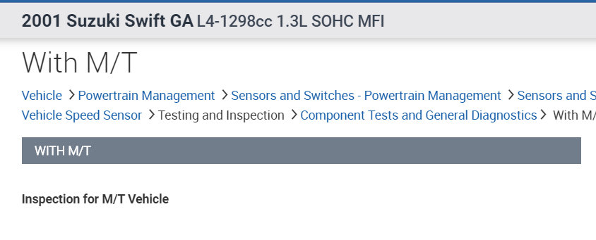

It looks like the Vehicle Speed Sensor [VSS] is located in the combination meter of your vehicle's instrument panel. In the diagrams down below I have included the diagnostic troubleshooting guide from the vehicle manufacturer for the VSS, which includes a diagram of it's location. To run the test, you will need a Digital Multi-meter [DMM], and here is a link below if you are unfamiliar with how to use one:
Please go through this guide and get back to us with how everything turns out.
