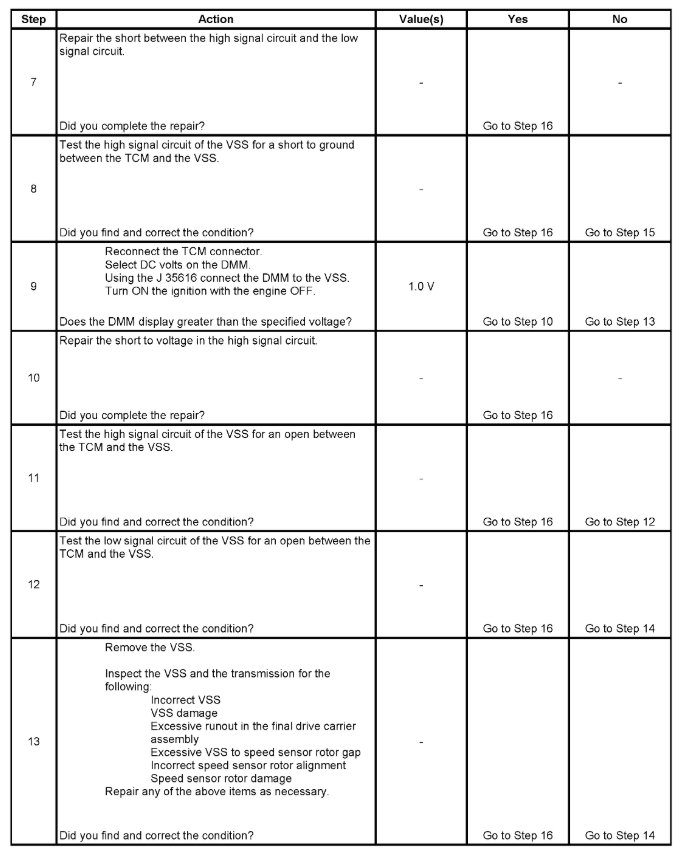

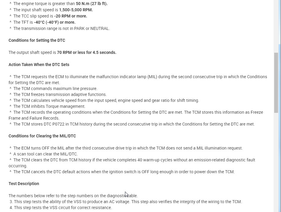

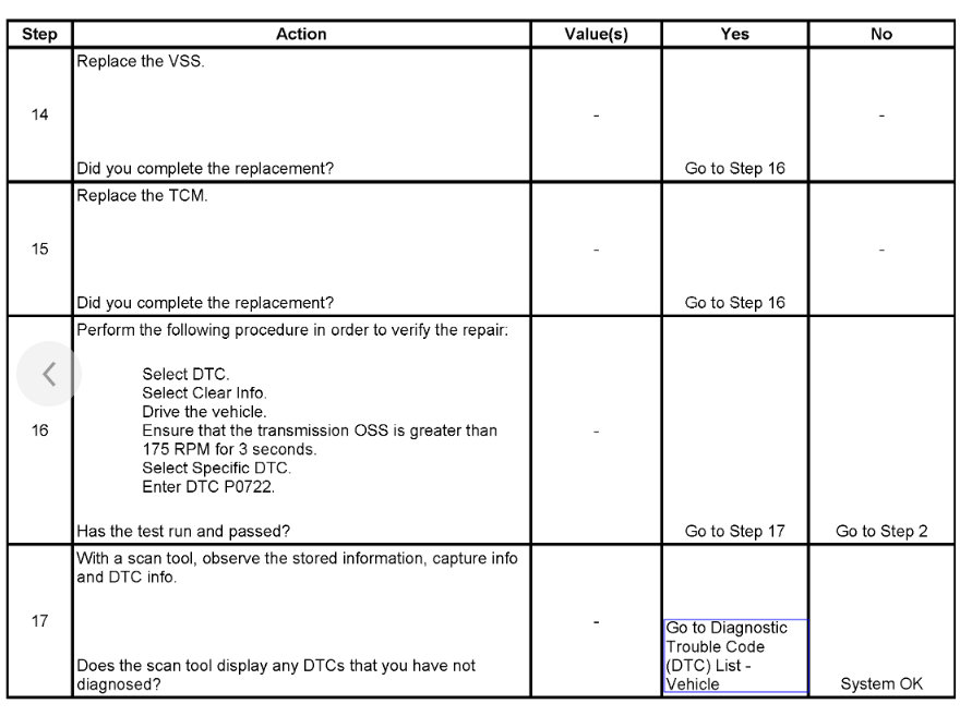

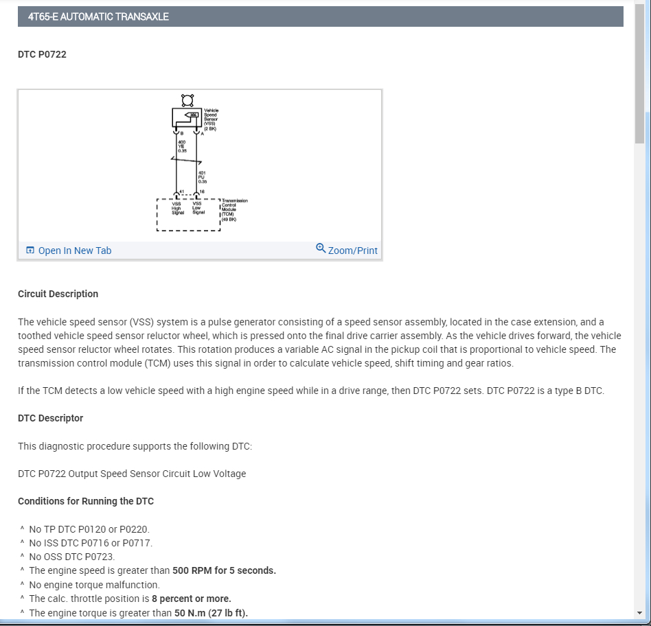

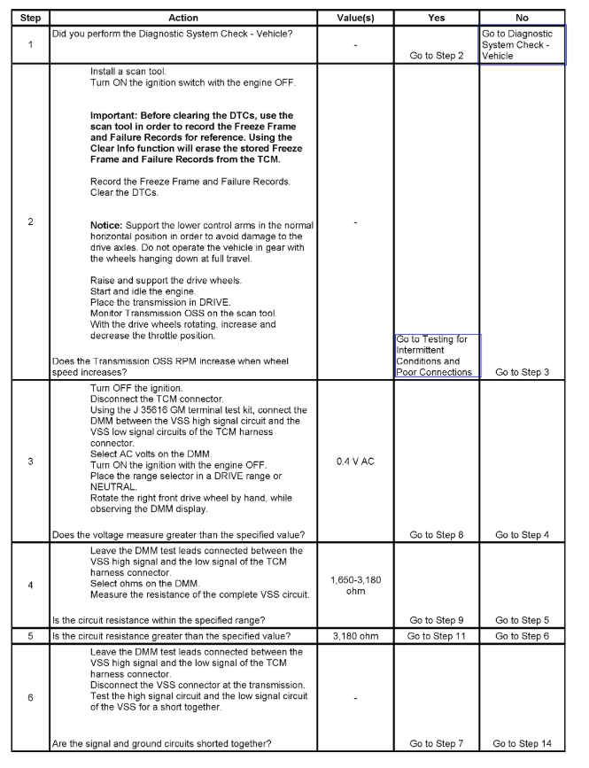

P0700 - TCM Requested the MIL on
P0722 - Output speed sensor circuit voltage low
I attached the testing that needs to be done in order to figure out what the issue may be. Run through this testing and let me know what you find or questions you have. Thanks
