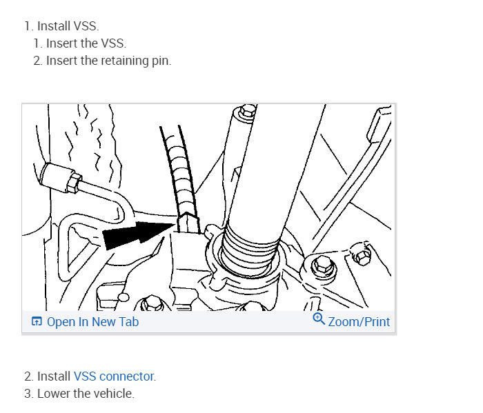

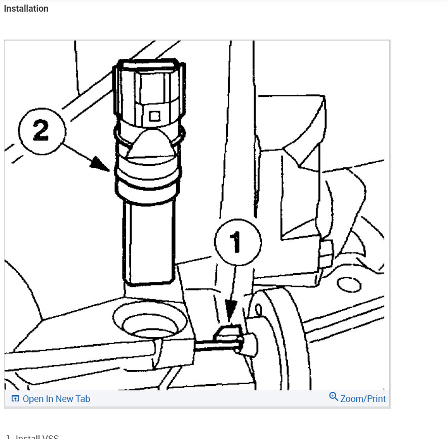

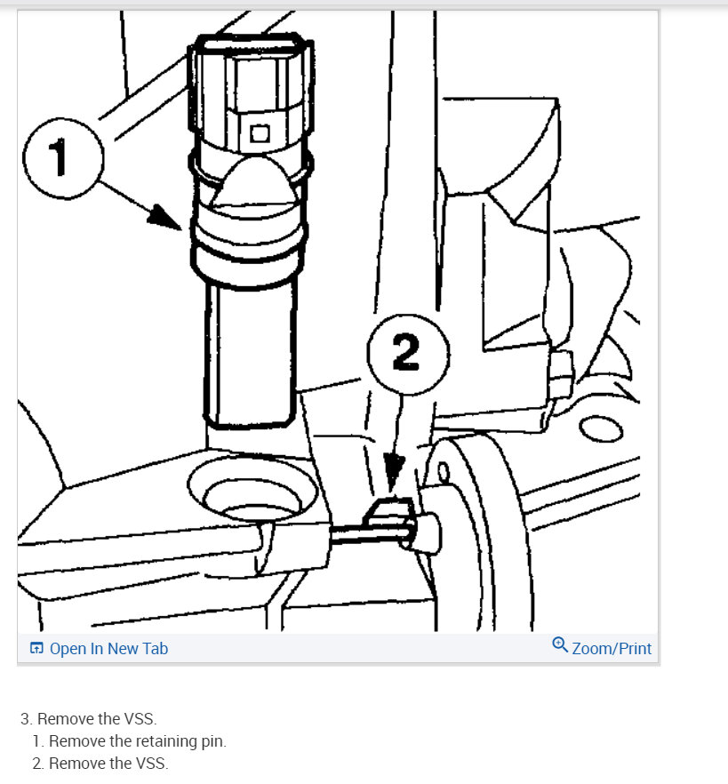

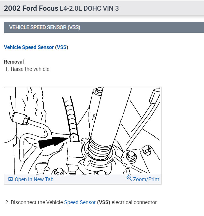

I need to replace the vehicle speed sensor on my car listed above zx5 manual 5-speed. But I cannot find the speed sensor.
Oct 18, 2022 at 5:34 AM
  • 55,569 POSTS
The VSS or vehicle speed sensor is above the passengers die CV axle transmission input shaft. Check out the images (below). Please let us know if you need anything else to get the problem fixed.
