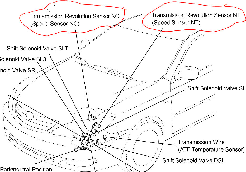

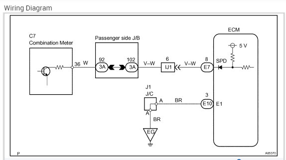

while driving the ABS, brake,, check engine light will come on and speedometer will stop working and transmission will not shift right. i have cleaned the front ABS sensors
and it lasted 1 week and then i had same problem.
i am looking for the locations on the engine for the sensors to replace them one is under the air cleaner and the other one i have found yet. could you give a diagram of the sensor locations? thank you

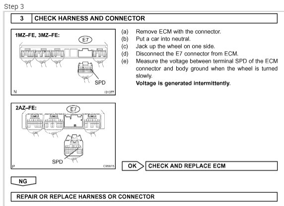

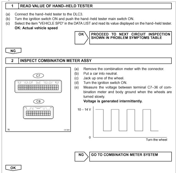

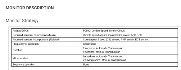

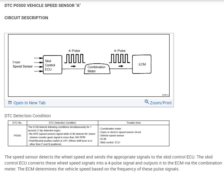

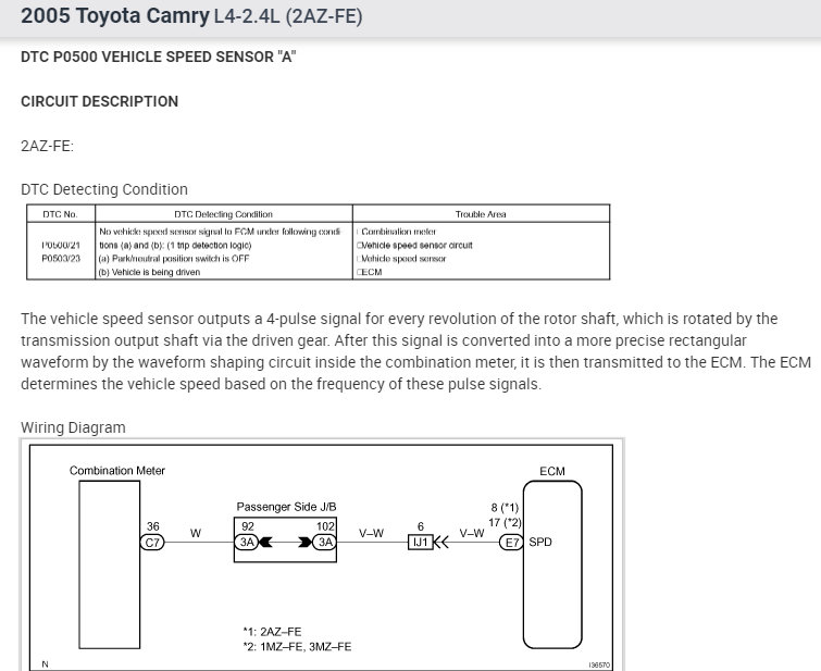

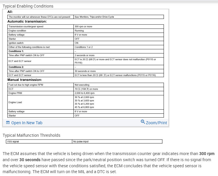

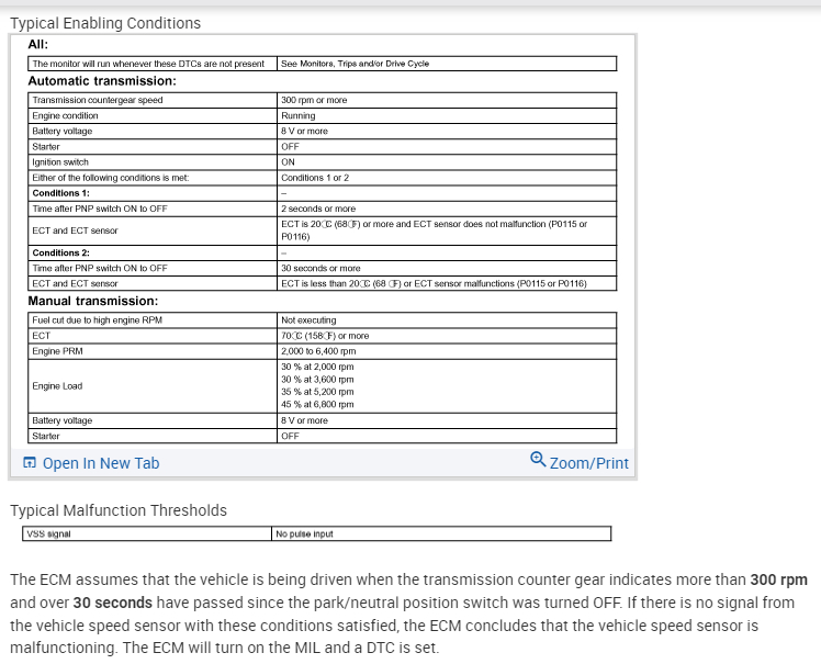

Danny, here is the code: PO500 , Engine is 2.4L , trans auto with OD, ABS.
Dec 1, 2019 at 10:34 PM
DANNY L
  • 5,648 POSTS
Hello again,
I've attached instructions below on how to diagnose the trouble code P0500 for your vehicle. Also attached below is a picture location for your input and output vehicle speed sensors.Hope this helps and thanks again for using 2CarPros.
Danny-
