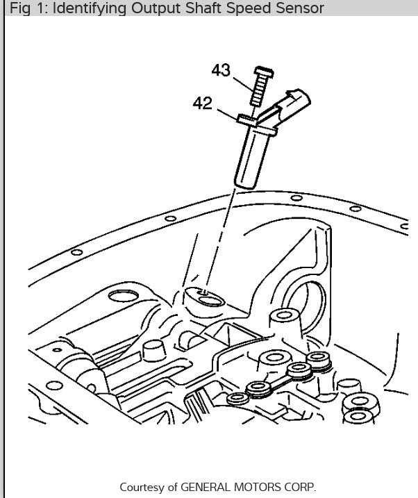

I have to replace the speed sensor on my car. I know it is on the transmission but cannot find it. I have searched the whole transmission. Someone please help! I searched everywhere online for a diagram of the SRX transmission and cannot even find that either. Thank you

you cannot see it because it is in the pan of transmission. the output speed sensor it has to drop the pan and replace it.

Why do you think the speed sensor is the problem?
