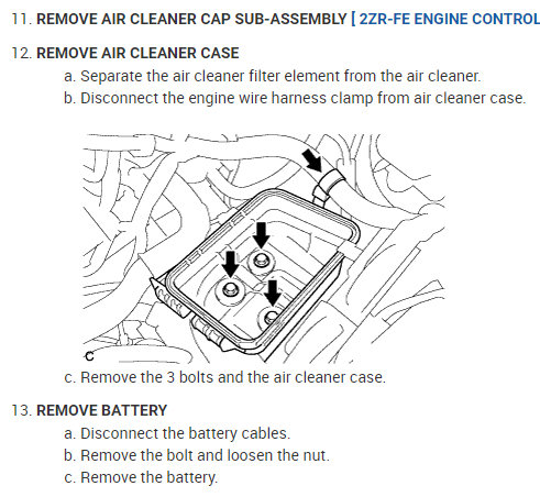

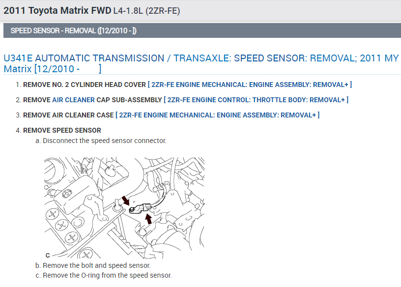

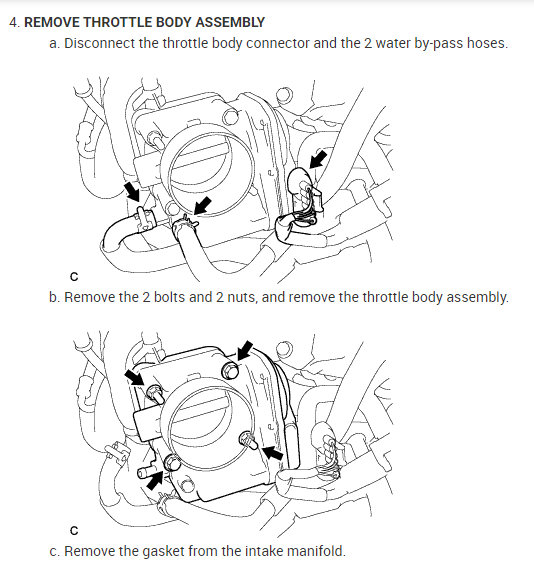

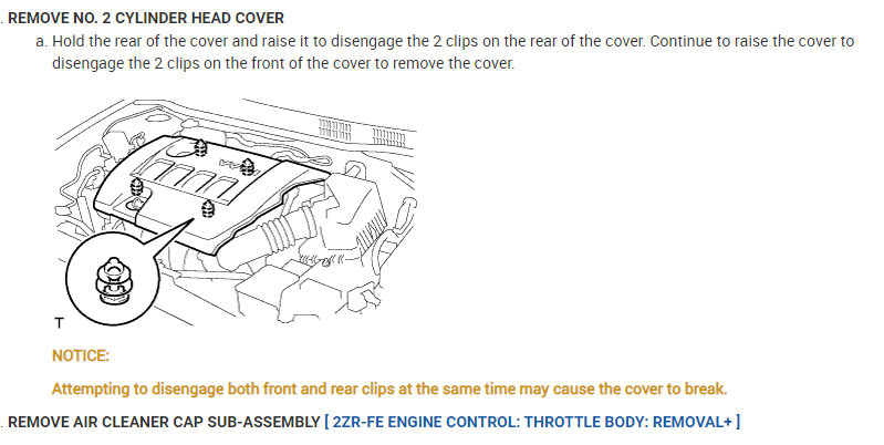

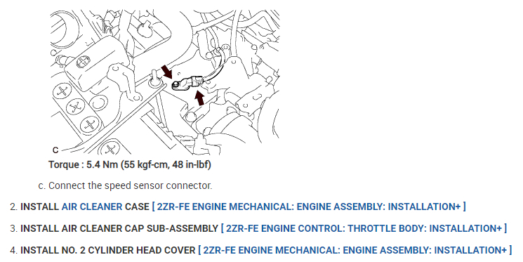

I would like to know where is the input speed sensor and how to replace it. From the top? Under air filter or from underneath.
I cannot find any reference for My specific modèle and year vehicle.

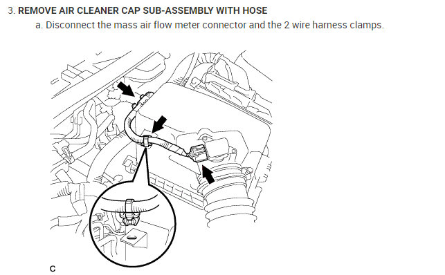

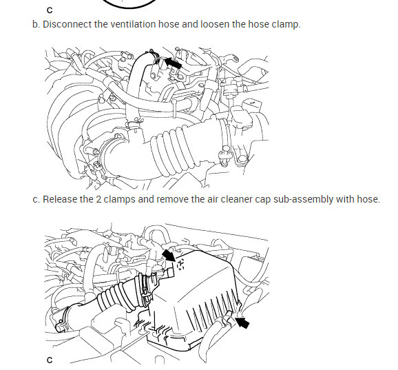

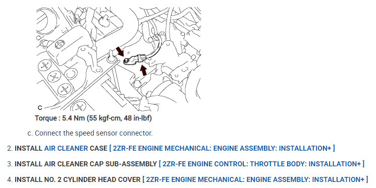

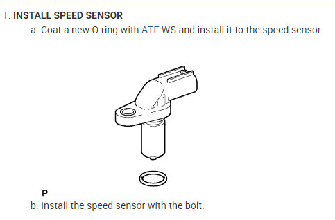

Here is the information you requested. It will best to remove from the top after removing the engine shield, air cleaner assembly, and throttle body. I've attached picture steps below of its location and how to replace on your vehicle. Hope this helps and thanks for using 2CarPros.

Hi Danny, I cannot thank you enough. The information you gave me was just not available on any other medium (blog or YouTube DIY). Your instructions and diagrams where precise and self explanatory. I had no problem to replace the speed sensor on my Matrix 2011. So, a big thank you !
