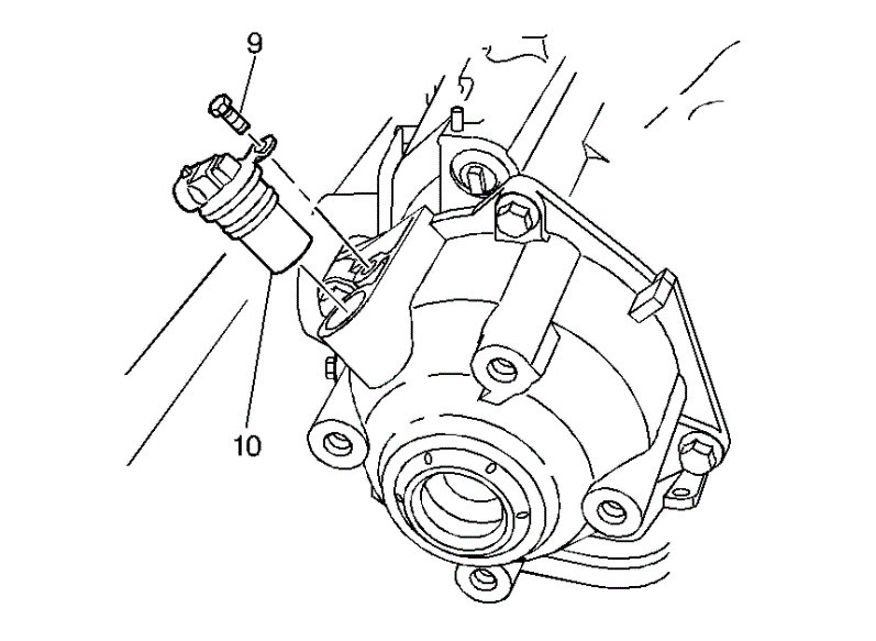

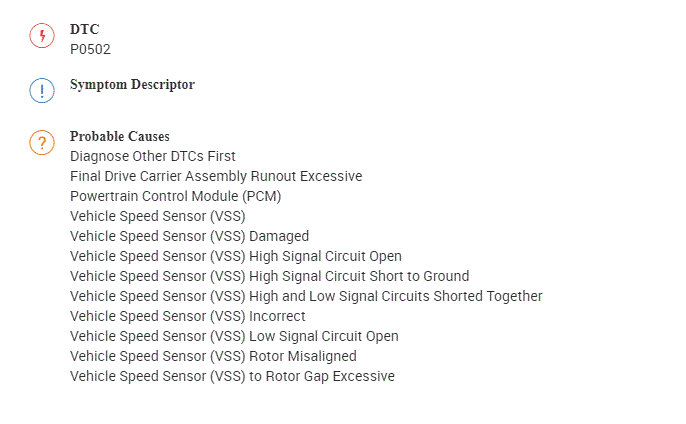

As far as the vehicle speed sensor, there should not be grease on the end at all. just transmission fluid.
1. Position the transmission so that the vehicle speed sensor (10) is facing up.
2. Remove the vehicle speed sensor bolt (9).
3. Important:
Handle the speed sensor carefully.
Remove the vehicle speed sensor (10).

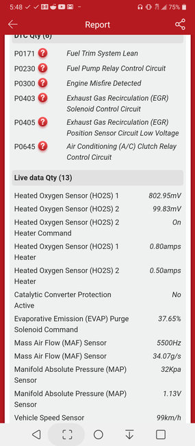

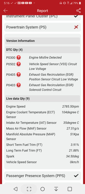

So I have included a picture of the scan report from the tool. Those are the codes I currently have. The VSS codes didn't pop up until I changed it. Now after I saw the mysterious grease I immediately tried my best to clean out the hole that the sensor was in. Didn't seem right at all. Now the mechanic at the shop/dealership said I have a bunch of electrical issues that would cost thousands to fix. However, he said what caused my car to stop originally was an oil leak that dripped to the crank sensor wiring harness. Could that be causing an issue with my speed sensor? Could the mystery grease actually be oil? Then again it's gray so I'm not sure.

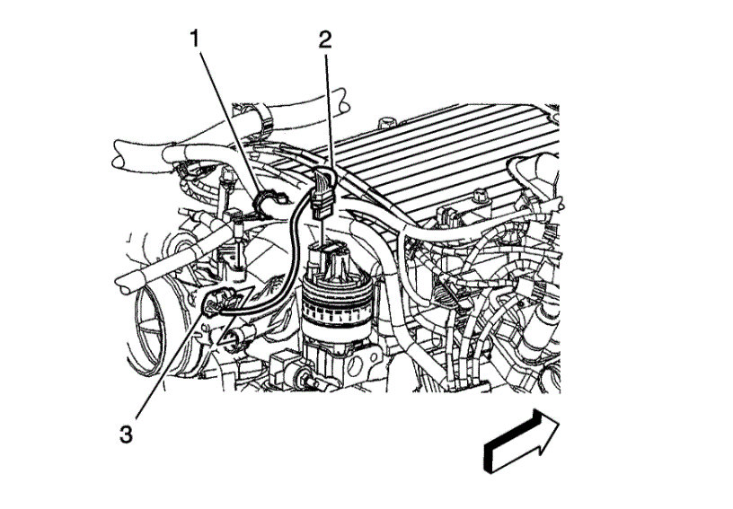

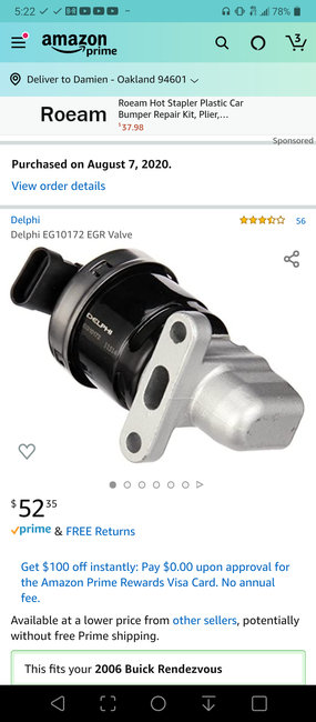

This is the EGR valve I got. Didn't look like the one you got in the picture. If it was set up like that I could plug it in. The old one is set up like this as well but it's taller at the top so I could plug it in correctly.

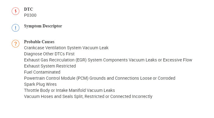

Okay, do you have a scan tool? The long term trim tells me it is running very lean.
You need to start with a fuel pressure test. Low fuel pressure will cause the 171 code as well as the 300 code.
Where is the 171 code you indicated?
You need your scan tool to see if there is a signal from the vehicle speed sensor. Drive the car with the scan tool hooked up and see if you show vehicle speed on the scan tool.

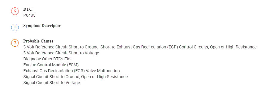

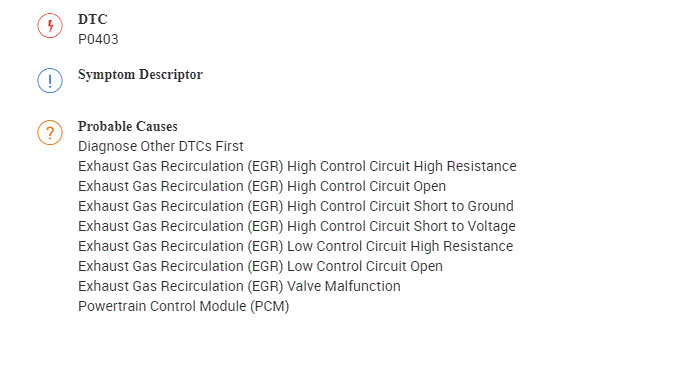

The EGR code is for one of the solenoids and needs to be replaced.

Now this was an earlier one that had other codes on it. Are you saying the EGR valve needs to be replaced? Because the new one caused this code. I'm sure it's because it's not plugged all the way in. Also yes I have a scan tool, that's where I'm getting this info from. I recorded the live data through the app and the speed sensor seems to be running fine. I have not recorded it while the car was malfunctioning though.. only when it was running fine. I have that fancy think diag tool. It's been very helpful.

The plug for the EGR has to be exact as the old one. There a re 2 engines for your car, the 3.5 and 3.6. The valve you listed does not specify and my bet is that it is for the 3.5.

Let me clarify, the sensor wasn't recorded when the speedometer wasn't working. The speedometer works intermittently. When it stops working the car stops going in gear. I don't think the cluster is the issue. I think it's the sensor truthfully. The EGR might be for my truck but it's too short because my connector can't plug in because there isn't enough clearance.

As far as the EGR, it should be exactly the same as the old one. It should not be shorter at all. It sounds like you have the wrong valve.

I would check the actual fuel pressure to be sure. That is the most common failure for the 171 and the 300.

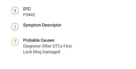

Hello, sorry I been gone for so long. I still have my issue with the code P0171. Now it is accompanied by a P0442 code as well. I haven't been able to do a fuel pressure test yet because I have been extremely busy. A little more info for you though. I changed my fuel pump myself a couple of months ago. I'm not sure if I messed something up or not but I think i did. My car wasn't running when I put the fuel pump in. I thought that was the issue because it wouldn't engage. Turns out, it was the crank sensor. Yay. However the mechanic said my car was running rough. The only thing I did while it was down was change the fuel pump. I had never done it before so maybe I contaminated the fuel? Maybe I didn't tighten it up properly? I'm really not sure. I wish they had video consulting with this...
Nov 8, 2020 at 2:01 AM

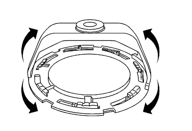

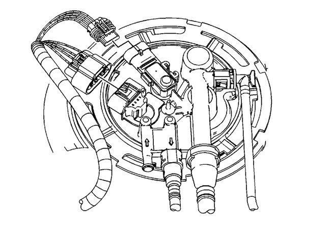

The 442 states the lock ring on the fuel pump module may be leaking. I would recheck your work.
You also need to test the fuel pressure to see if it is correct.

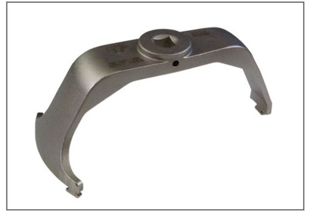

Fuel pump lock ring tool that can be used on GM and Saab vehicles
2009 Suggested user price: Contact AST for pricing
Assenmacher Specialty Tools
1 800 525 2943

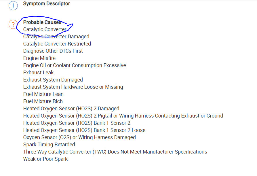

Thank you I will check. however, I did fix my issue of the P0171, turns out one of my bolts was loose on the intake manifold. I tightened it up and those codes are gone but I have a P0420 now.
Nov 13, 2020 at 11:01 PM
TPMPRODUCTIONS
  • 86 POSTS
From what I read, it says I need to change my oxygen sensor. Upstream or downstream.

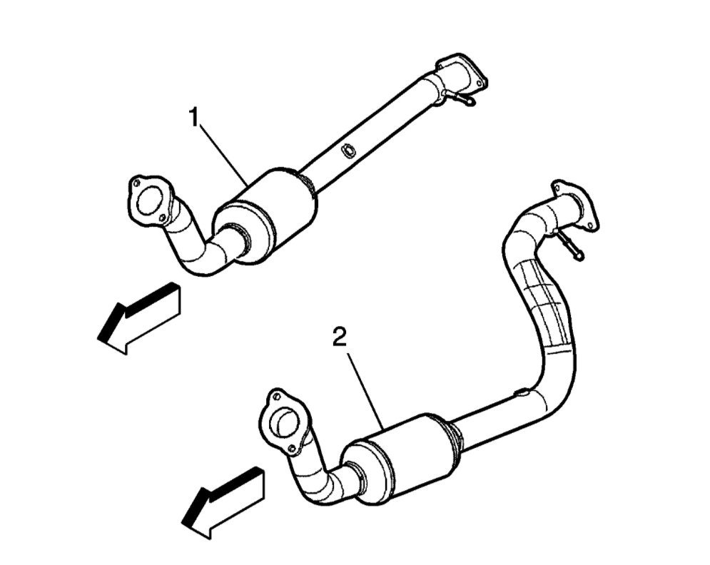

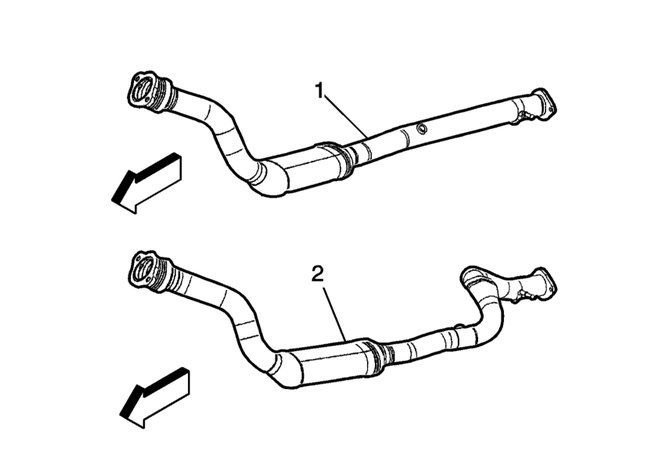

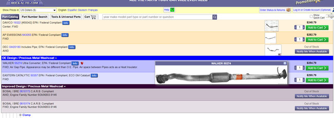

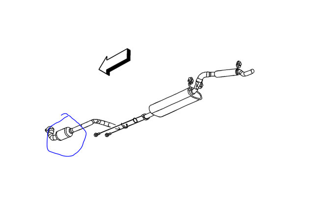

No, the 420 is a catalytic converter efficiency code. The internals are not processing the gases correctly.
The converter needs to be replaced.
I attached the procedure for you below for the replacement and I also posted the part from Rockauto.
If you go with the sensors, the code will keep coming back until you replace the converter.
Catalytic Converter Replacement
Removal Procedure
Notice: To prevent internal damage to the flexible coupling of the catalytic converter assembly, the converter must be supported. The vertical movement at the rear of the catalytic converter assembly must not exceed 6 degrees up or down.
1. Raise and support the vehicle. Refer to Vehicle Lifting.
2. If the vehicle is equipped with All-Wheel-Drive (AWD), remove the propeller shaft.
3. Remove the catalytic converter to exhaust manifold nuts.
4. Remove the heated oxygen sensor (HO2S).
5. Remove the catalytic converter to muffler bolts.
6. Remove and discard the catalytic converter to muffler gasket.
7. If equipped with regular production option (RPO) LX9 and front wheel drive (FWD), remove the catalytic converter (1).
8. If equipped with RPO LX9 and AWD, remove the catalytic converter (2).
9. If equipped with RPO LY7 and FWD, remove the catalytic converter (1).
10. If equipped with RPO LY7 and AWD, remove the catalytic converter (2).
