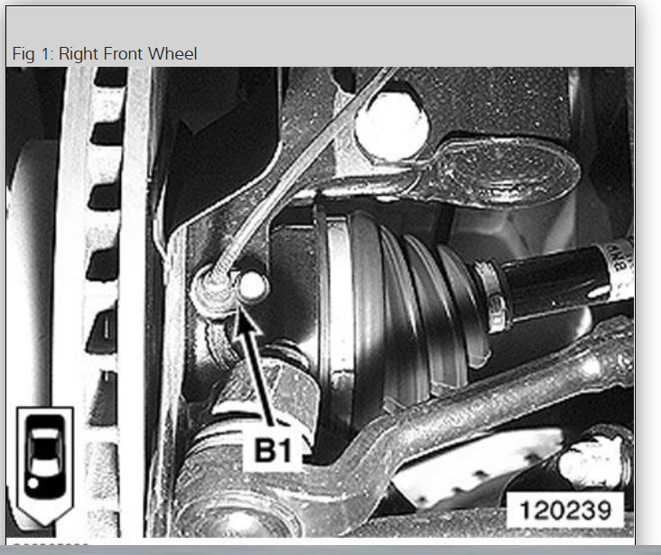

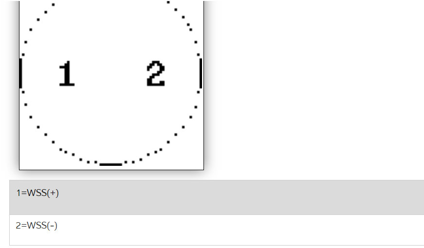

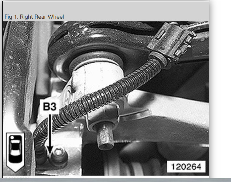

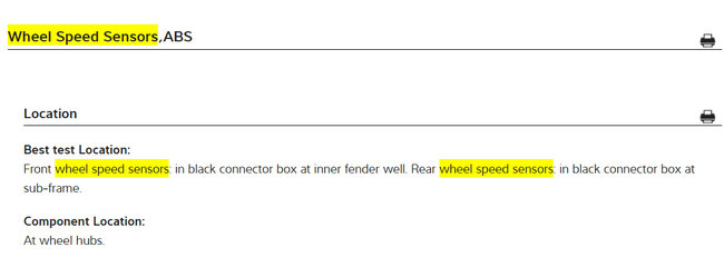

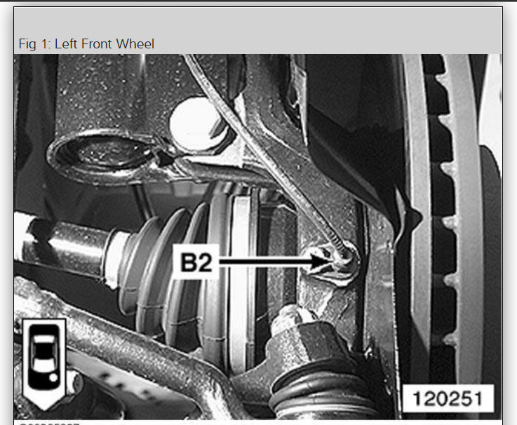

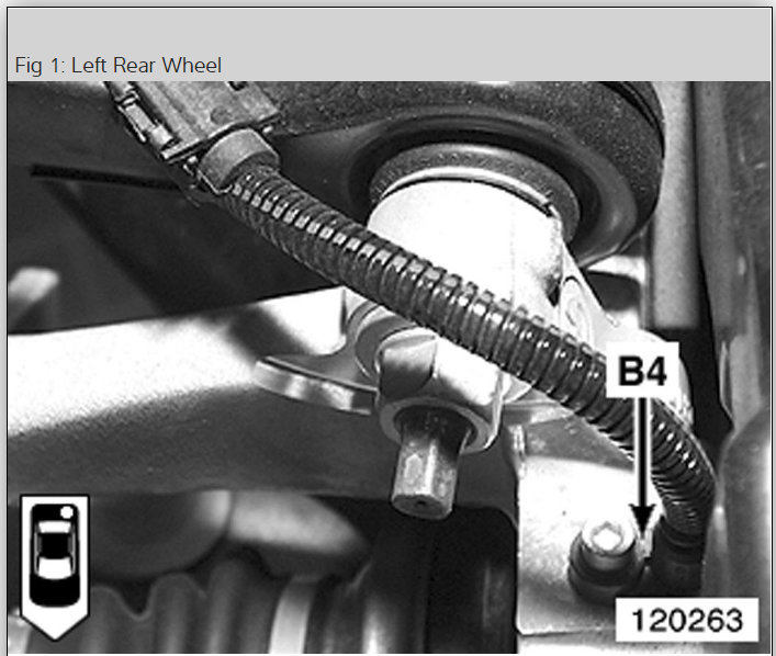

ABS light and brake light on. I ran a code reader and it says speed sensor A is in fault. I replaced all the wheel speed sensors. What is the location of speed sensor A?

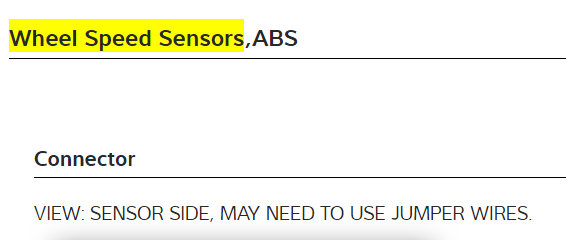

I have included the information that you requested in the diagrams down below. Please feel free to ask should you have any other automotive questions. That is what we are here for. Check out the diagrams (Below). Please let us know if you need anything else to get the problem fixed.
