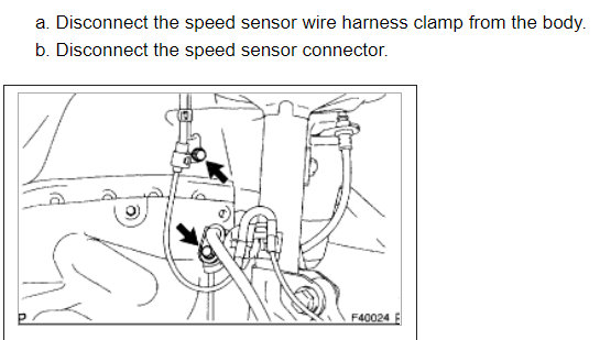

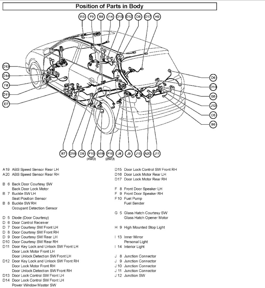

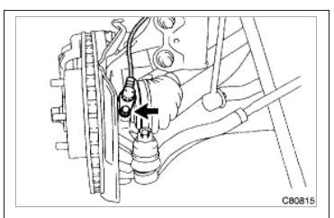

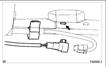

Oh yes, you can fix this yourself. Sensor A is the front left ABS wheel speed sensor I believe.
Here is a guide to help show you how to test the sensor:
https://www.2carpros.com/articles/abs-wheel-speed-sensor-test
This guide you give you an idea of what you are in for when doing the job:
https://www.2carpros.com/articles/how-to-replace-an-abs-wheel-speed-sensor
Here are diagrams to help you do the job on your car.
