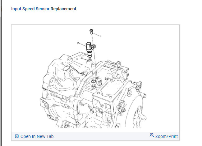

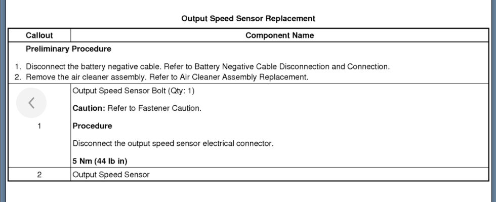

I am replacing a transmission speed sensor and would like to know where it's located via diagram if possible.
Jan 7, 2019 at 12:01 PM
  • CAR REPAIR CONTRIBUTOR

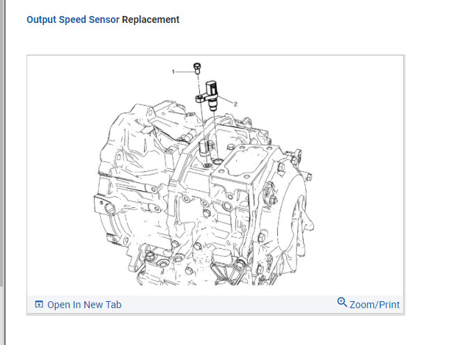

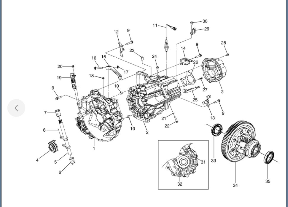

Since this vehicle has a manual transmission you have one sensor. The auto transmission has an input and output.

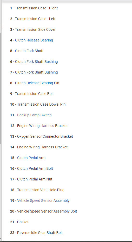

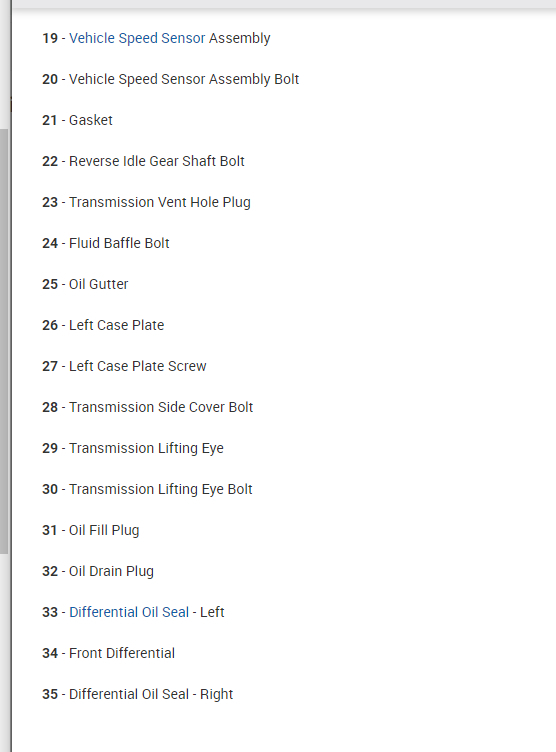

The manual transmission speed sensor is on the case next to the bell housing just above the axle half shaft for the passenger side.

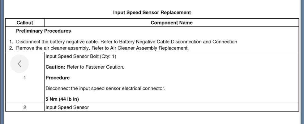

I attached the info for both the manual and auto for your review and anyone else that views this in the future.
Please see the info below and let us know what questions you have. Thanks
