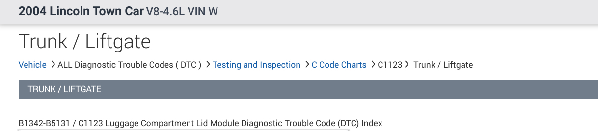

Car above is the Ultimate model. December 30th heading to work car felt like it had no power service engine soon light began to flash as i drove to work. parked the car the light went out never came back on but the car would hesitate from time to time like jerking.Took the car home used my scan tool and got the code C 1123 and B1676 took the car to Carmax Service for service under warranty they claimed that the fuel pump was bad and they replaced it picked the car up heading home the car still doing the same thing took it back to Carmax and told them the car is not fixed left it there they call a few days later saying they found the problem the luggage compartment lid module was going bad and that was the problem and i can pick my car up Monday.

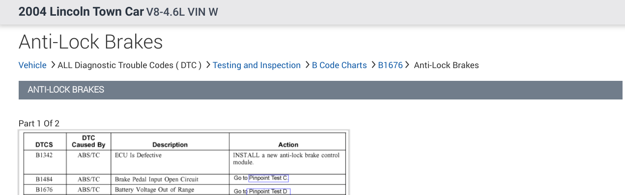

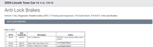

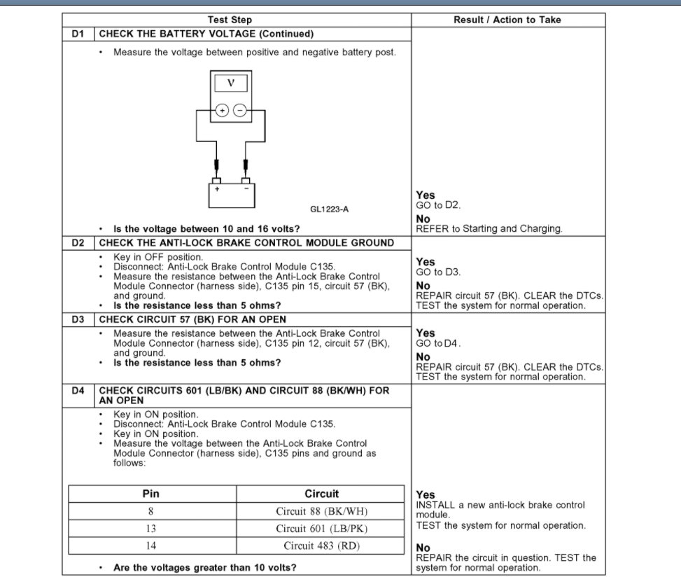

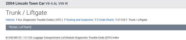

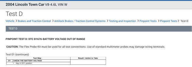

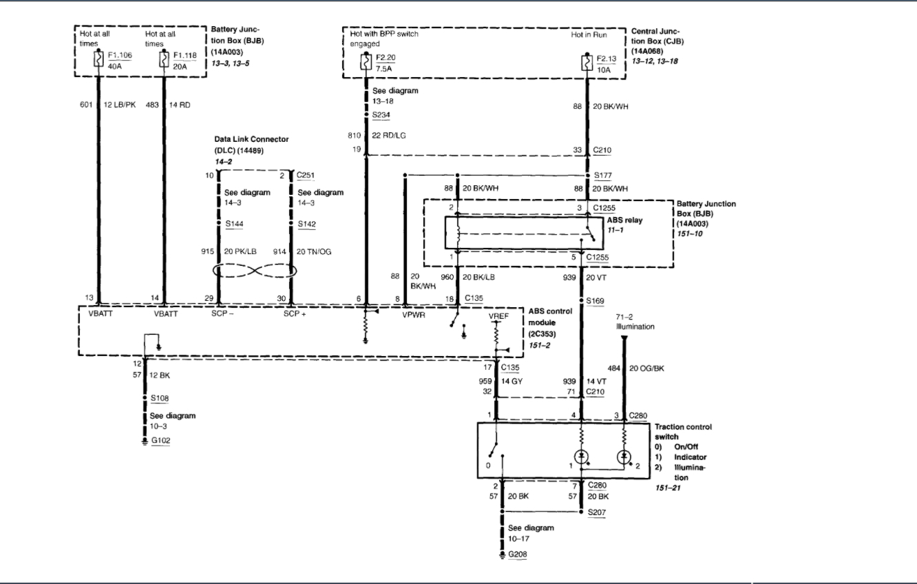

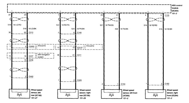

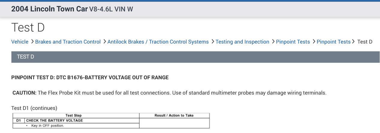

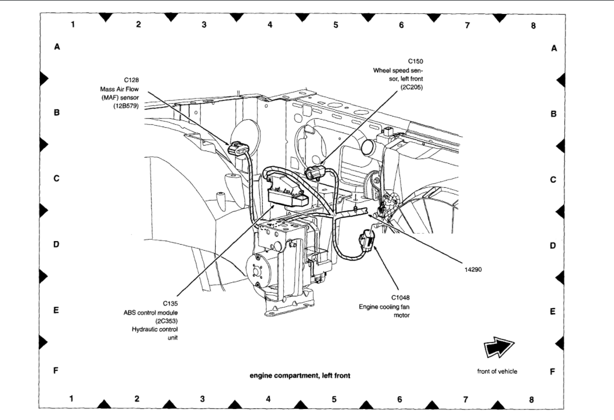

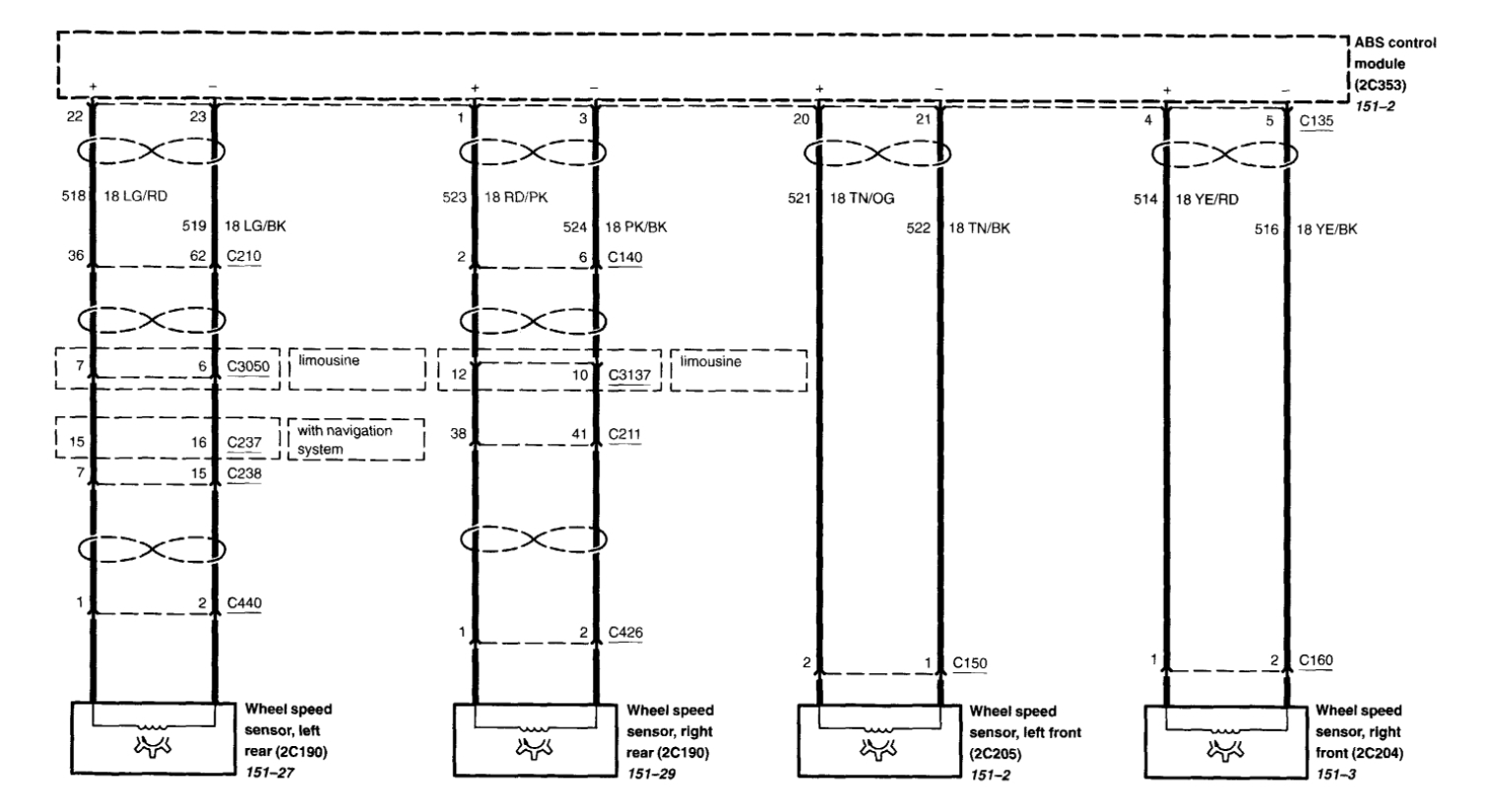

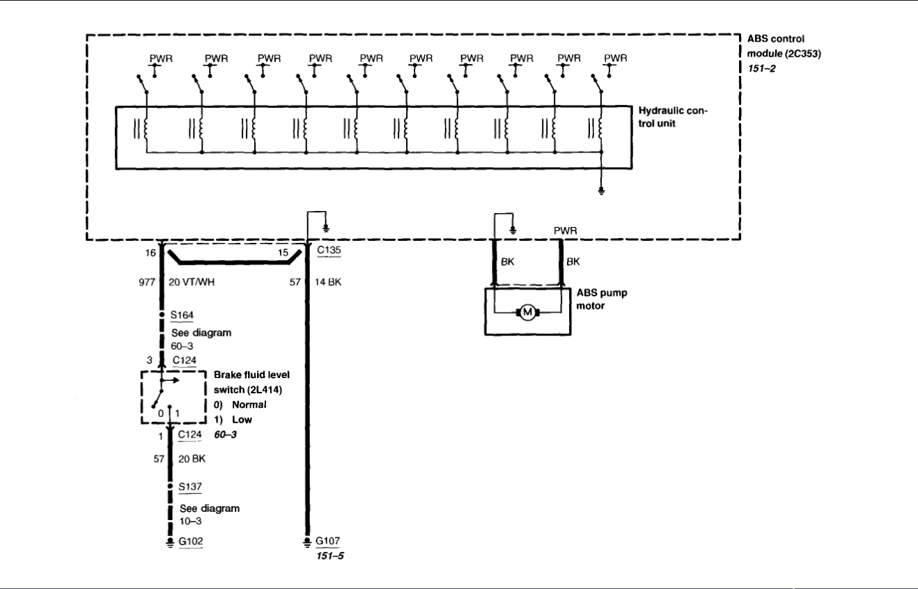

The Direct Trouble Code[DTC] C1123 is indeed a DTC for the Luggage Compartment Lid as CarMax stated. DTC B1676 is a DTC concerning your vehicle's AntiLock Brake Control Module. I have included a diagnostic troubleshooting guide for DTC B1676 from the vehicle manufacturer, as well as ABS Control Module wiring diagrams, a guide on how to find an open in an automotive electrical circuit, as well as how to measure unwanted resistance in an automotive electrical circuit using the voltage drop method in the diagrams down below. You will need to use a Digital Multi-meter [DMM] to go through these guides, so here is a link below to a guide explaining how to a DMM below:
Please go through these guides and report back with what you find.
Thanks,
Alex

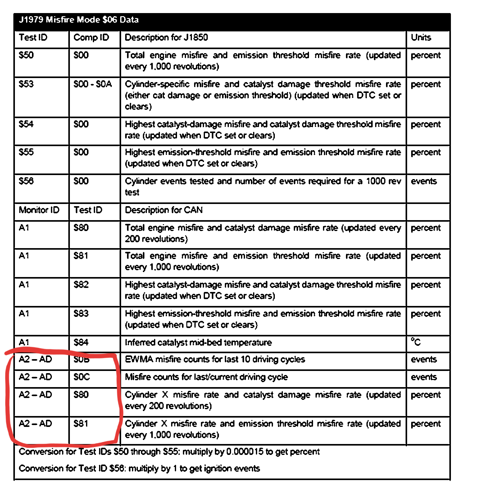

Just to jump in, a flashing check engine light indicates a severe misfire. I am surprised they did not pick up any codes but Ford can be pretty bad about that. Sometimes it will post the misfire code and sometimes it will not.
With an advance scan tool they can go into a different menu and look at mode 6 data and read the misfire data. See image below. A2 would be cylinder 1 and so forth. The cylinder with the highest misfires I would swap that coil with a cylinder with close to no misfires, reset the computer and road test under same condition. If misfire follows where you moved it for example A2 cylinder one and A4 cylinder three then the coil is faulty. If no change then move around the spark plugs and fuel injectors.
Those are just examples but you need someone that really knows how to read and interpret that data and that is more of an advance level specialist to get in there. Those are my thoughts with the flashing check engine light.
