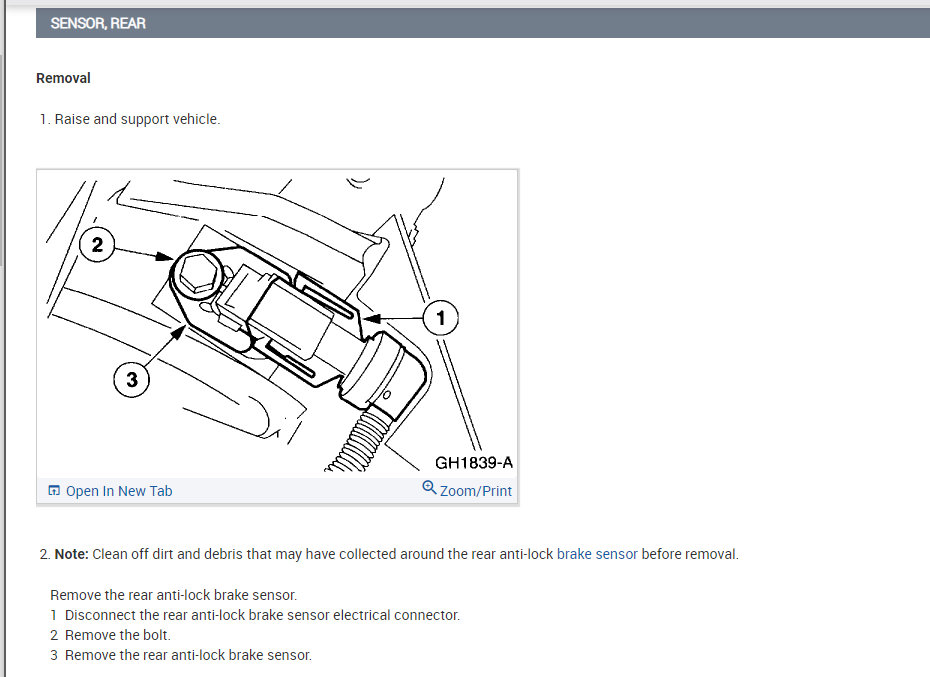

Vehicle speed sensor location I don't know where to find it?
2000 FORD RANGER
111,965 MILES • 4.0L • 6 CYL • 4WD • AUTOMATIC
CAROLYNNEL2
  • 6 POSTS
I don't know where to find it. It's not the one on the rear axle.
Mar 26, 2019 at 12:39 AM
Here are some guides that will help with testing and replacing speed sensors in case you need this info as well:
https://www.2carpros.com/articles/abs-wheel-speed-sensor-test
https://www.2carpros.com/articles/how-to-replace-an-abs-wheel-speed-sensor

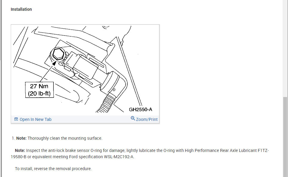

The reason you are having an issue finding it is because Ford only used one rear sensor in the rear differential on these trucks.
I attached the process below from the manual. Please run through this material and let us know if you have other questions. Thanks
