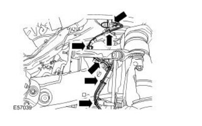

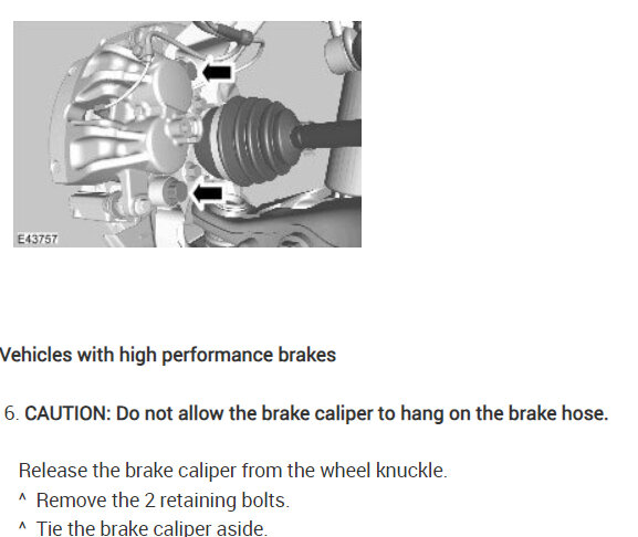

I have a 2006 Land Rover Sport. My ABS light has come on. The speedometer does not work. Nor does the mileage reader. This is how the car has been since I bought it about a week ago. I ran codes and it threw the code C0013. I looked this code up and it said that my left-front speed sensor had a fault. I was wondering if I should just buy that one sensor, buy both front sensors, or buy all four sensors for the front and the back.
Oct 10, 2024 at 3:54 PM
  • 55,399 POSTS
We only deal with one problem per thread, please make new threads for both of your other problems.

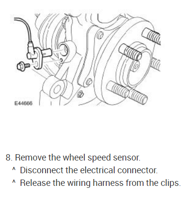

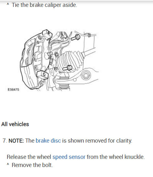

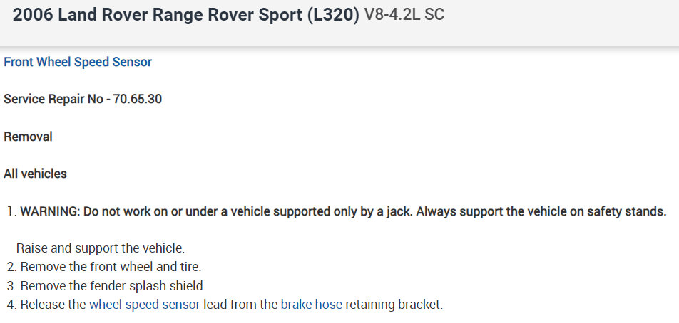

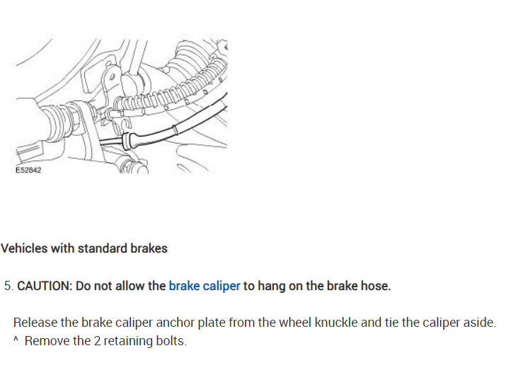

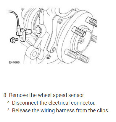

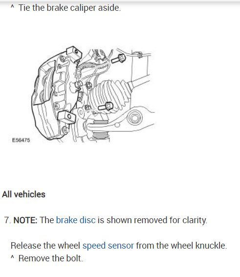

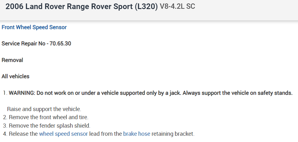

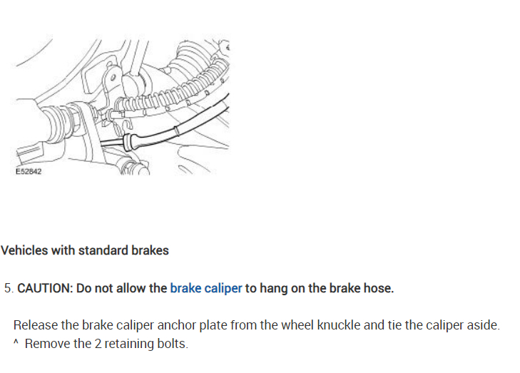

Yes, I would replace the felt front wheel speed sensor which should fix it. Here is how to replace the wheel speed sensor in the images below, you will need to clear the codes once completed.
Check out the images (below). Let us know how it goes.
