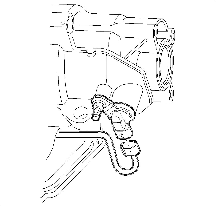

Having problems with my transmission. Rough shifting and speedometer fluctuations. I've changed the speed sensor on my car multiple times. It works fine for a week or two, and starts to act up again, little by little. It's only showing codes for an oxygen sensor and a wheel speed sensor. Nothing related to transmission at all. Any help at all would be appreciated. It's driving me insane. Thank you.

As far as the problem, have you inspected the wiring and the connector? I am going to provide the directions for VSS replacement. I need you to confirm this is what was done and take a look to see if anything was done differently.
__________________________
Vehicle Speed Sensor Replacement
Removal and Replacement 4T45-E - Automatic Transaxle Vehicle Speed Sensor
VEHICLE SPEED SENSOR REPLACEMENT
Removal Procedure
pic 1
Caution: Ensure that the vehicle is properly supported and squarely positioned. To help avoid personal injury when a vehicle is on a hoist, provide additional support for the vehicle on the opposite end from which the components are being removed.
1. Position the vehicle on a hoist and raise the vehicle. Refer to Lifting and Jacking the Vehicle .
2. Disconnect the vehicle speed sensor (VSS) electrical connector.
3. Remove the VSS electrical harness retainer from the VSS stud.
4. Remove the VSS stud.
5. Remove the output VSS from the transmission case.
Important: Inspect the O-ring for damage and replace if necessary.
6. Remove the O-ring from the VSS.

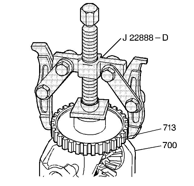

Installation Procedure
pic 2
1. Install the O-ring onto the VSS.
2. Install the output VSS into the transmission case.
Notice: Refer to Fastener Notice .
3. Install the VSS stud.
Tighten the stud to 11 N.m (8 lb ft).
4. Install the VSS electrical harness retainer to the VSS stud.
5. Connect the VSS electrical connector.
6. Lower the vehicle.
If everything is correct, can you provide the code you are getting so I can identify possible causes?
