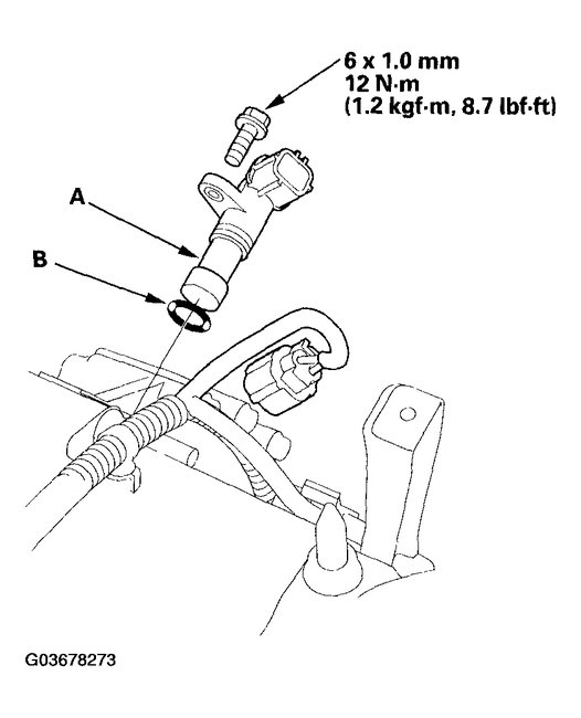

The part you replaced in your video on a Element, I cannot seem to find that same part. Transmission speed sensor replacement Honda Element 2003-2011.

picture of the speed sensor. does this help?

I had the same problem! In the video they are replacing the transmission pressure sensor, not the speed sensor. Need correct video with correct part. Great video, wrong part.
