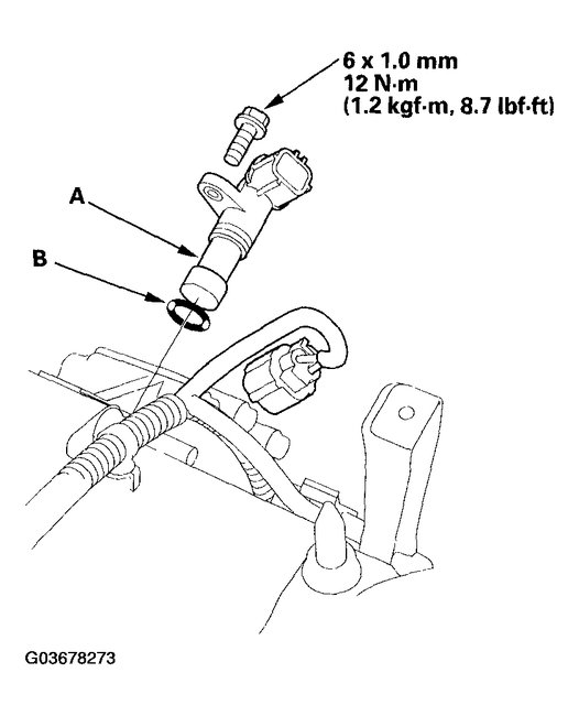

The part you replaced in your video on a Element, I cannot seem to find that same part. Transmission speed sensor replacement Honda Element 2003-2011.
Oct 24, 2017 at 10:10 PM
MHPAUTOS
  • 31,937 POSTS

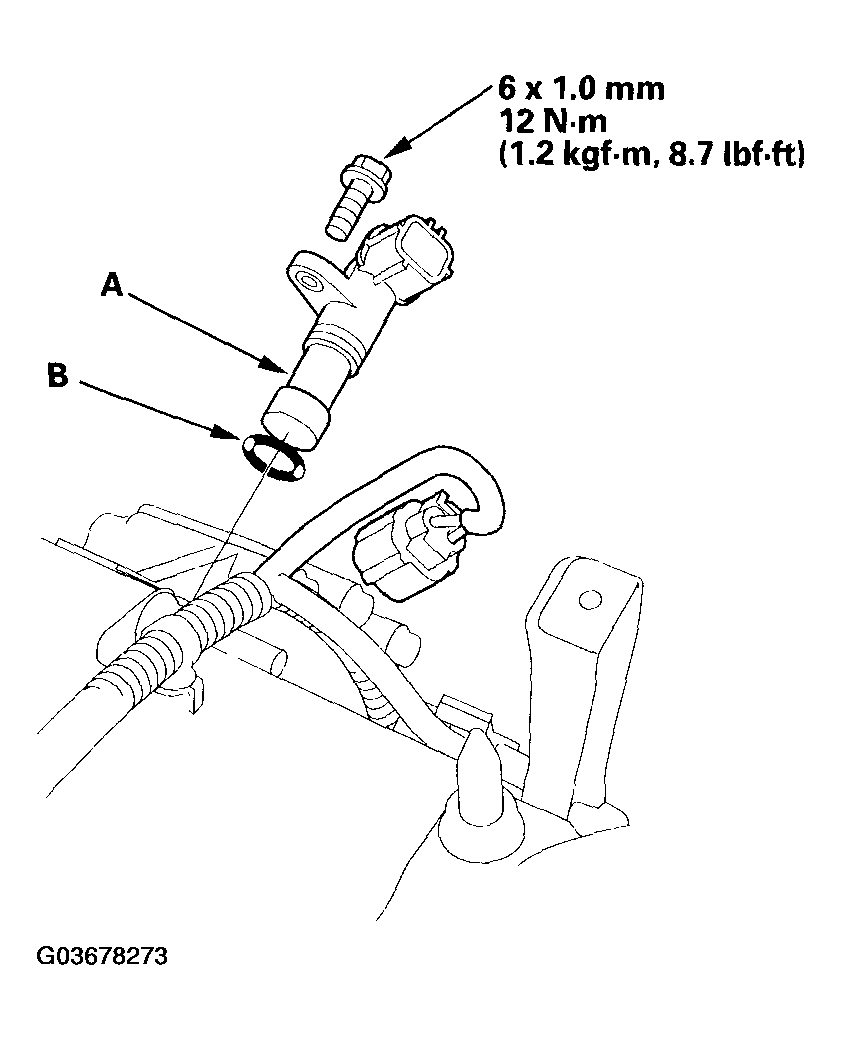

picture of the speed sensor. does this help?
Oct 25, 2017 at 9:30 AM
JEN TROGE
I had the same problem! In the video they are replacing the transmission pressure sensor, not the speed sensor. Need correct video with correct part. Great video, wrong part.
